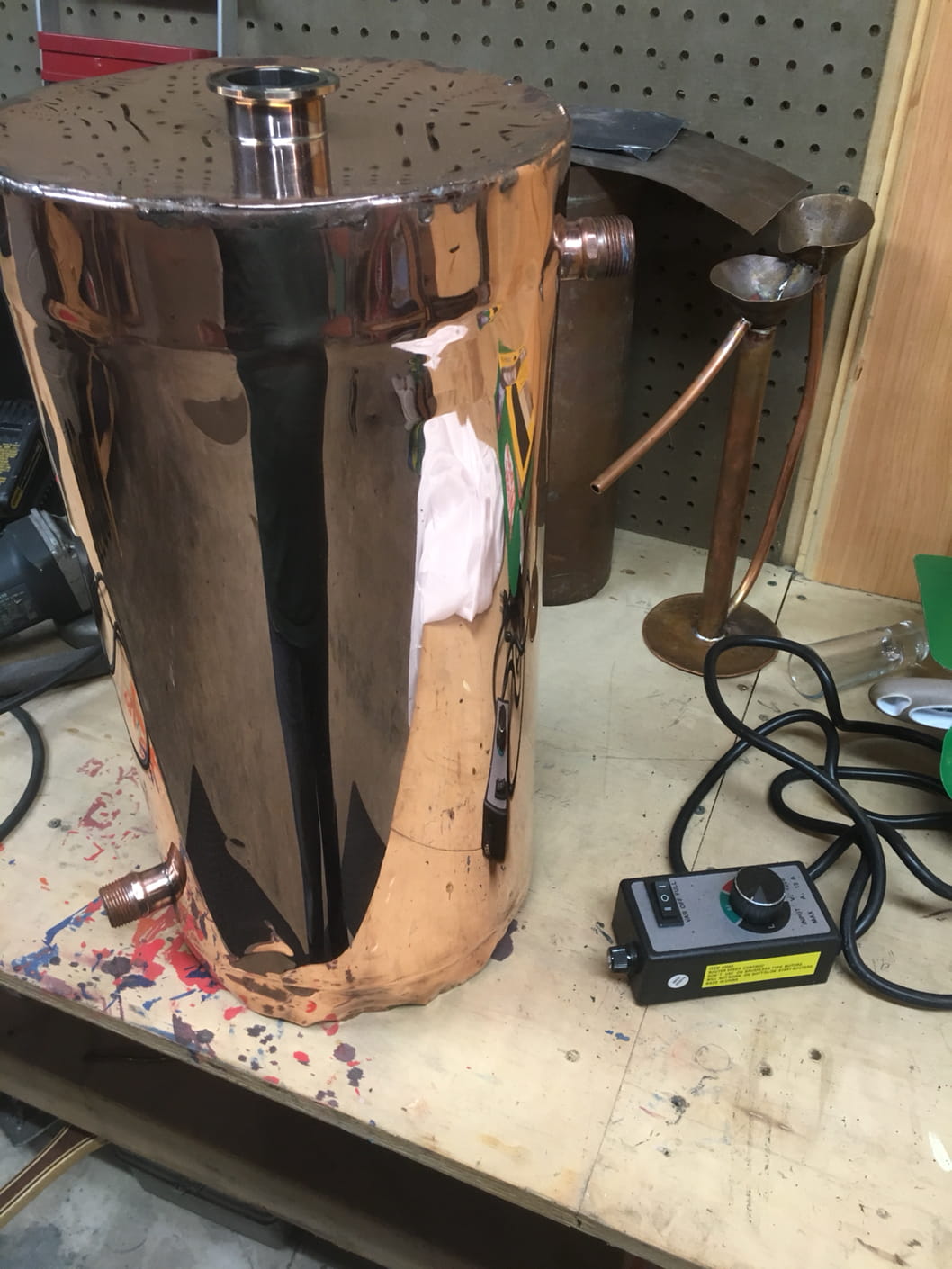

Just wanted to see if anyone else uses one like this. It’s just and over sized shotgun condenser or something like a reflux condenser on a column. It’s 9” diameter but only 15” long tubes. Any other “Gatling gun” condensers out there?

I think I've seen you post a picture of this a week ago but I forgot what the post was about. To me it looks like a jacketed condenser with a ridiculously large jacket.

Lots of us use shot gun condensers .... but really they probably should be called gattling gun condensers. Not that I know shit from clay when it comes to guns but all the shotty’s I’ve ever seen have more than two barrels .
Have to say , yours looks a beast
Have you run it yet ? Man that things probably capable of 50 liters an hour easy .
Wondering how many barrels you have in it ?
Looks like 2” going in . How much expansion room is there from the input to where the actual condenser starts ? ... an inch or two ?
Love to see a scale diagram of the internals .

The internal aren’t complex at all, just a jacketed condenser. Has 16, 3/4” copper tubes inside. About 2 inches of expansion room on top with a 1 1/2” tri clamp inlet. It is wide open on the bottom and just sits on a funnel for collection. I’ll try to get a diagram draw up. The body and caps are 20oz copper sheet.
Yes I have run it but I haven’t really pushed it to see what it can do yet. 50 liters might be possible, sounds like a lot, but I’ll probably never find out. That would dry my boiler out pretty quickly.

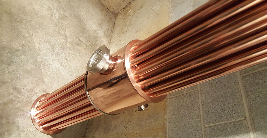

Here's a picture of one of the 12 inch gatling gun coolers we are building. These go on our iStills 5000.
Regards, Odin.
Regards, Odin.

Wow Odin, looks great but must take a pretty big water flow to cool all those pipes? Are those 1/2” pipes?

10 mm pipes only. Runs on normal tap water. One inlet, one outlet.Bushman wrote:Wow Odin, looks great but must take a pretty big water flow to cool all those pipes? Are those 1/2” pipes?
Regards, Odin.

Looks like the pipes - instead of one pipe - create a bigger cooling area, so more reflux and slightly higher abv better separation at the cost of some efficiencies. Is that piece in the middle used to induce reflux? A sorta dephlag?Twisted Brick wrote:I'm intrigued by the performance of the smaller diameter gatling risers and how they are tuned to control reflux. I wonder if any other distilleries are running this configuration?RunRufusRun wrote:
Henry there at Gatling still works has some pretty cool stuff, looks like those reflux condensers are air cooled? Seems hard to control, I’m probably missing something. I’ll have to look into that a little more, I’m not very educated on column still design.
Odin.

Yes I think thats more or less spot on Odin.
