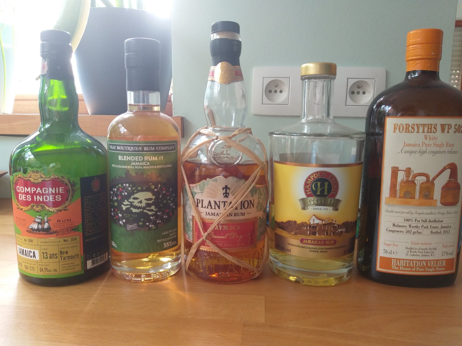

I've tried this previously using approximately the same ratio from cocktail wonk website.
You could definitely smell a difference in the wash, it went from a light vinegar to a more earthy nose. But the yeast stalled as I hadn't maintained the ph level and it had dropped to around 3.8. I was using Bi-Carb to raise the Ph and it did help re-start the yeast but I think it takes too much Bi-Carb to raise the level a small amount and you can taste it, so I will give lime a try!
This was using the acetic acid I made from muscavado sugar and a wild yeast/bacteria culture from Barbados.
I also took a few swabs from Mount Gay fermentation tanks that they use for wild fermentation and using an agar plate to culture the beasties
I might be out of my league but won't hurt to try haha[img]https://uploads.tapatalk-cdn.com/201806 ... d9cce2.jpg[/img][img]https://uploads.tapatalk-cdn.com/201806 ... f11764.jpg[/img][img]https://uploads.tapatalk-cdn.com/201806 ... 5053c7.jpg[/img][img]https://uploads.tapatalk-cdn.com/201806 ... afab9c.jpg[/img]

at least I am not able to see your pics. I think only tapatalk user are able to see them. It sounds interesting what you write. Perhaps you could upload the pics on hd?

It may be that the file size is too large as they were taken using my mobile phone and it's camera. I will upload them to the site later when I have access to my computer.
I spoke to Richard Seale at Foursquare as well who told me they fill the 1st thumper with "high wines" which is the 1st tales and the 2nd with "low" wines which is the later tales. I think the cut off between high and low tales is around 40-50% alcohol mark.
