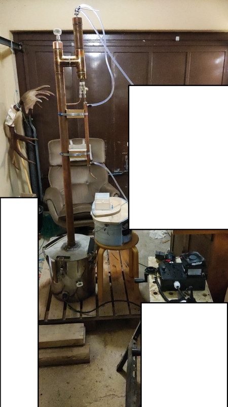

The build:
Tried to be as picky as possible when choosing the materials, only using copper, stainless steel, and alot of PTFE tape. The boiler is a 30 liter stainless steel boiler with clamps and a gasket, judging from my conversation with the online seller I think it was originally designed for distillation but it was sold as a "stainless steel fermenter". I originally used a 2kW hot plate to heat it but it was a pain in the ass to control due to cycling so I retired it and slapped a 3.5kW heating element on that bad boy and we were in business.
I somehow managed to break the lid to the boiler so I had to source a new one, but it was a blessing in disguise because of how much sturdier the whole still got from changing a 1mm thick lid to a 3mm thick lid, who would have thought. The new lid weighs a ton though.
The column is 54/50 mm copper pipe, with some tee-fittings and other parts. Decided to go for the Nixon-stone design and also putting another needle valve on the reflux tube. So I'm running 2 needle valves to control everything along with the power regulator for the heating element and cold tap water for the condenser and heat exchanger. The condenser managed the hot plate with ease but the increased power from the heating element was too much when on 100% power so I need to turn the power down a bit sooner next run. There's a hole between the inlet and outlet of the condenser to keep it from building up pressure. The heat exchanger on the end worked great and I was collecting at 11.5 C (52.7 F). Both the vapor and boiler thermometers use 6mm thermowells.
Suitable packing for the column was almost impossible to find so I bought the thickest welding cable I could find, stripped it and unwinded all the cables into a copper mesh. Seems to be working just fine.
Building this was my first time ever soldering copper pipes. The joints look like crap but they're tight and I checked the joints from the inside using a camera on a wire so they're clean on the inside.

Here's a picture of the still, don't look too closely on my soldering and sorry for the editing, realised I had some personal stuff (and friends) lying around on the picture.
