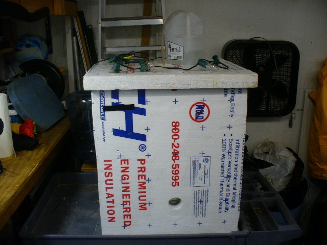

Re: EC-1118 vs. Bakers Yeast
BrewinBrian44 wrote: ↑Fri Apr 22, 2022 7:38 pm Summer= Bakers or DADY
Winter= US-05
Ambient temps align with this. Unless you have some sort of temperature control. I wish I could fit my 50gal kettle in a chest freezer!
Build one yourself from 2" foam insulation that comes in 4' x 8' sheets.
Mine is a little smaller, but so what, build it to fit.
I wish mine had just a little more room inside.
