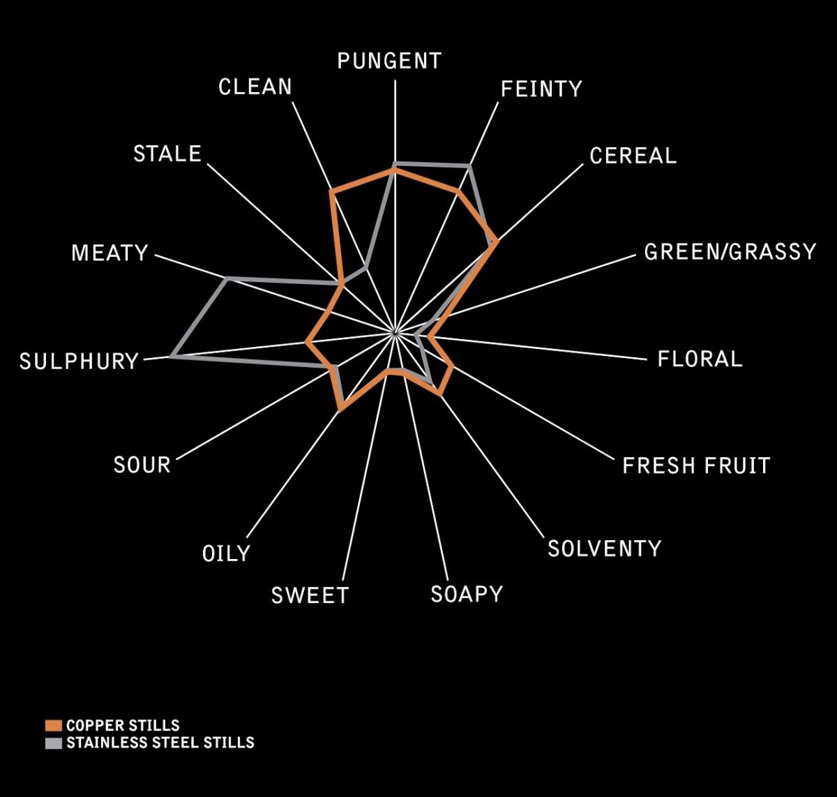

Hi Yummy, I sincerely respect your posts, and appreciate advice you and others have given. This black copper = copper sulfide comment comes up a lot, so I’m not singling this post out, it just happens to be the one to pop this question out from me for you or anyone else.
I heard this repeated a lot by many on this board to the point I stressed a while to get copper into the vapor path of my stainless steel still which of course turned black. Long story short, I thought wow I’ve never had a sulfer problem in my fermentations, why now? So I researched a bit which led me to think that it was copper oxide not copper sulfide. I believe it’s hard to tell them apart visually. So the question, what makes everyone sure this black is copper sulfide over copper oxide?
I did find an interesting chart while research this back then (sorry, I don’t know what site to credit) on the aroma impacts of stainless versus copper.
I pondered this for awhile. Some thoughts:
- with copper you trade a little solventy smell for a nice tradeoff in meaty and suphery which seem unwanted
- you get a little boost in floral and fruit with copper and ss may do something “feinty” which I don’t know how that is different from solventy
- WTH is up with “clean”? Could it be copper cleaning up all those unwanted chemicals or is some small amount of copper leaching causing it (fresh copper is “clean” smelling to me)
Anyway, seems to fit the conversation so hopefully not straying to far off topic.
Edit: I found the source of the photo: https://www.deviantdistillery.com/2019/ ... it-stills/
That’s it. No more reading!

Dougmatt wrote: ↑Wed Oct 05, 2022 6:10 pmHi Yummy, I sincerely respect your posts, and appreciate advice you and others have given. This black copper = copper sulfide comment comes up a lot, so I’m not singling this post out, it just happens to be the one to pop this question out from me for you or anyone else.
- you get a little boost in floral and fruit with copper and ss may do something “feinty” which I don’t know how that is different from solventyunless it’s just not cleaning up some chem’s

Nothing else.
To my knowledge there isn't any sulfur in my wash except that from the epsom salt.
My stripper is all copper but very small.
Staring into it it just looks like a patina ( not shiny copper nor black).
I have never cleaned it beyond a water rinse out.
My LM RC has quite a few azeo gallons on it and the top of it ( the part that always stays cold) is the same color as the bottom ( looks like old copper).
Do recipes for colored/flavorful products contain enough sulfur to warrant treatment for the odor?
I don't plan on making any of them.
Just curious.
