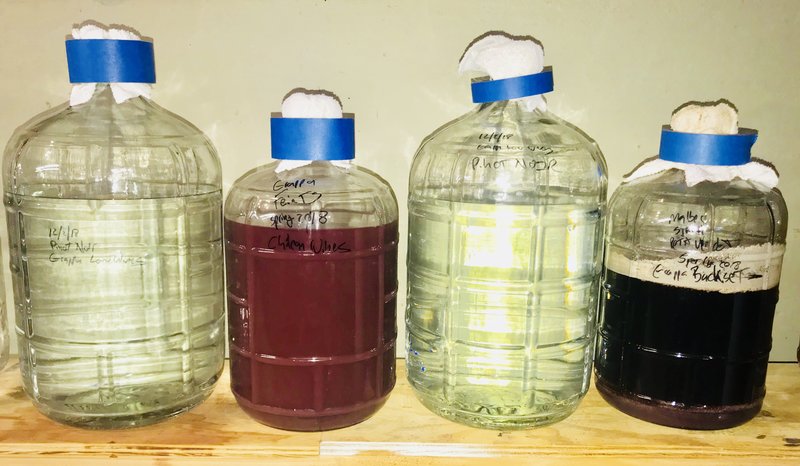

So I let that first run air out for a week. It’s 128 proof. Bottled it into 2x 1/2 gallon jugs with three large fingers of heavy toast heavy char white oak. No cuts. Cork stoppers are loose for some air. Long term aging. I might stick another heavy char oak finger in there.
I figure I can at least let it sit around for several years as an experiment instead of chucking it. The smoked pomace flavor sorta remimds me of smoked peat - in a way. Maybe time and char will make it spezial.
The remaining brute w/pomace sugar and water - i added more water and more sugar. It fermented over the past week. Ran it through the grape press and have about 15galloms now in carboys. I’m going to take these pressed skins - well used now - and top up with maybe six gallons of cheap white grape juice and some sugar. Ferment. Start stripping this last batch and utilizing the backset into low wines for spirit runs. Shooting for two strips and anything left over added to low wines for final spirit run fully charged.
I have made this into a grappa sugarhead to stretch it a bit but also plan to utilize backset protocol to concentrate the grappa flavors. Maybe i can bump the backset pH and develop an infection too. I’ll see. No huge hurry.

I ran two grappa strips this weekend. I let it clear for a week so no scorch on these strips - got about eight gallons or so low wines. I have taken three gallons of stillage, added the lees into that, bumped pH up to 5.5, threw in a handful of malted barley and about two cups or so of infected bourbon backset. I’ll give that a week or two to fester and I’ll mix with the grappa low wines with some sulphuric acid for the spirit run. Backset was about pH 3.30 so i added calcium hydroxide till it was too much (pH 6.8+). Then I dumped the approx 1 gallon yeast trub in there and went back down to pH 5.5’ish. I might mesh bag some of the pomace and stick that in the backset or low wines.

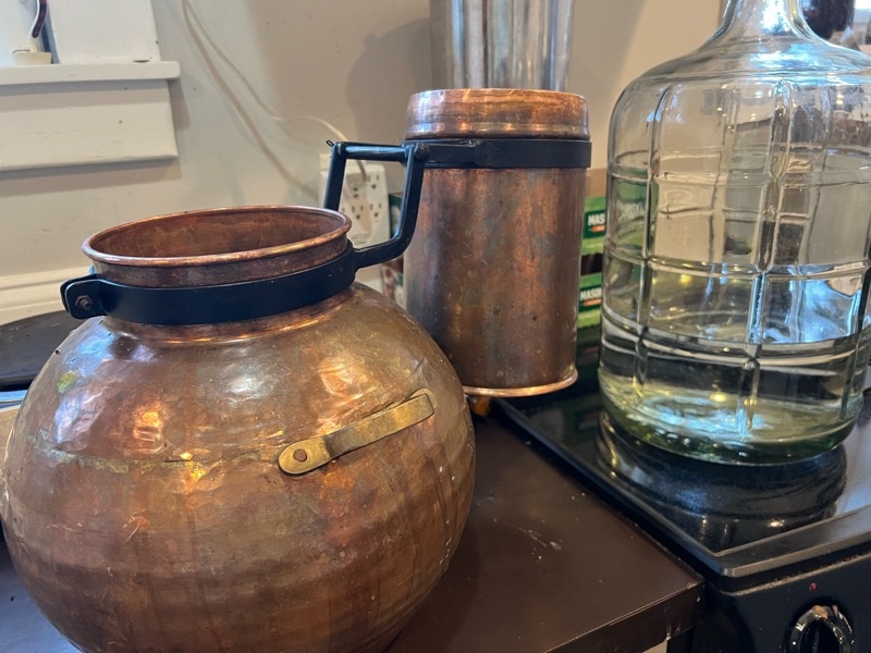

Prepared for a spirit run Sunday tomorrow. This is what I’m charging the boiler with -
8 - 9 gallons grappa low wines stripped from fall pinot noir pomace, pinot noir wine kit concentrate, and sugar. Low wines abv is about 30-35%abv.
1.5 gallons infected backset from spring chilean grape pomace grappa.
2 gallons grappa feints macerated in spring grappa pomace left overs for a couple months then squeezed.
50-100ml sulphuric acid to enhance the infected backset esters.
I’m planning a nice leisurely spirit run fractioned out into probably 24-30 jars. I’m going to blend this with a slight lean towards more select heads and tails cuts added into the final blend for oak and age. At this point I’ve also got a dedicated aging jug with solera grade grappa additions back to my first batch so that’ll get a nice top-up too.
I’m going to experiment with incorporating the feints maceration protocol also into my whiskey production and just macerate whiskey feints in some grain (maybe spent maybe fresh) until the next spirit run. Let it macerate for a period of months between runs. I’m expecting very satisfactory results from adding that protocol based on how these macerated grappa feints smell now which is friggin amazing.

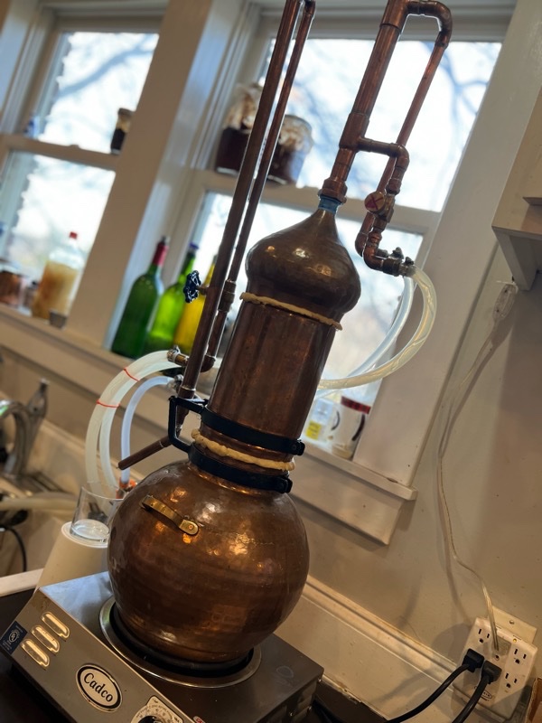

Spirit Run: Low Wines, Pomace Macerated Feints, Low Wines, and infected grappa backset from last season.

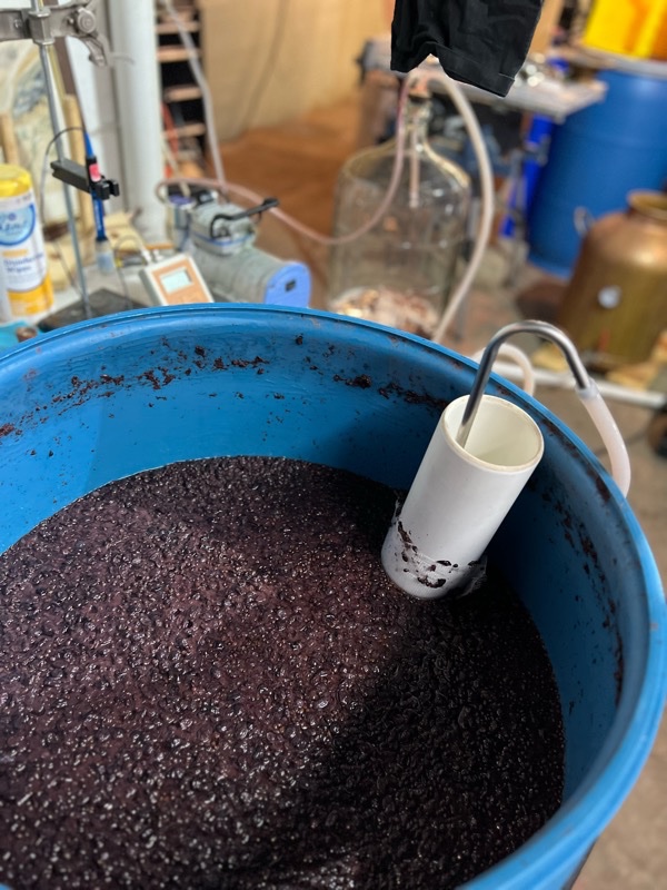

Putting down another “grappa head” this season.
Over the past couple seasons I saved pressed pomace.
5x five gallon buckets. Each full of pressed pomace. Fairly dried. It didn’t get infected or turn to vinegar. One of those buckets is from fall 2022 wine pressing so I’m keeping that to the side and will use it to macerate the hearts from the larger run and re-run in the small still a few times.
4 buckets of varied pomace into the 55g blue hdpe drum.
2x winekits - merlot juice. 12 gallons worth of merlot.
25# sugar.
Top up the barrel with water about 2/3 full.
Ec1118 yeast plus slurry/trub from last wine ferment. BM4x4 and D254 yeast bed.
Step feed 25# more sugar + water over approximately one week until barrel is about 4-6” from the top with must.
Punch down daily and maintain approximately 80*F ferment temp. It swings 78-80*F depending where the probe is and how often I punch/mix.
I’ll press this once AF is complete to strip off the pomace. Then spirit run & cut. I’ve got three gallons of brandy feints + three gallons of chardonnay that I won’t be bottling to top up the spirit run. I might be able to get two spirit runs from this all said and done.
Hearts cut will get proofed down and mixed with remaining 5g pomace for maceration before a final 3 or 4 “infusion runs” on the fresh pomace through the small alembic with false bottom.
I’ll be using this for straight white grappa, a badmo full for aging, and for use in a solera port, some rakki, etc..

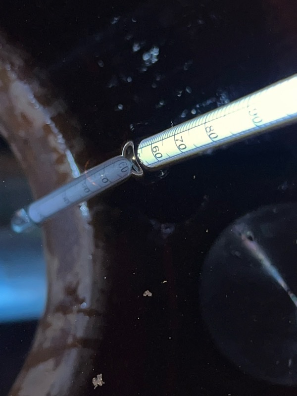

Jar 2 is reading 90%abv on the mini P&T.

That patina on the still.

Second spirit run in this series yielded almost 2.5 gallons of hearts @ 120 proof.
I took half of the hearts and proofed down to maybe 40%abv, spread it out into three gallon jars, and then added more pomace to macerate and monitor for a couple/few days before distilling on the pomace a third time with some also loaded into the infusion chamber on the alembic.
I did this on the first spirit run also except without macerating fir a couple days. Should turn out about the same but hoping the maceration adds a bit more flavor.
I’ll break these hearts up into two further spirit runs like this.
Triple distilled grappa-head-geist. Strip run I cut fores, first spirit run I cut fores/hearts/feints. Third spirit run will also cut fores/hearts/feints.

- jonnys_spirit
- Posts: 3972
- Location: The Milky Way
Re: 1st grappa
I’m running this config with about 10-15% more power (approx 70% of 1k5W) than I do in straight pot still mode with enough reflux to be right on the edge between drips and a pencil lead sized stream. Approximately 8-900ml/hr.
Whatever heads/fores that were there compressed nicely into first fraction. Very smooth clean and fragrant.
Happy Saturday!
