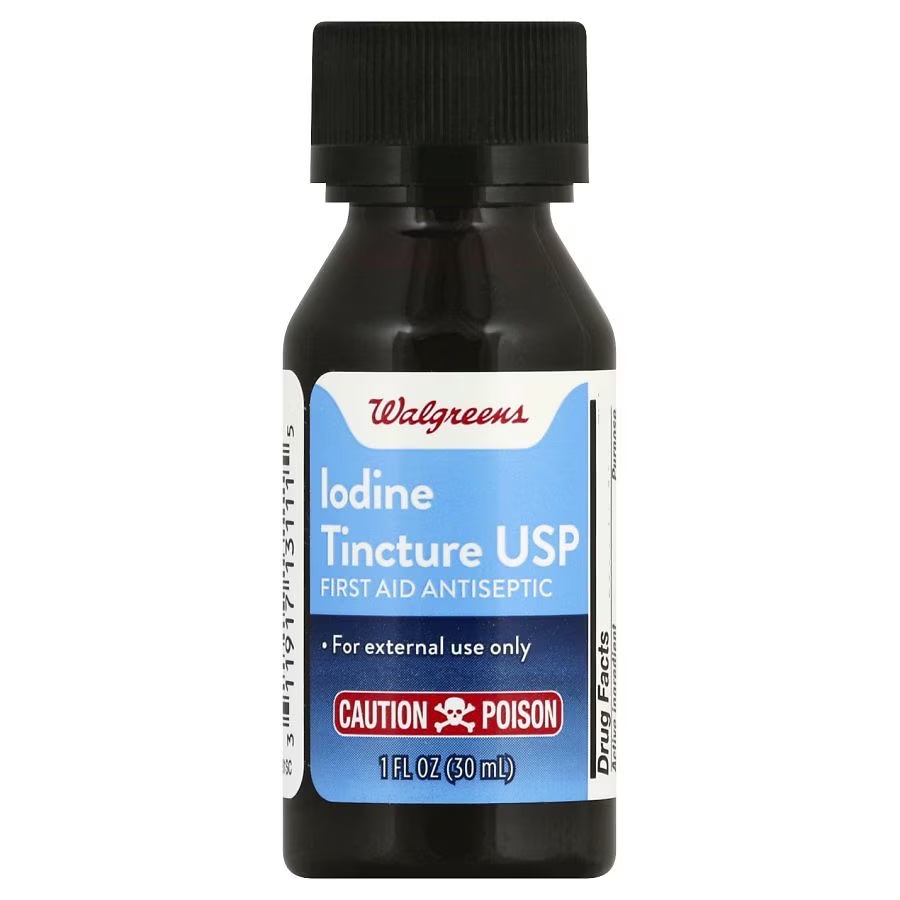

I use the “tincture of Iodine” from the Walgreens or CVS store. I believe it is 2% iodine.
Just a drop on a sample is enough too.

Thank you for that. I ordered some which just arrived, I thought it was too weak of a solution when I saw the label.

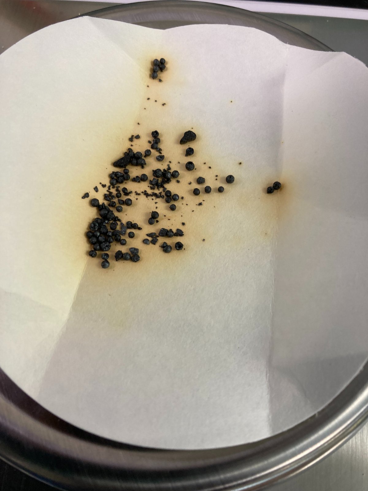

So here is 1g of Iodine on the balance .You can see it is very quickly sublimating and the paper is staining It took over half an hour on the Magnetic stirrer and even then , there was still a bit of undissolved Iodine .

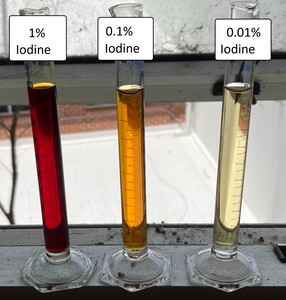

So this is a lineup to show the relative colour of Iodine solution at 1% , 0.1% and 0.01% concentrations .

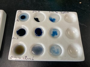

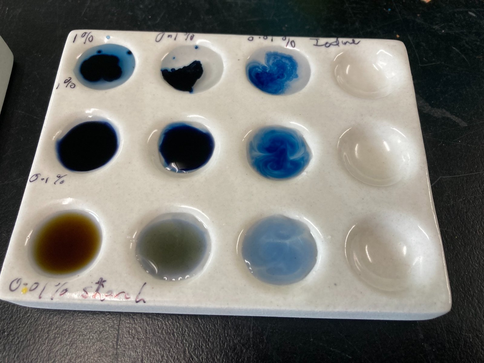

I have starch solutions of 1% ,0.1% and 0.01%.
Lets test them
First ten drops of Starch in each well .
Top row 1%
Middle row 0.1%
Bottom Row 0.01%
Then 1 drop of iodine
Left column 1%
Middle column 0.1%
Right Column 0.01%
This time , two more drops of Iodine in each well as per above .
notice that the 1% Iodine is so strong that it masks the weak starch test result . IE , if you have a very strong brown colour , you can"t see the subtle blue colour in a weak starch solution .
So in conclusion , Iodine solution is very good at detecting starch .
Any of the solutions that you buy from a Chemist will be more than strong enough .
Diluting the Iodine can detect lower starch levels by not masking it .
EDIT: just for shits and giggles I just tried 0.001% Iodine and it barely showed anything at all on the 1%starch and nothing on the others .
I’m of the opinion that Iodine in the range 0.01- 0.1% will give the best indication .
Stuff bought from chemist diluted 10:1 will be ideal . Undiluted , it may well be masking the facts and when you think you have full starch conversion , it isn’t
Lets test them
Top row 1%
Middle row 0.1%
Bottom Row 0.01%
Left column 1%
Middle column 0.1%
Right Column 0.01%
