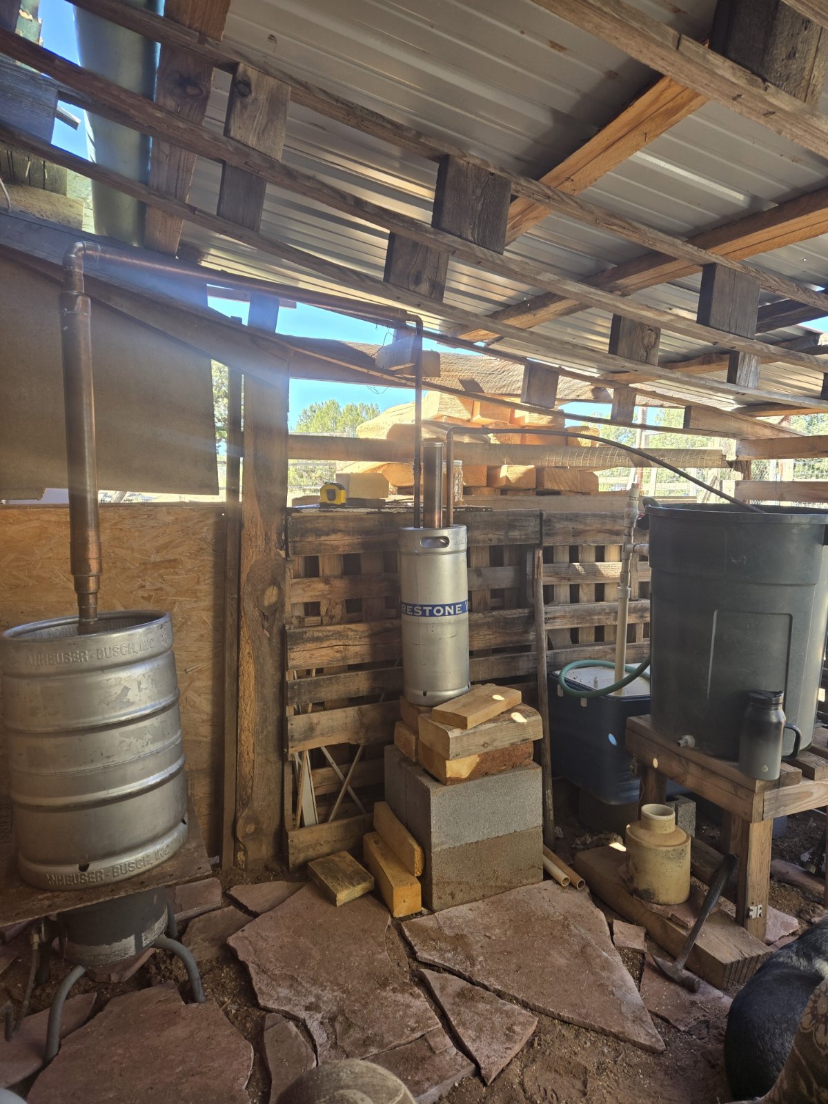

Still-Learning
Posts: 20
Joined: Thu Sep 19, 2024 10:00 am
Location: High Desert
Re: Thumper?
Post by Still-Learning »
I really like the way my thumper works to produce a good product and gives me the ability to assist with flavors (which I am currently learning on) and no need for all those spirit runs. Excellent product! I use a 5 gallon keg as thumper on my 15 gallon pot. The 1st 3rd of my run comes out at 170 - 180 proof.
PS an old shiner from Oklahoma helped me on the build and he says they always run a thumper back in the day.
