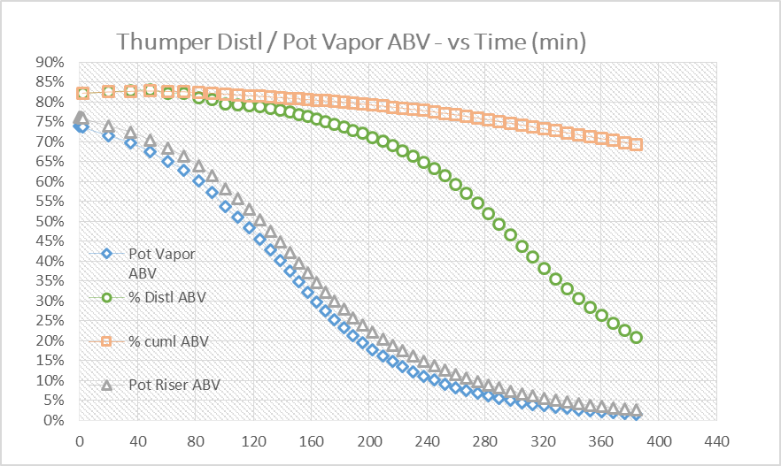

I have calculated the pot - thumper spirit run in Excel and show you charts of how the run variables change during the run. Remember that hearts stop here at about 40% ABV out the spout ( really when taste and smell are tails - you determine this ). That is at about 240 minutes run time. Then tails would come after that.
Here is how the different vapor ABVs change with run time:

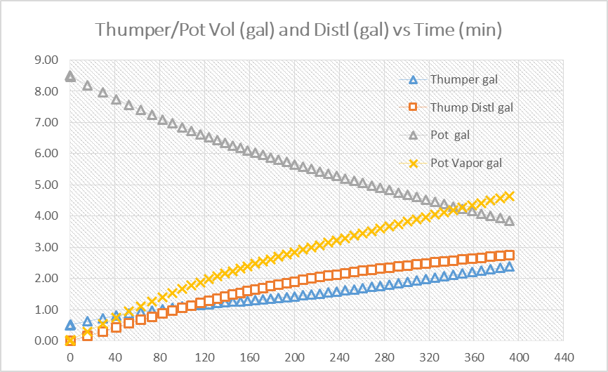

Here is how the pot and thumper fillage and flow rates change with run time:
Notice that the thumper does fill up some. At 240 minutes, it can be at about 1.5 gal fill but should not get over 2.5 gal.

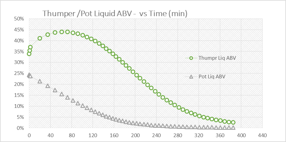

Here is how the pot and thumper liquid ABV change with run time:
So,
if you decide to do something close to this run plan, good luck and be safe. Remember that when a pot - thumper run is finished and heat is turned off, to vent the pot to prevent a vacuum implosion. Also, make sure your thumper inlet tube is immersed under the liquid level at the start.
So,

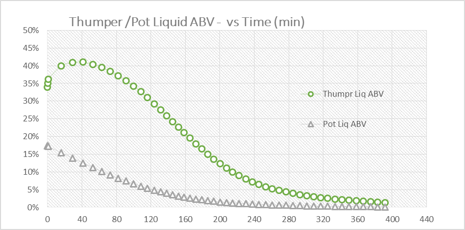

Below are the charts of how the run variables change during the run. Remember that hearts stop here at about 40% ABV out the spout ( really when taste and smell are tails - you determine this ). That is at about 320 minutes run time. Then tails would come after that.
Notice that the thumper does fill up some. At 320 minutes, it can be at about 2.4 gal fill but should not get over 2.7 gal.
Here is how the pot and thumper liquid ABV change with run time: So,
