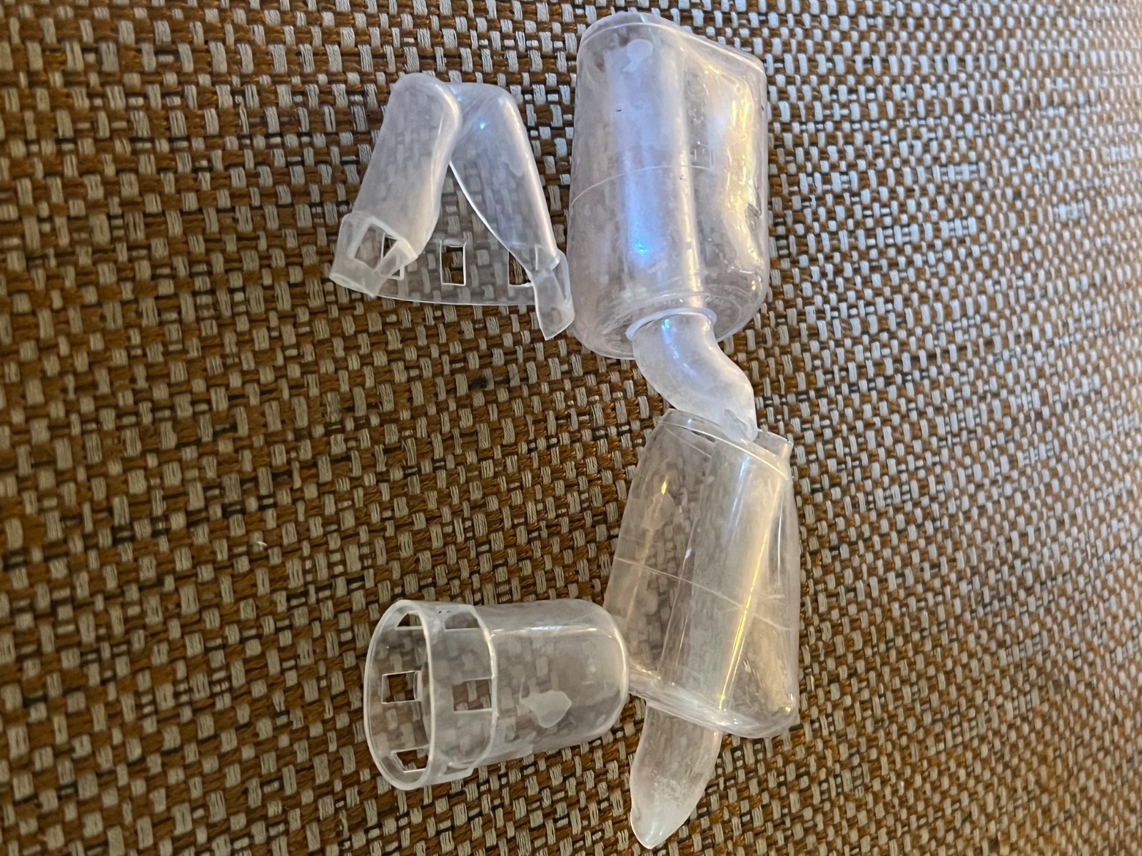

Apparently some cheap plastic airlocks melt at/around 212F - :shock: so don’t boil them in water/PBW and assume it will be fine (the lids were fine) (others I would swear I have boiled successfully, so ymmv…it’s possible these failed due to age or heat/cold cycles in storage causing the plastic to change somehow?!)

I would say the problem is temperature.....there are better ways to sanitize plastic :roll:

It was a free bit of goodies from an unknown person who had it stored in relatively unsanitary conditions - I planned on both cleaning and desanitizing with a boil, and also then using starsan!
It certainly was a temperature problem - but I’ve used similar airlocks and had them in very hot water before. I wouldn’t have expected many plastics would melt below 212F though. I was surprised, which is why I posted. Surely I’m not the only one who might have assumed (and you know what they say about assuming) that boiling stuff to sanitize it would be fine.

As you found out, not all plastic is the same.

I’d say it was Polystyrene . It has a glass transition stage very close to 100°C even though its melting point is up around . 240°C
The exact transition temp will vary slightly . Hence why you had some that survived previously .
I used to have to make and dispose of petrie dishes . We had to make sure the agar was sufficiently cool before pouring it into the dishes as if it was still boiling it would often warp the dishes . To dispose of I had to put them in a pressure cooker at 15-20psi . Thats around 120°C . They would be completely shrivelled up into lumps .
