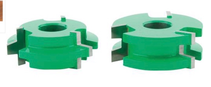

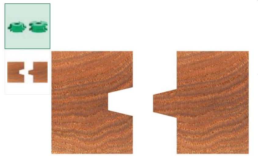

- Posts: 3339
This is the profile of T&G that I use. Very simple and clean. It was recommended to me that I consider a profile that will better lock the boards together when working, but I “glue” my staves together with beeswax and don’t really have any issues keeping things together while doing the circle shape cut and sand.andystanton74 wrote: ↑Tue May 14, 2024 10:07 am For those that use a T&G type connection to join the staves, what type of bit works best? Looks like there are several router but patterns out there that could maybe work.
I use a shaper table which is a big improvement over a router table. Among other factors, it is relatively easy to get the depth (alignment) right for a smooth face, it is very consistent when making lots of parts, and I feel it’s much safer to use. Routers scare me a little. I would use a dowel before trying to use a hand held router for this.
Years ago I took a community college woodworking class just to have access to some big pieces of equipment I was lacking. The class was cheep and there is free help with the setup. Well worth looking into if you don’t have the tools, bits, or skill.
I’ve successfully made heads with biscuits and dowels too. They all work if you have good woodworking skills, know how to make a jig, take your time and use plenty of test boards to get your jigs set up properly.

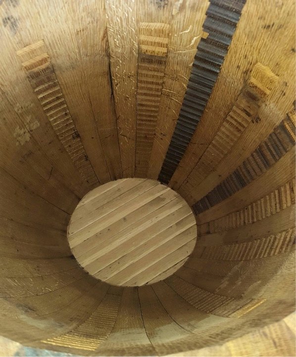

I was fixing a leak last night on my latest badmo clone and an idea started bubbling in my head. I had a look and can't see any mention of it, apologies if it's already been covered, is there any reason we couldn't cut channels with the grain before toast/char to adjust the surface area of our barrels to match any commercial size ratio? I was thinking a router, but a table saw should be able to get it done as well. I'm happy with the slow progress of my standard barrels, but was thinking of making some "faster" barrels for some whiskey sugarheads I'll be cranking out with this years whiskey batches.
- Twisted Brick
- Posts: 4154
- Location: Craigh Na Dun
I was just thinking about this the other day. Cut out almost all of the center/bottom of your stainless vessel but leave a perimeter ~3/4" 'ring' of the vessel's actual bottom. Fit, press and pin into the bottom a second head with wood/toast/char of your choosing. Should be a bit faster than a single head I think, but might be vulnerable to thirsty angels. It would also be more work to bevel (contour?) the head to fit the stainless but I bet it wouldn't take that long.Beefer wrote: ↑Sat Jun 15, 2024 4:33 pm I was fixing a leak last night on my latest badmo clone and an idea started bubbling in my head. I had a look and can't see any mention of it, apologies if it's already been covered, is there any reason we couldn't cut channels with the grain before toast/char to adjust the surface area of our barrels to match any commercial size ratio? I was thinking a router, but a table saw should be able to get it done as well. I'm happy with the slow progress of my standard barrels, but was thinking of making some "faster" barrels for some whiskey sugarheads I'll be cranking out with this years whiskey batches.
I like your router idea but for the material it removes. Might work well if an add or replace item.
- Posts: 51
- Joined: Wed Apr 15, 2020 3:45 am
I see where you are going brick - I was initially playing with the idea of sourcing stainless pipe sections to make dual ended barrels, but the local Kmart sells stainless 7.5 litre pots for $10, so I didn't follow that up. I was thinking more along the lines of increasing the surface area of a couple of the single heads by cutting "grooves" inline with the grain before toasting and charring. Depending on how many, how deep and wide the channels are you should be able to dial in the surface area to whatever barrel profile you want.
I see the grooves on the pic run 90degrees to the staves - I'd imagine that this also increases the amount of end grain exposed - which I always thought was to be avoided? Might be a myth I picked up?
I think its worth doing a side by side comparison - same size, same oak, same sugarhead but double the surface area with the router on one before giving them the same toast and char. I'd best get off my arse and get them made so I can report back
