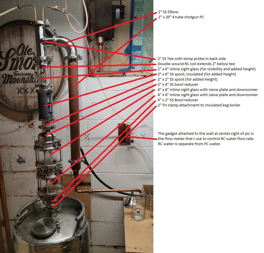

I've been pretty happy with my results so far, but being a hands on kind of guy I recently decided to build a 4", 3 sieve plate flute. I ran my latest bourbon batch using this for the spirit run (2.0 dist). This batch (same size as previous bourbon batches) produced more final product than if I used the pot still, and the quality seemed to be pretty good. It took about the same amount of effort as using a pot still. But by producing higher ABV requiring more dilution, the end product MAY not be quite as flavorful as a pot stilled product, but a direct comparison would be needed to be sure.

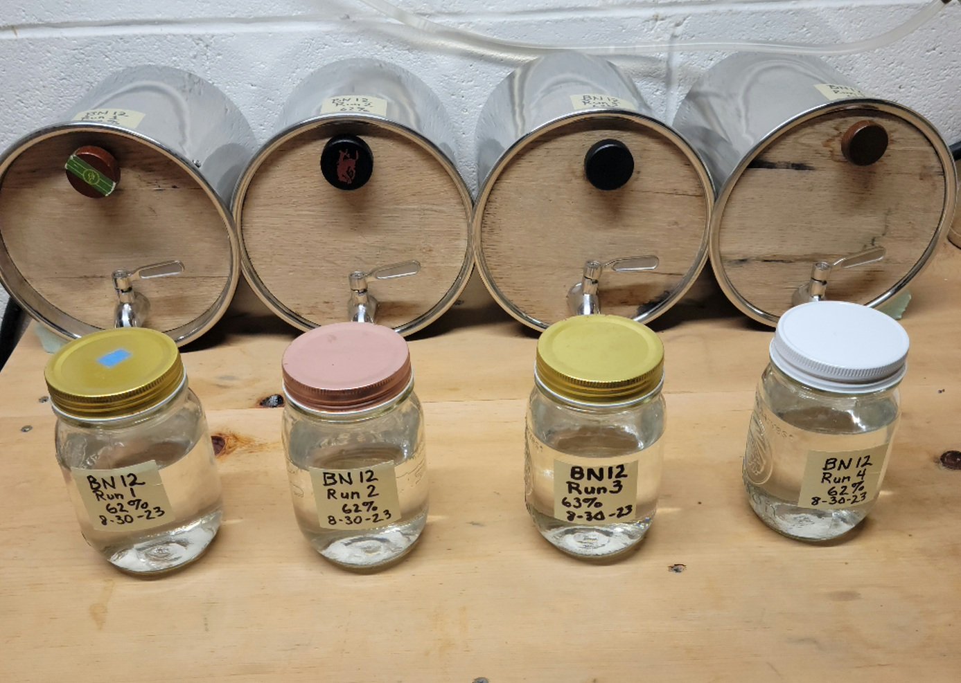

  • Run 1: 12 gallons wash thru flute with 2 plates
  • Run 2: 5 gallons wash, 2.8 gallons low wines thru flute with 2 plates
  • Run 3: 5 gallons low wines thru flute with 2 plates
  • Run 4: 6.2 gallons low wines thru pot still.
Each run should produce a gallon or more of product at 62% ABV. The same group of 5 people will be doing the cuts on each one, and after all 4 runs are complete we will blind taste and evaluate the end result of each. Once we've ranked the 4 from best to worst we'll reveal what method was used for each, and I will use that info to decide which method to use going forward.

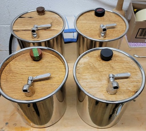

Each of these will go into a 4 qt Badmo barrel, med toast, char 3, and we will do periodic blind taste tests to see how they are affected by time in a barrel.
