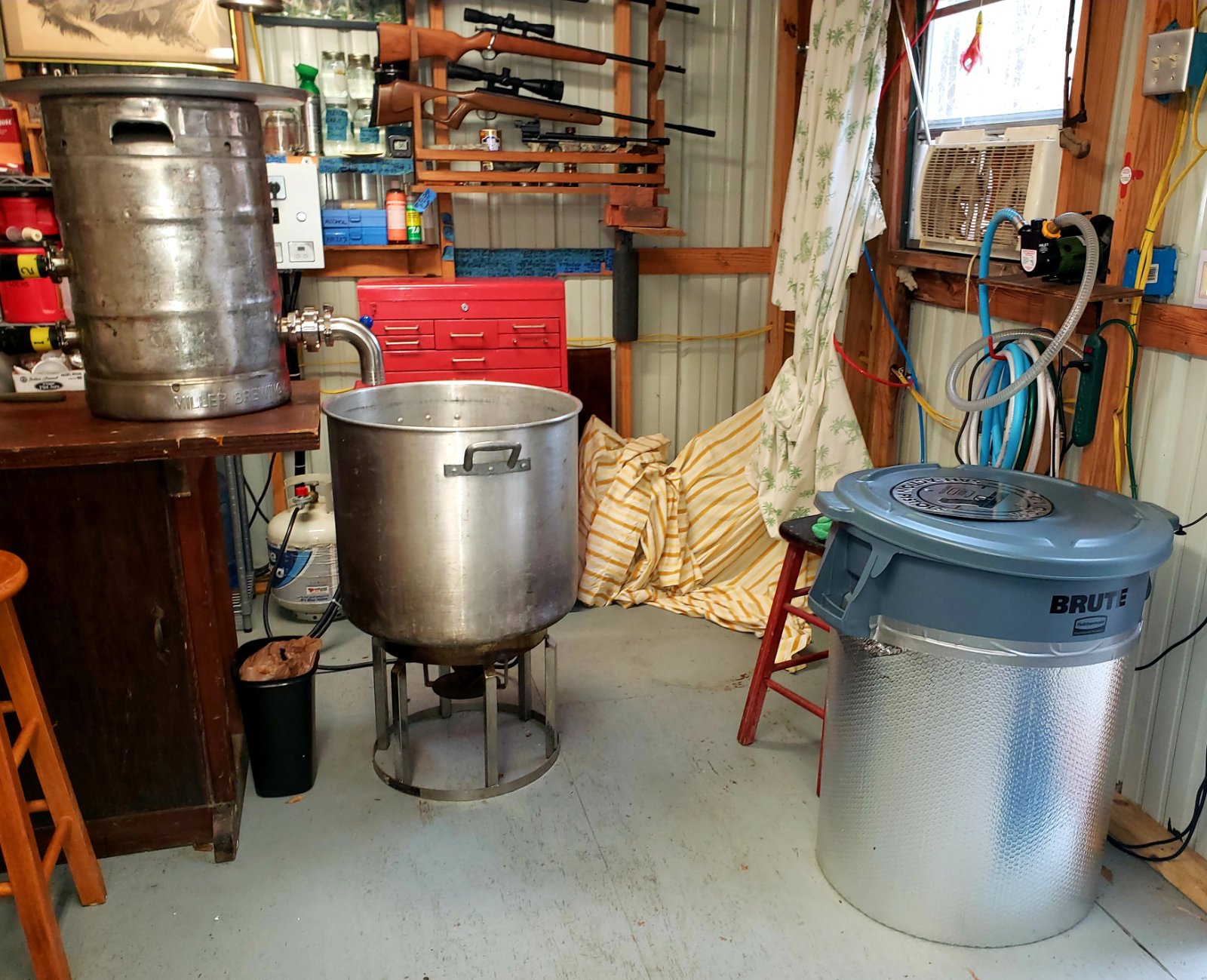

This is my first attempt at ferment tank temperature control. This is 32 gal Brute Trash can in a 44 gal trash can. The 44gal can is a water bath heated with an aquarium heater. It held the temps really good. You couldn't mash in it though.
This is my second attempt. I put heated seed mats under Reflectix wrapped around the brute. It also help temperatures well. I Gelatinizin the corn in the 30 gal pot to the side because I was worried the super hot water would melt the brute can. I scorched the corn in the 30 pot.

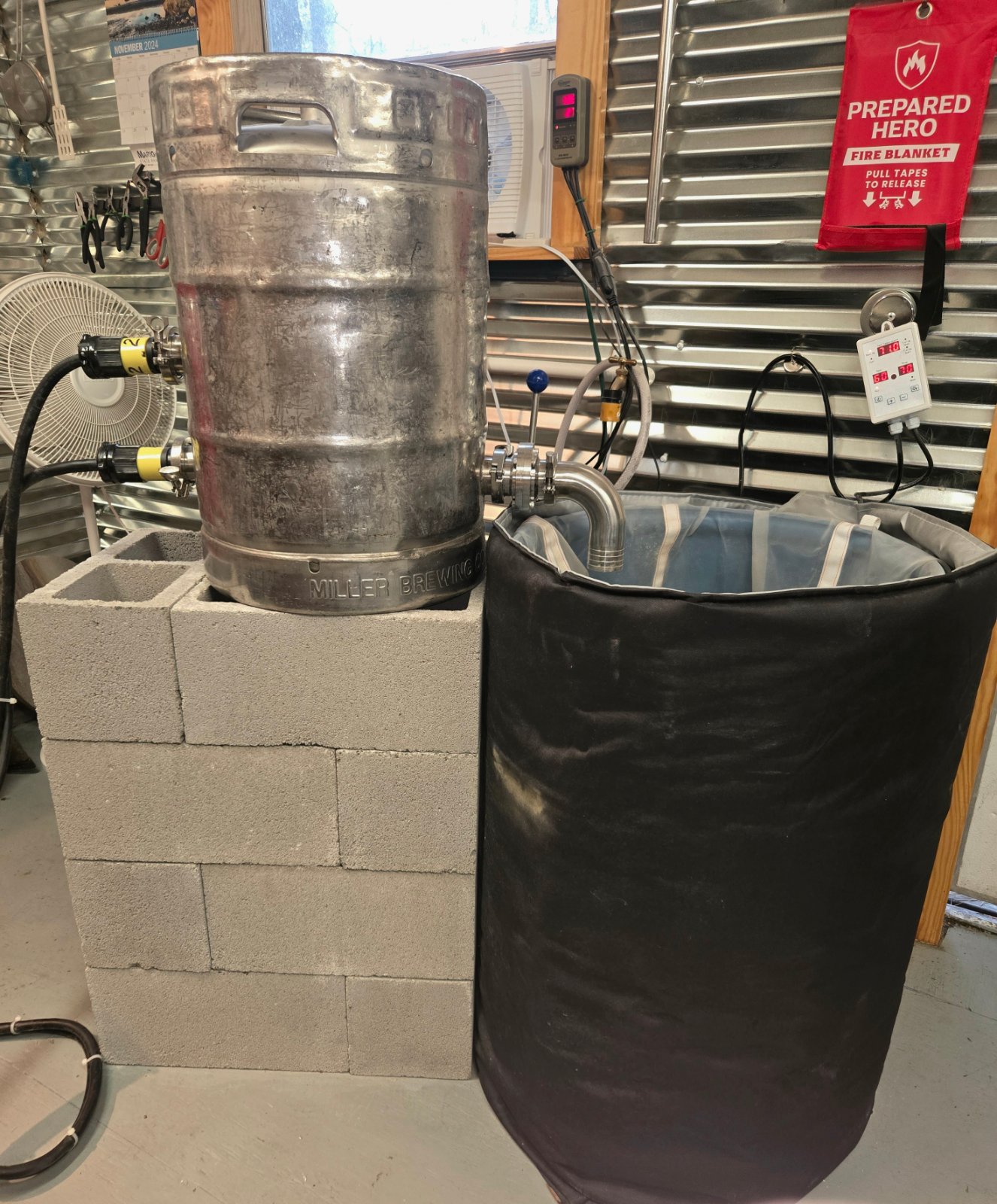

This is where I'm at today. VEVOR Drum Heater Cover,55 Gal Drum Heater Blanket. I ditched the Brute Trash can and replaced it with a blue 55gal plastic barrel. I have a BITB filter inside the 55galbarrel that I can lift out with a come-along. The Vevor Blanket has been great so far. I add my hot water to the barrel at 205F. I set the Vevor to hold the barrel and the corn at 180F for 3 hours. Then I drop it to 146F to add my malts. Then I drop it to 80F to add my yeast.
I think I will keep this set up. I can gelantinizion corn, ferment , then filter with this set up. It's been a great work saver.
