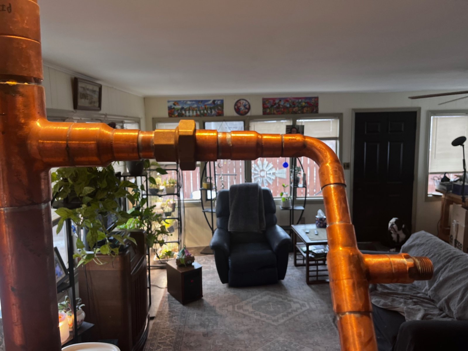

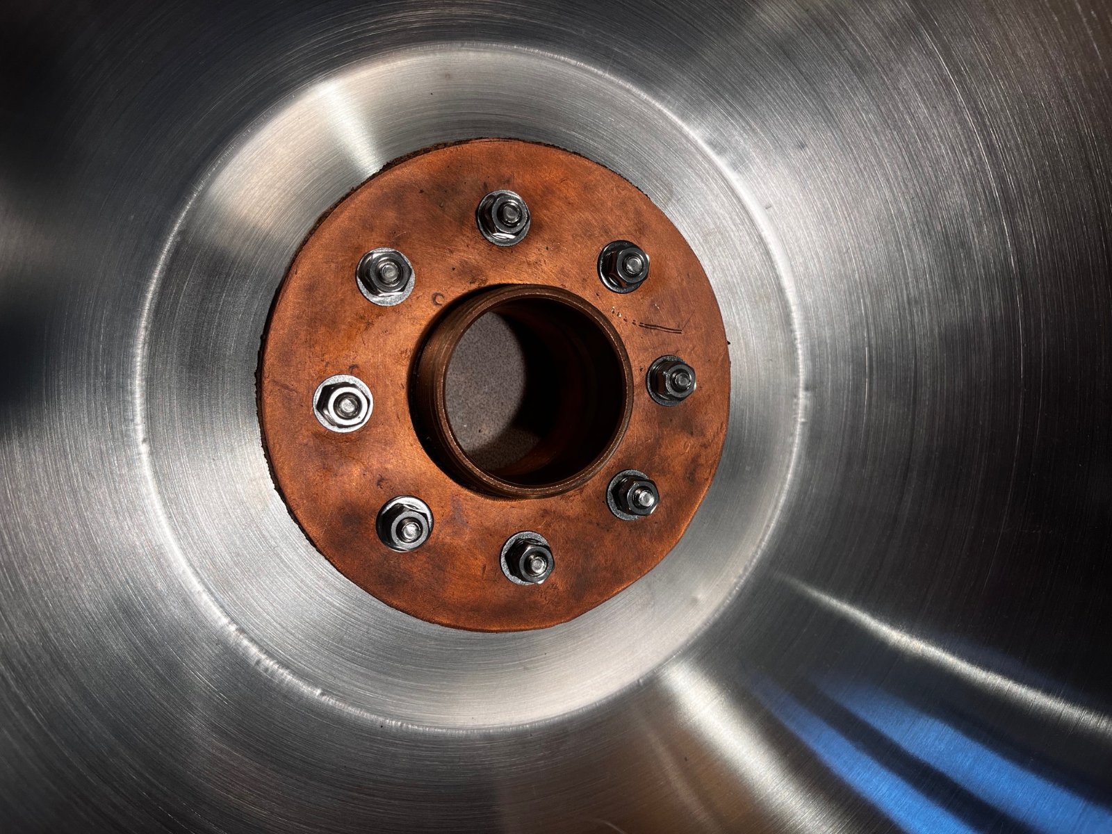

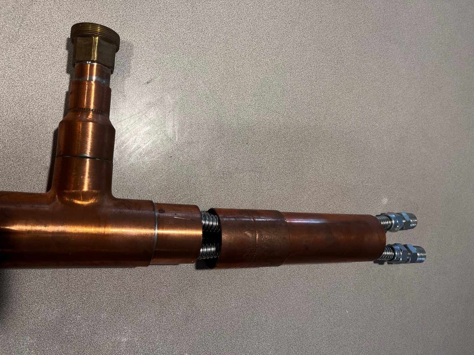

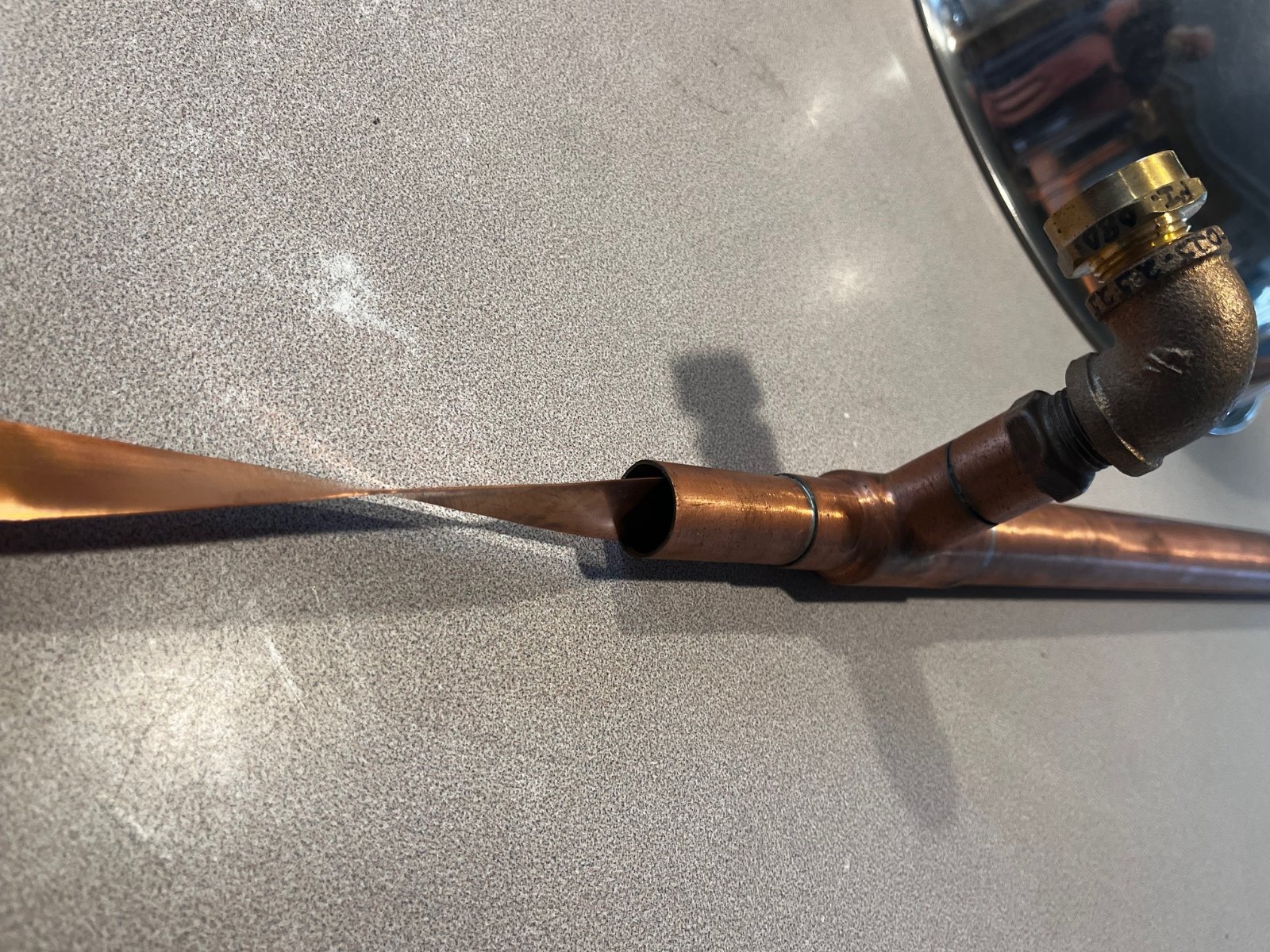

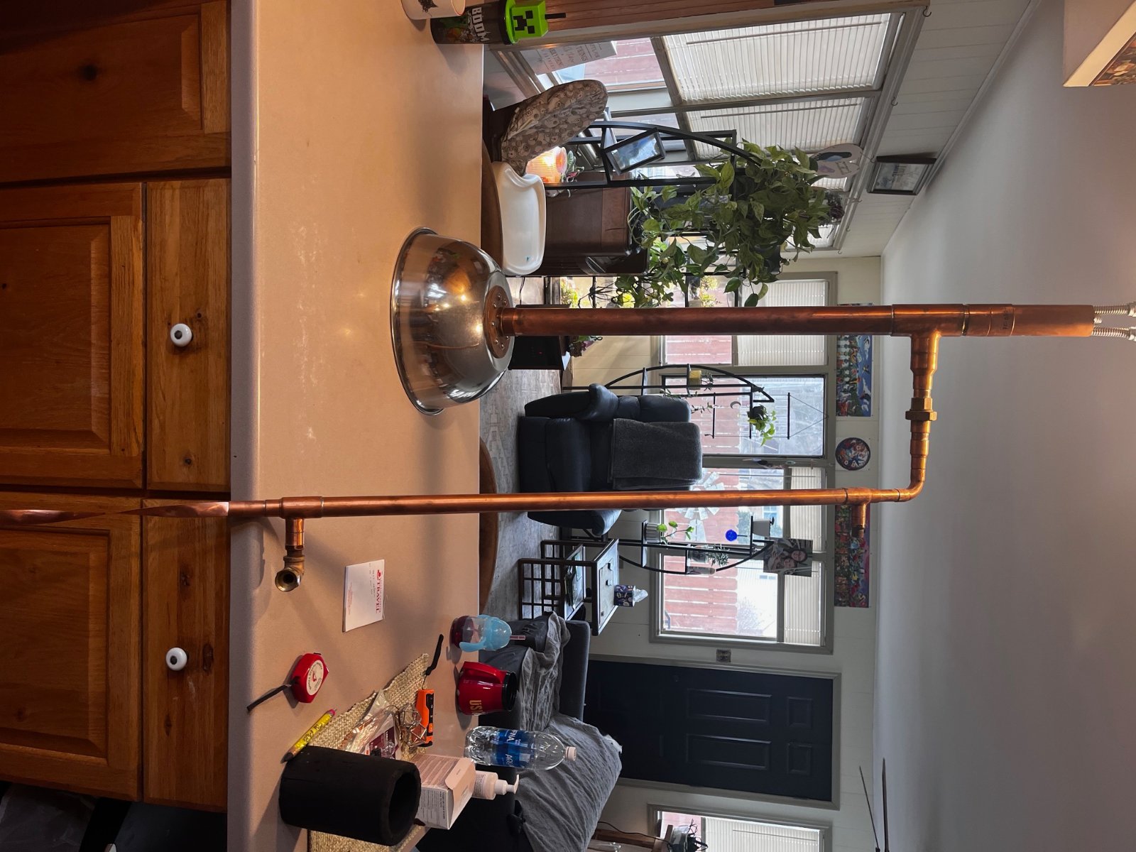

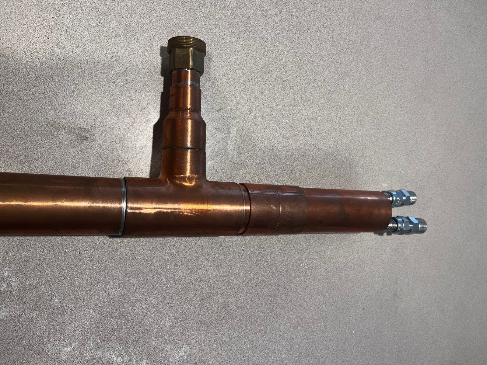

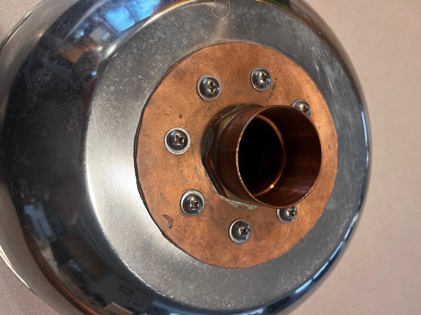

I went down to the basement and retrieved my still head that had been drawing dust for a really long time.
My memory is not as good as it used to be.
What I thought was a 2x2x2 takeoff in NOT, it's a 2x1.5x2. So, my earlier comment about the reflux ratio was incorrect. My Bad. It's been years since I built that.
Starting at the salad bowl: 2 copper plates sandwiching sheet cork top and bottom, bolted on with SS hardware. Next there is a male threaded adaptor soldered in place to the top copper plate.
The column is 30 inches long, and is not soldered in place, just friction fitted.
At the other end of the column there is the previous mentioned 2x1.5x2 inch T soldered in place.
Out of the top of the T there is a short male nipple soldered in.
Above the nipple is a sweat coupling to a 6-inch piece of pipe, neither of which are soldered. The idea here is to be able to remove the coupling and 6-inch nipple and replace them with a copper cap when not using the RC.
Following the vaper path to the takeoff, the output of the T is 1.5 inch, that is then reduced to 1 inch, which goes to a 3-piece coupling, (I know this as a 'union') for the attachment of the PC.
The other side of the union is then reduced from 1 to 3/4 inch. The PC is 36 inches long with 1 inch water jacket over 3/4-inch vapor path. The 3/4 is spiral wrapped with 14-gauge solid wire to help disturb the water flow. There is also a length of sheet copper that is cut to be inserted into the vapor path. It is twisted to try and disturb the vapor flow. (I am guessing that this is completely unnecessary.)
I think that pretty much covers it. If you have and questions of input, feel free.

Those pictures are totally fine Willie, just get the hang of rotating them before attaching and you'll be good.WillieP wrote: ↑Sat Jan 04, 2025 2:40 pm I went down to the basement and retrieved my still head that had been drawing dust for a really long time.

Ok, a couple of options.
As you have the column just friction fitted (I have the same on my gin still and I just put a wrap of PTFE tape around it before fitting) into the copper fitting on the bowl, you could make a dedicated pot still head super easy for stripping and running Whisky/Rum etc.
All you need is a short section of 2" for the riser, a pair of 90° elbows so you've got angle adjustment, a reducer and another fitting the same as you already have, to attach your PC.
Second, far less ideal option is to cap the top as you say, then run with the column unpacked and/or insulated so it doesn't act as a reflux column.

Thanks MM!MooseMan wrote: ↑Sat Jan 04, 2025 3:26 pm
I totally agree with everything you have said.
And you are right, it wouldn't take much to put together a bit of copper for a dedicated pot still head. Good suggestion, and probably the smart choice.
I just don't have any experience at what type of still gives you what type of product.
There are so many people running so many different still heads in so many ways to get so many different products from the same wash/mash. It becomes a bit overwhelming to know what direction to jump in.
I know that this is just my lack of experience and my ignorance talking. I will start with the tried and true, strip, strip, strip, spirit on a pot still and see what I get and then go from there.
I really like the idea of running a CCVM as a reflux, but I feel like that should be a little farther down the path for me.

Is there any advantage or disadvantage to having a given height to the vertical column of the pot still? I can't come up with one in my head. As long as it fits on my salad bowl and couples up to the PC it's just basically a pathway for vapor to get from the brew kettle to the PC. (I'll use the search function, but while I had ya, I thought I would ask your opinion.)
I appreciate you taking the time to nudge a noobie in the right direction!
Cheers,
WillieP
- Posts: 8978
Re: WillieP's World
Hey Willie
The Riser ( it’s called a Column when it’s packed of a reflux still) can be any length that makes it convenient to collect under . It can be short if you don’t mind changing jars on the floor , or, you can make it taller so that it means the end of your condenser is closer to bench height .
Taller riser may allow a bit of passive reflux if it’s really cold in your still house and you are running really slowly . (IE , the extra mass of the riser can give up proportionally more heat to the surroundings .)
Some claim this little bit of extra reflux ,( it acts as a form of deflegmator, ) can result in a little better separation during a spirit run .
If you wrap a towel around the riser , it will insulate it and it’s length will be negligible.

Yummyrum,Yummyrum wrote: ↑Sun Jan 05, 2025 9:44 pm Hey Willie
Welcome, and thank you for your input!
Last night I was just google searching the subject and made the discovery that I had been mis-using the term column, instead of using the proper term, riser. My Bad. Thanks for pointing it out to me.
On the existing CCVM that I attached photos of, there is a 1-inch union that make the connection from still head to PC. This was done intentionally for a couple of reasons. First, to be able to change the slope angle of the PC to be able to adjust the height of the product collection point. And secondly, to be able to make it somewhat modular. The thought being if I wanted to add a thumper at some point in the future, I would be able to use the same connection.
I will make the takeoff of the pot still with the same connection, for the same reasons.
From what I read on the topic of riser height; it seems to be more of a personal choice that a 'it must be this' type of thing.
Seems like anything that physical works for your set up will produce nearly identical product.
