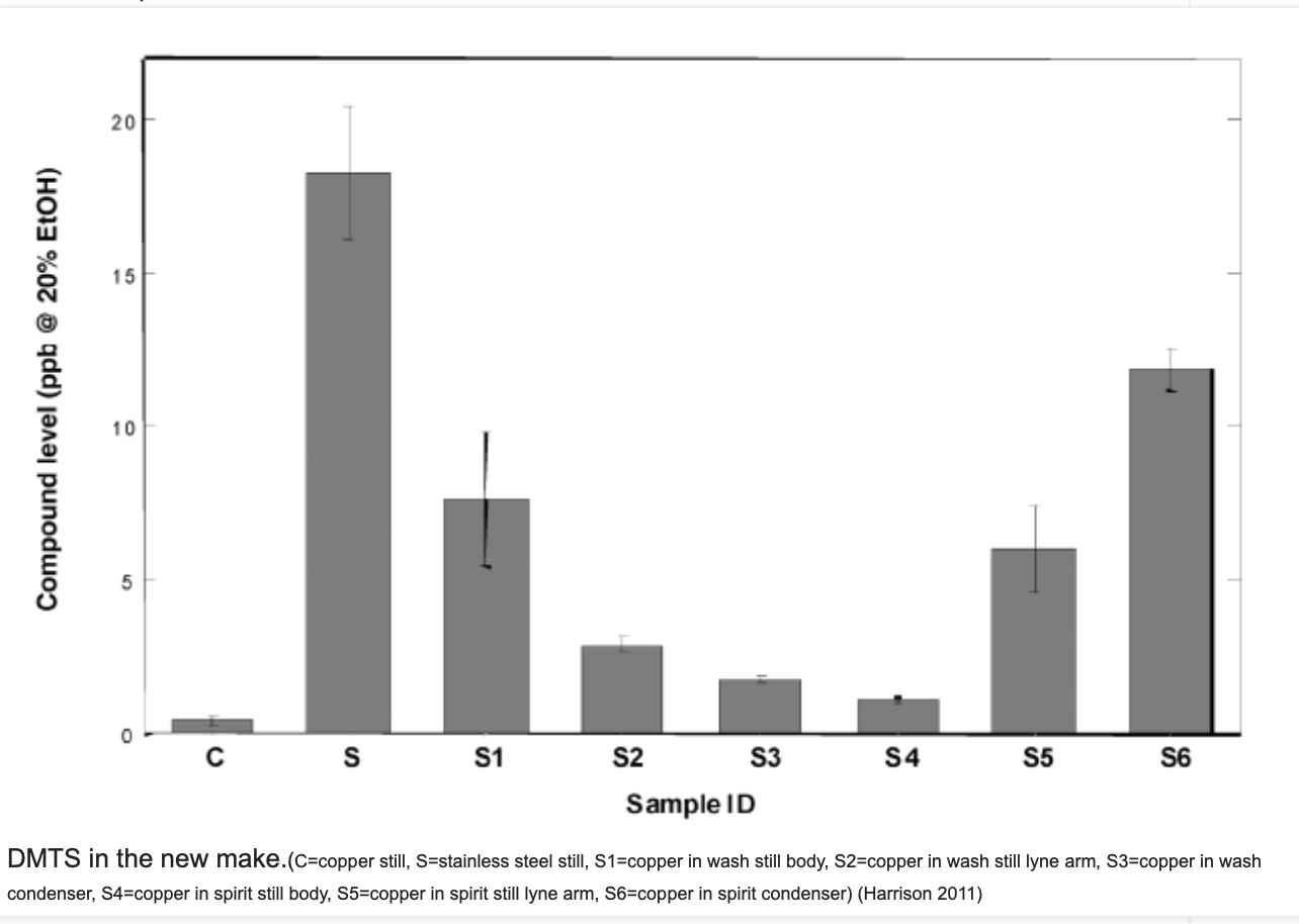

Re: Why do I need copper in my still?
I Found this document very interesting:
The Impact of Copper in Different Parts of Malt Whisky Pot Stills on New Make Spirit Composition and Aroma The summary states:
[quote.... ]In these laboratory scale distillations, copper was found to reduce the level of this compound best when placed in the wash still condenser or spirit still pot.....[/quote]
For this reason, I always use copper product condensers and pipes. During spirit runs, I add pieces of copper to my SS boiler.
During stripping runs, the copper product condenser is on duty, during spirit runs the copper in the boiler takes the job. The copper condenser is always there and does not hurt during spirit runs.

More or less like this?
On the other hand...
I wouldn't say I have problems with my nose. But either there is no difference on home stills or I happen to ferment with a minimum of formation of sulfur compounds.
In short, I have copper sponges in the steam line of the stripping distillation and a copper dome with a copper condenser on my spirit run. Do I care of sulphur? Not much.
That Harrison paper is interesting. I wish it included the impact of having copper in same section of both the wash and spirit stainless stills. As I understand that graph, S2 and S5 are the stainless stills with copper in the vapor path. It looks like copper in the vapor path in the wash (stripping) still reduces sulfur compounds by more than 80% and when in the spirit still reduces by more than 60%. And this is compared to two passes through all copper still which reduces sulfur by about 95%.
So if the wash started with 100 parts of sulfur two passes through all copper would leave 5 parts. In the stainless still with copper at S2 and S5...after S2 there would be 20 parts left and after S5 there would be 8 parts left which may not actually be different given the error bars in the experiment.
Same with the experiment where they swapped out only one part in each copper still. Would have been interesting to see if the copper still with stainless in the vapor path for both the wash still and the spirit still would be able to knock down the sulfur.
But what if it started with 5 parts only?Homebrewer11777 wrote: ↑Sun Jan 12, 2025 5:59 am So if the wash started with 100 parts of sulfur two passes through all copper would leave 5 parts.
The strip of poorly fermented mash at 45% from the spout smells like unsuccessfully stewed cabbage. But how often do we encounter this? I can't even remember the last time this happened. Moreover: I select a little bit of "strip scents" at a strength of 47% to 43% for long maturation in a separate jar. After a year, it turns out to be a great thang for blending.
