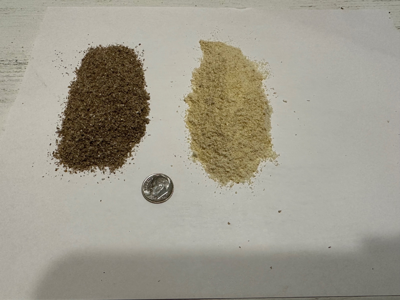

I started by grinding 25 pounds of each grain to a powder with my AMA grain mill. See pic below.

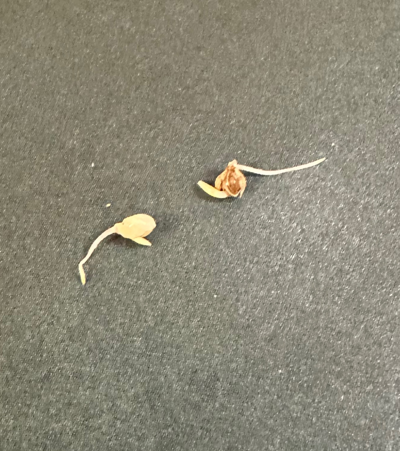

9) After 60 hours of germination, the acrospire on the Japanese Millet was about 1 1/2 times the length of the grain and 1 times the length of the grain for the White Proso. I had read a few articles on gluten free malting that referenced shooting for an acrospire length between 1 1/2 and 2 times the length of the grain for millet.
10) After a total of 84 hours, the Japanese Millet had an average acrospire length of 2 times the grain and the White Proso about 1 1/4. At this point, I continued to germinate the White Proso in different trays, and started the drying process of the Japanese Millet

12) After a total of 106 hours, the White Proso had an average acrospire length of 1 1/2 times the grain. I then started the drying process for the White Proso.

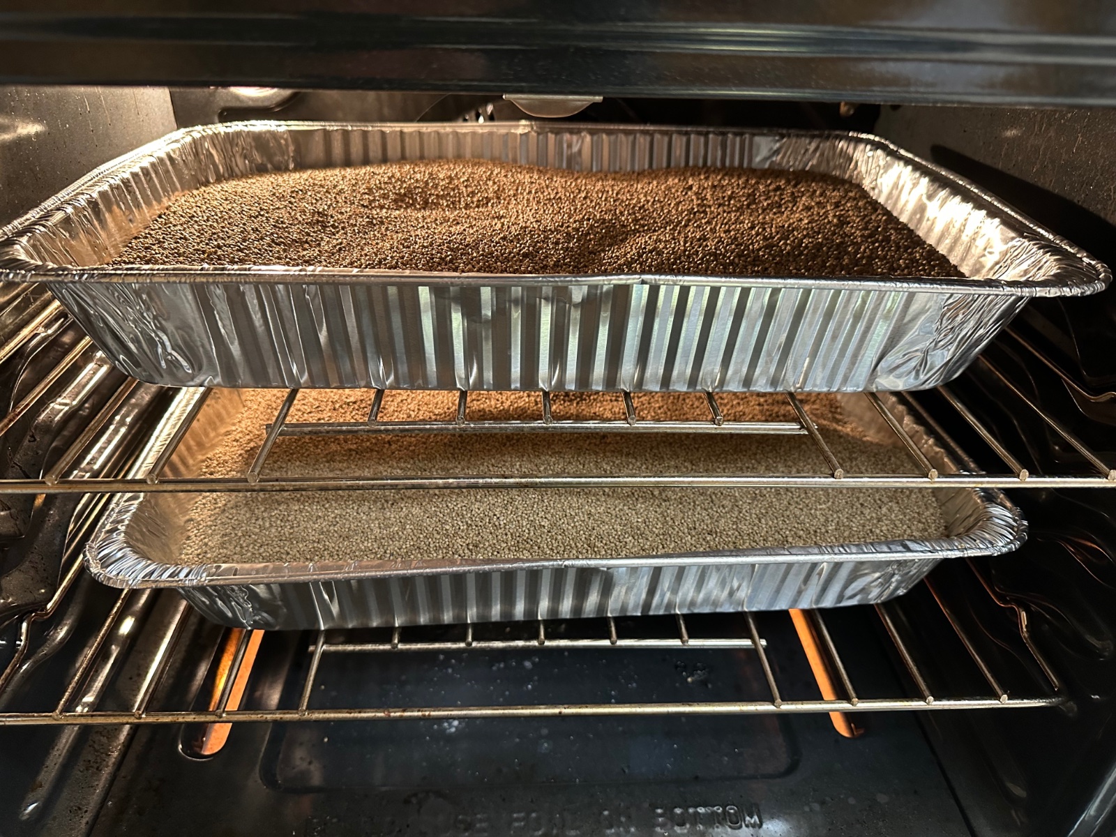

16) I kilned the grain in the oven at 205°F for 2 hours.
17) Finally, I ground all of the grain to a flour and put them in sealed buckets to store.

Both mashes passed the starch test, so I’m assuming the low starting gravities have something to do with a less-than-desirable germination rate and there being unavailable starches still residing in the grain that never germinated (is this a thing?)
Either way, at least both ferments are on their way, and the millet malting experiment wasn’t a total bust yet.
Based on some of Shady’s comments in my malting table post, I would say my germination could definitely be improved upon.
It does seem based on the taste prior to fermenting, the Malted Japanese Millet has a much more nutty and complex flavor than the White Proso Millet.
Here’s to lobster tail and whiskey. Three of my favorite things.

Re: Millet Mania
shadylane wrote: ↑Sun Feb 09, 2025 7:03 pm14) you must have a forgiving wife or don't mind getting into trouble.Fletching wrote: ↑Sun Feb 09, 2025 1:49 pm
14) After all grain was dried out, I put them in pillowcases, tied them up, and tossed them with no heat in the dryer to detach the roots and shoots from the grain.
15) Once detached, I needed to separate the roots and shoots from the grain. I poured the grain from one bucket to another with a fan blowing across the path of the falling grain. This blew the dry rootless away and let the grain fall into the bucket below.
Last time I did that the damn clothes dryer took a crap weeks later and I got blamed.![]()
Thanks for the advice on the water temp.
And my wife has definitely not been thrilled that my hobby has migrated from the garage into the house…
I guess if my dryer craps out in the next few weeks, I will be in the same boat you found yourself in!
Easy Maceration Boiler https://homedistiller.org/forum/viewtop ... 7#p7691427
- Posts: 11542
Re: Millet Mania
Keeping the grain temp cold during hydration definitely helps.
Then raise the temp to get all the grain germinating at the same time.
Once the grain has started to chit and is sprouting it's alive and can drown.
That's when the 8 hour tide of soaking and draining becomes important.
