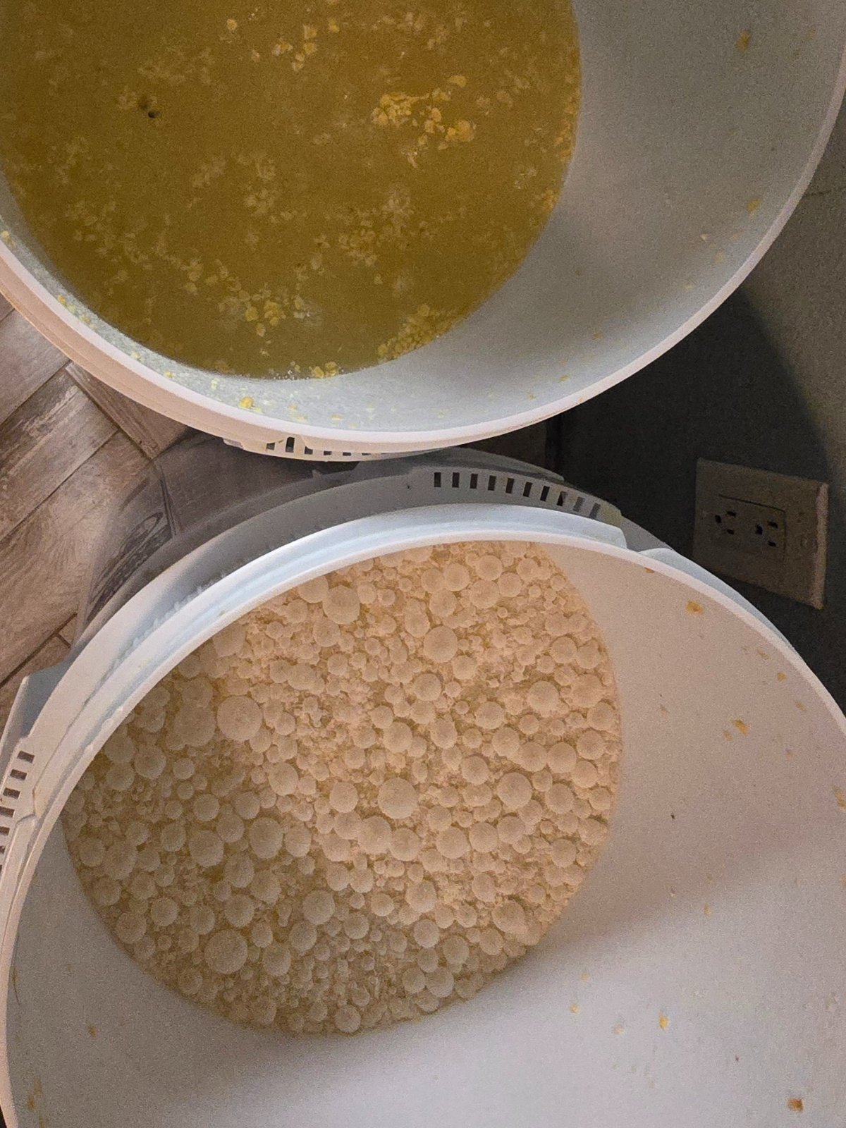

Well, I just got it again on an all corn mash, the 2 buckets are 1 day apart and one has the powdered bubbles with a pineapple note, the other is still smelling pretty sharp and funky.
