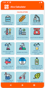

What was left was a scosh over 3 gallons at 140 proof. According to the calculator on the parent site I'll need 2.25 gallons to get it down to 80 proof. which will equal 5.25 gallons of final product, which should last me a while :wink:

The calculator is wrong. If you add the calculated amount of water, you will get less than 5.25 gallons and the proof will be over 80. To get 80 proof, you have to make it up to 5.25 gallons with however much water it takes.
There has been a better calculator posted here somewhere, an app called Distillers Calculators. It calculates 2.33 gallons to add.

I use a phone app called 'Alco Calculator'. You can find it on Play Store. It agrees with NZChris for the amount to add.
It takes a while to get used to it ... most of the complaints on Google reviews have to do with language barriers (app developed in Russia, but has English version) and metric only, but I don't have any problem with it, and I highly recommend it.

That alco calculator app looks the business, cheers!
