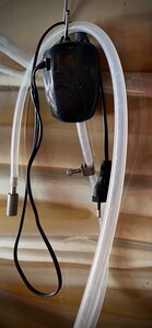

And here's the pic of my pump that I failed to send by PM to you:

Will try it. It's so extreme though the romantic side of oak aging, wood, barrels, and the holy ghost with his drunken angels is lost. But I will give it a go.
Your pump is different from mine. Mine is China in a nutshell, and it's not much bigger than a nutshell either. I'll send you the pic in a PM. It stinks of rubber. I ran it for 2-3 minutes in a jar of water and the smell of rubber was still there the day after. It won't come near my alcohol, but I will let it run for a while to see if the Chateau Michelin dissipates. But I'm not sure I want to make more investments in this area. My wife is on multi-repeat with the "more shit" phrase.

PalCabral wrote: Tue Mar 25, 2025 8:17 am I will let it run for a while to see if the Chateau Michelin dissipates.
Lol. Some folks love a fair amount of rubbery notes in whiskeys. But I'm not sure if it's okay in sh!tty cases like yours. Take care, be safe.
