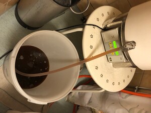

Today I am up early early to start double-mashing for a Bourbon. Early bird gets the worm, not sure what the equivalence is for brewers/distillers, a dram? Anyway, the mashing water is heating up so I can at least take a short break to get the first coffee of the day. Important that, to not do too much work so early in the morning without having a coffee.
Red Diamond Whiskey recipe:
3.8kg Torrefied Maize (51%)
2.3kg Malted Rye (31%)
0.8kg Malted Wheat (10%)
0.6kg Malted Barley (8%)
0.2kg Rice hulls
25L water with Epsom salts and CaCO3.
Mashing schedule:
Mash in 40C.
Beta glucan rest 43C - 30min
Protein rest 50C - 15min
Saccharification rest 67C - 90min or for as long as it takes
Sparge, cool and repeat for second mash.
Add Gluco amylase at 65C. after second mashing and leave mash to cool au naturell for 60 min.
Then cool to pitching temp. Add nutrients (DAP, dead yeast, and Wyeast nutrients).
Aerate the crap out of the wort, add USW-6 and mussel shells. Seal fermenter with empty yeast lock.
Edit: Done with mashing. Long day. Dont you just love when you transfer the wort from the madh tun to the fermenter?
