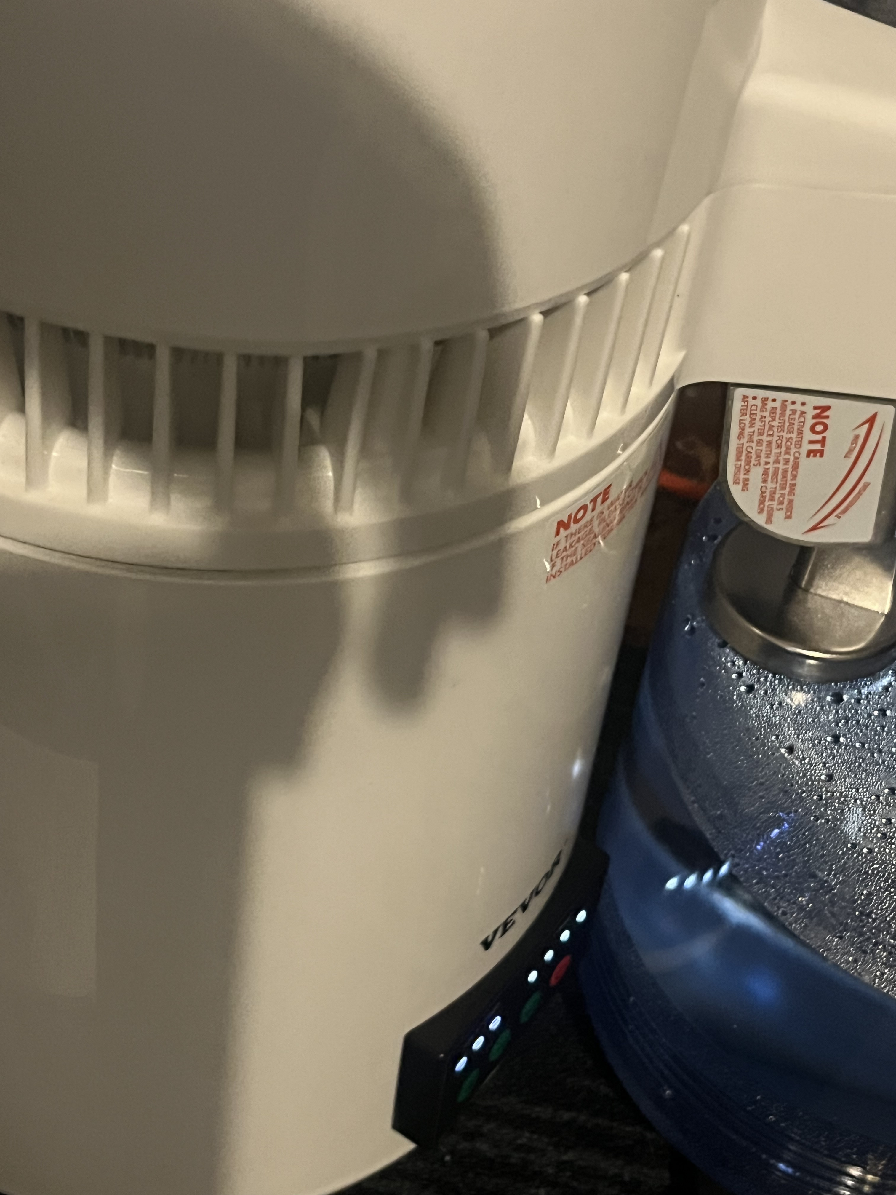

I Recently Purchased One of these, and as I Write this I am doing the First Run to Clean it Out, just with Regular Water, it's just Distilling Water Right now, but I Thought I would Write about this for anyone who is Interested, as I have not Noticed anyone else Posting about these Machines. The Advertisement for the Machine says that it makes Alcohol and Hydrosols also, so it is a Water Distiller Machine, but it is Advertised as Functionable for those Things as well.
What I am going to be doing with it is 2 Things Basically:
1. I am going to Make Hydrosols and Essential Oils by Steeping Plants in Water and Running the Machine.
2. I am going to make Ethanol by making a Distillers Yeast Sugar Mash, and then I am going to be Making what I guess could be Called Tinctures by doing the same Process as with Water, but Steeping the Plants in Ethanol instead.
But here are the Basics of the Machine. The One I have is in Celsius, and it goes to 108 Degrees Celsius Max, and goes as Low as 30 Degrees Celsius, and I can Change the Temperature to Anything in between those. It says it makes 1 Liter Per Hour, and so Far it seems to be Working, it is going Pretty Quickly, it took about 30 Minutes to Heat up and for the First Drops of Water to Start coming out. It has a Timer on it so You can set it to Turn Off after an Hour or 4 Hours or whatever, I have it set to 3 Hrs and 30 Minutes.
It has a Safety Measure where it Turns Off if it hits like 239 Degrees Fahrenheit or whatever that is in Celsius.

Any pictures of the still? It sounds like its a generic copy of an Air Still. There are many many threads here about them and how they run.

they have been around for years and are a cheaper version of the original airstill.
the temp control is useless in distilling alcohol, as you will find out, you have no control over the boiling point of liquids.
however you can control the power level.
it looks like you can split the power from the condenser lid, applying full power separately to the lid.
then use a power controller on the base to control output.
however, it will be a challenge to produce clean ethanol from this machine (same as original airstill)
it is basically a miniature pot still with no reflux ability.
read up on the basic Airstill threads for help on running it.

You’re saying that the Temperature that is Displayed will not always Actually be the Temperature. Sure, but I still should be able to Create some pretty Pure Ethanol. I’m not Selling Moonshine, so that’s Fine. It will Work out alright.howie wrote: ↑Sun Aug 17, 2025 5:56 pm they have been around for years and are a cheaper version of the original airstill.

I figured that when it said it Shuts off if it gets too Hot.
And it should be Fine for Hydrosols, which is the Main Purpose here.

Yes it’s just the Airstill that has been around for around two decades .
No you won’t be able to produce pretty clean Ethanol .
It is a Pot still . The first time yiu run it , the distillate will be rarher stinky and taste like crap with an average ABV of around 25- 30%
You will have to rerun it many times before it gets to anything considered drinkable .
If you want clean alcohol for making tinctures , you really need a reflux still .
But yes it should be OK fir hydrosol . Just be careful that no leafy matter can bubble up and get stuck in the condenser tube and block it .

Mine is the same One as in the Picture, so Yeah, we Probably have the Exact same One. But You said Yours has like a % Power. On mine all I have Noticed is a Degrees Celsius and a Timer, maybe I haven’t messed around with it enough yet to Notice. And Yeah, I thought the Temperature wasn’t going to be Completely Accurate when I Read that it Turns off if it Overheats.TDick wrote: ↑Mon Aug 18, 2025 1:33 pmWell, hell, I'll jump in here.Angelicalist wrote: ↑Sun Aug 17, 2025 4:12 pm I Recently Purchased One of these,

Keep in mind, ours are 750 Watts compared to an Air Still that has 320 Watt heating.
Like yours, mine has temperature control BUT
a. like a microwave, 70% doesn't mean 70% power, it means 100% power, off then on 70 percent of the time. A subtle but important difference.
b. like a temperature gauge on a pot still (that's actually what it is), it really doesn't mean shit.
Except that, unlike off/on button Air Stills, you can regulate it somewhat.
I did my sac - sacrificial - run using a sugar/cereal mash. I didn't let it adequately clear and filled it ALMOST to the fill line.
Two NOOB mistakes regardless of what kind of still you are running.
She puked like a freshman in college.![]()
I have since added a power controller - less than $20 and a VERY simple work around. Just an extra power cord.
Doing a stripping run, just like a copper pot on gas, I run it wide open until I collect 100 ml fores/heads.
Then dial it back to a steady drops or small stream.

I’ll look into a Power Controller, I’m not sure what that is, but it seems Self-Explanatory. I’ll look it up when I get Off Work.
So I’m Guessing when You say You Collect 100ml Fores/Heads, You are saying You Run it and Throw away the First 100ml that comes Out. I’m also not sure what Stripping or a Spirit Run are yet, but I’ll Read Up on it. It seems like You are saying to Basically Run it 4 Times, then Rerun it with a Little under a Gallon in it Collected from all 4 Runs, with the Final Run being a Distillation again of Everything that was already Distilled. I can do that. Right now I Only have a 1 Gallon Carboy though, so I’ll be Starting with Smaller amounts. And I won’t fill it up to the Fill Line, Thanks for the Tip.
I’ll Read Through some Threads about Washes and Things too.
I don’t Drink a lot, but the Past like 8 Years when I’ve Drank Liquor, I’ve gotten Tito’s most of the Time. And I know they are Distilling like 8x or something on Their’s so it’s a Better Quality, so I get the idea of Multiple Distillation Runs from that Perspective. But also I like the Concept behind Bitters, I don’t have a Favorite and I haven’t Tried many. I have a Couple Recipes though, there are these Concepts Called “Oilahuasca” and “Space Paste” that I’ve been looking into.
Any Other Advice would be Appreciated, Thanks for Posting in the Thread.
