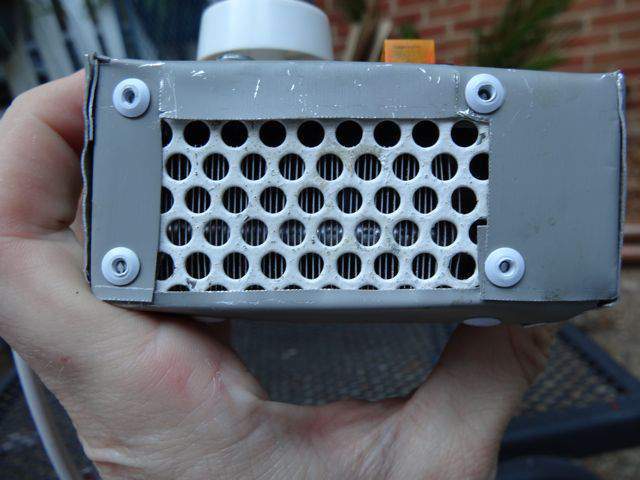

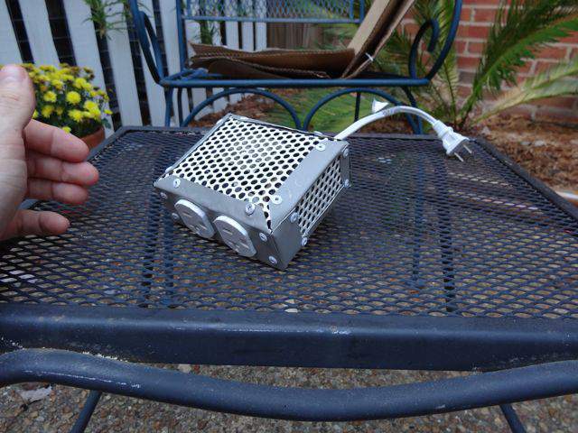

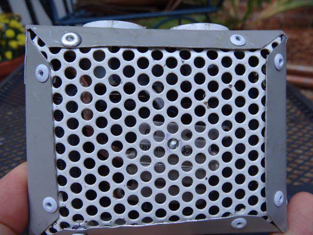

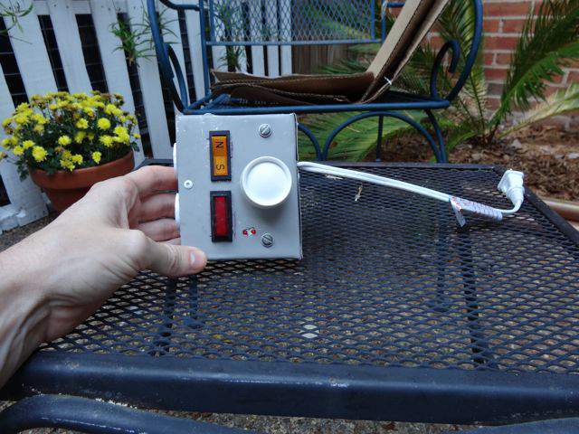

My controller. THANKS guys. Could not have done it without you.
