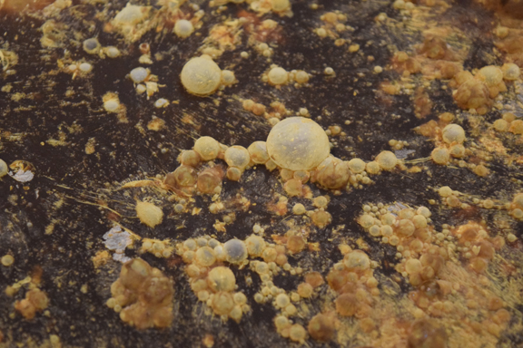

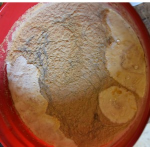

Thanks Dresden, I'll work with it.
The recipe already has 2 gal blackstrap, 4 lbs sugar (called for brown but I only had the "white"... my understanding is brown is white with molasses added back in, soooo... what's the difference when I've dumped in 2 gal molasses?), 4 gal H20, 3 gal dunder, nutrient bomb, and yeast. Already 10 gal. But I can add whatever I want. It's in a 20 gal fermenter ... err... trash can.
I'll add a bit more water, and creep up with the CaCO3. Wasn't sure how long t let it react before measuring the pH, but it looks like you're thinking 10 min. I can stir vigorously each time. I did not airate much a all the first time. I was thinking that since I was already dumping in so much yeast (1 C ilo 2 little packets), that I didn't want it to do much aerobic growth. I also wasn't thinking to grow up a colony first, though I have all the equipment to do that properly for a 5 l pitch. Funny... I know to do that for my meads, but was being lazy for the rum.
I'll give it some attention tomorrow, re-pitch it, and hopefully report back with good feedback.
Here are a few pics... Two of the infected dunder (2 yrs in a bucket in the shop... smells very sweet and tasty), and two of the infected rum wash (also smells very sweet and tasty now).

It seemed like when I first pitched this wash, the infection was winning. Then after adding the CaCO3 the first time, it seemed the yeast was fighting back. Now again, after having added more on top the other day, there's some, but I'm thinking less vigorous yeast action.
By the way, the dunder bucket that I used for this wash, where I pored off all the top mold funk when I added it in... I took a peek in the bucket of the remains the other day and it had a brand new replacement carpet of mold on it, and it smelled nice and sweet. Let's hope all this works out. I've got a 15 gallon barrel to get filling.

In the future, you should siphon off dunder from below the infected pellicle and use that to infect the wash, and do it after about 36 hours of yeast activity to let it get hold -- plus you'll start off with a PH around 4.75-5 so you'll be in a perfect position to let everything run very well. I'll say if you heat the infected dunder you'll only get flavor from what it had, you won't get creation of more esters and the funky flavors that can come from the infections (like creamy or pineapple, for example). If you want to keep going for esters and development of other flavors, you'll want to use it infected, and I think if you wait 36 hours to let yeast establish you'd be okay. There's lots of us using infected dunder, just make sure your dunder is healthy and smells good/pleasant.
I do hope this works out because I think there is an opportunity for this to be a really estery, funky rum. Would love to try it if it comes out, because I think it has lots of promise -- just hard to know with having the 'breaks' that you did and having added the pellicle. Although it does look like a Hampden fermentation!
