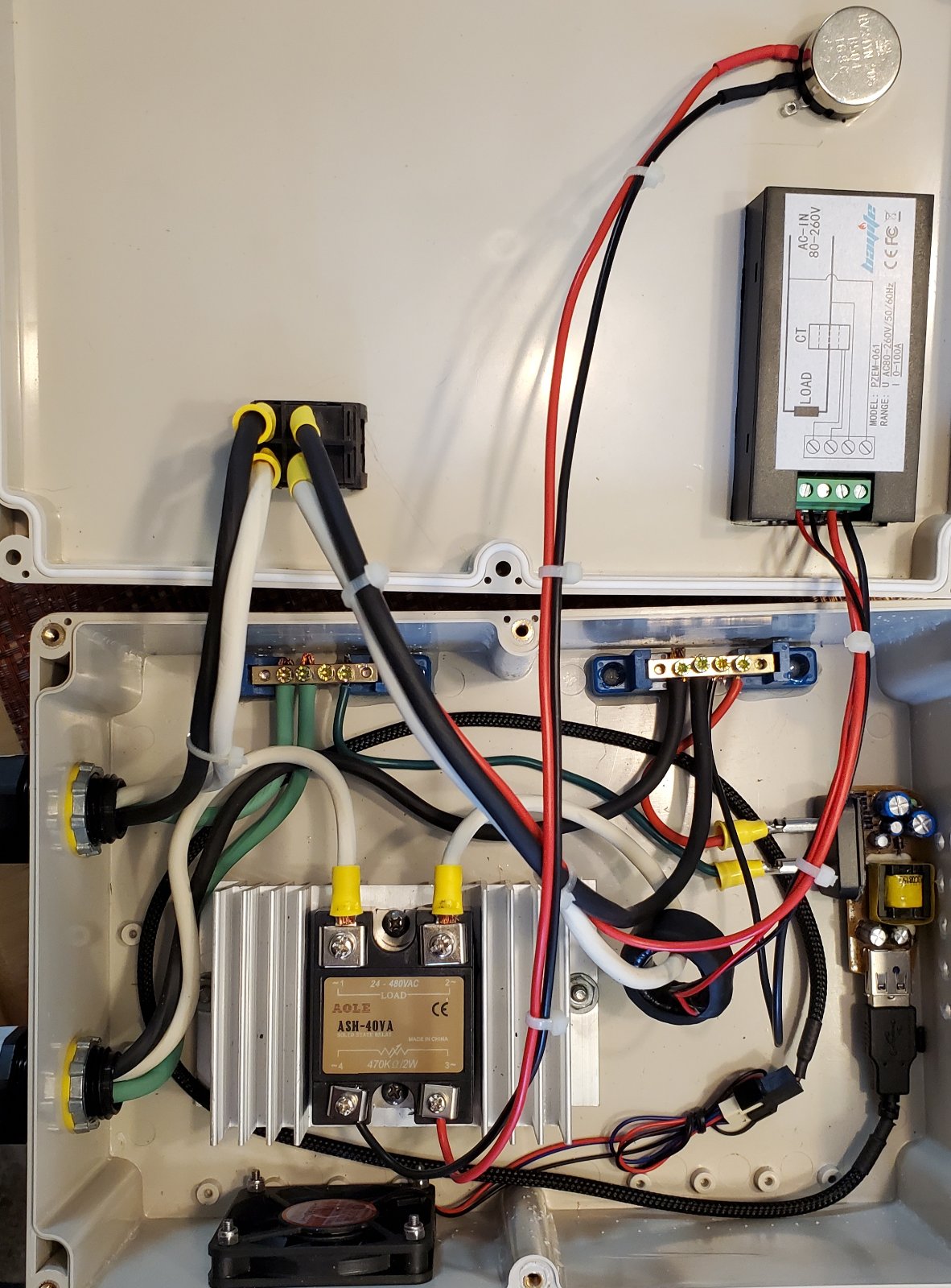

This is what I got going on,i purchased an assembled unit in a locking 12"j-box wired for 120 volt and to drive a 2500watt electric hot water heater. The controller i have(if it's a controller) measures in amps,when i am driving my heater element , before i forget my boiler is 13 gallon stainless steel milk jug with a light and sight glass.2500watt element,and it is very slow not enough horse power for my tastes,i started out and continued to run propane burners and electric seems allot very slow. What i have been doing is using my handheld butane scorch torch. It's got some flame. So i set up my rig in a fashion where i can hit the boiler on the opposite side of the heating element and low, i fire up my torch and with the electric running at 6 amps(it goes up to 14 amps)i start heating with my torch and in 30 maybe 45 minutes i can get the first plate bubbling and going up fast. I then cut my torch and with only electric finish off my run no problem. Without the torch it took almost 5 hours at 10 amps,just to get the first plate bubbling. Way to long. I have also been thinking of induction cooktop,and my other electric. I really prefer electric. I don't like running propane but i have to and i keep 4 different fire extinguisher..my goal is 100% electric.still.when i use combo torch and heater element i get it stripped and hot back set cooking my mash for my next run.and cleaned up in under 2 hours. Otherwise i have spent 7 hours before i got frustrated.with my 2500 watt element.can anyone i.d.what this is called? The bottom photo
- Posts: 10372
Re: Heating Element Control
What gage wire do you have on the input power cord? What about the wire to the element?
Your circuit will see up to 20 amps at full power: 2500 watts / 120 VAC = 20.83 amps.
Any wire run at that power should be at least 10 gage, preferably 8 gage.
Remember, when your SSR fails, it will fail at full power. But, if your household circuit is protected by a 20 amp breaker, it will most likely trip at that condition. So, you have a little security. If your house is wired like most homes here in the USA, then most household circuits are protected to 20 amps although the electrical outlets are made for 15 amp circuits only.
