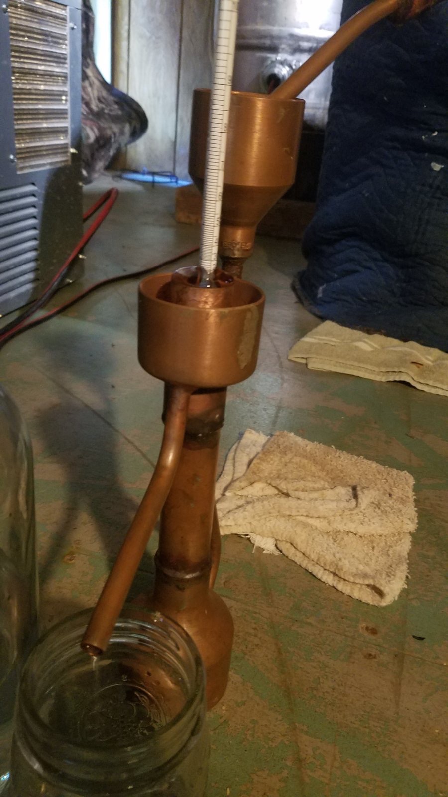

This is my Big Girl. She is very easy to run and has a very large sweet spot.

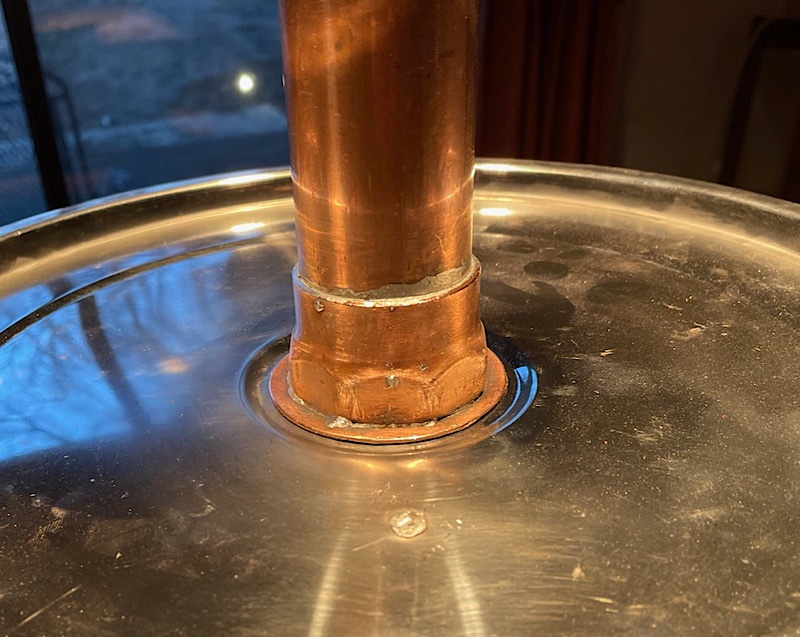

It is a mechanical attachment (not soldered), although I added a flange soldered to the male adapter to seal against the stainless lid. See this detail:
Riser attachment
Riser attachment
It’s clamped up in compression with a few copper washers and a nut on the inside of the lid. Good mechanical joint with a pressure tight seal.

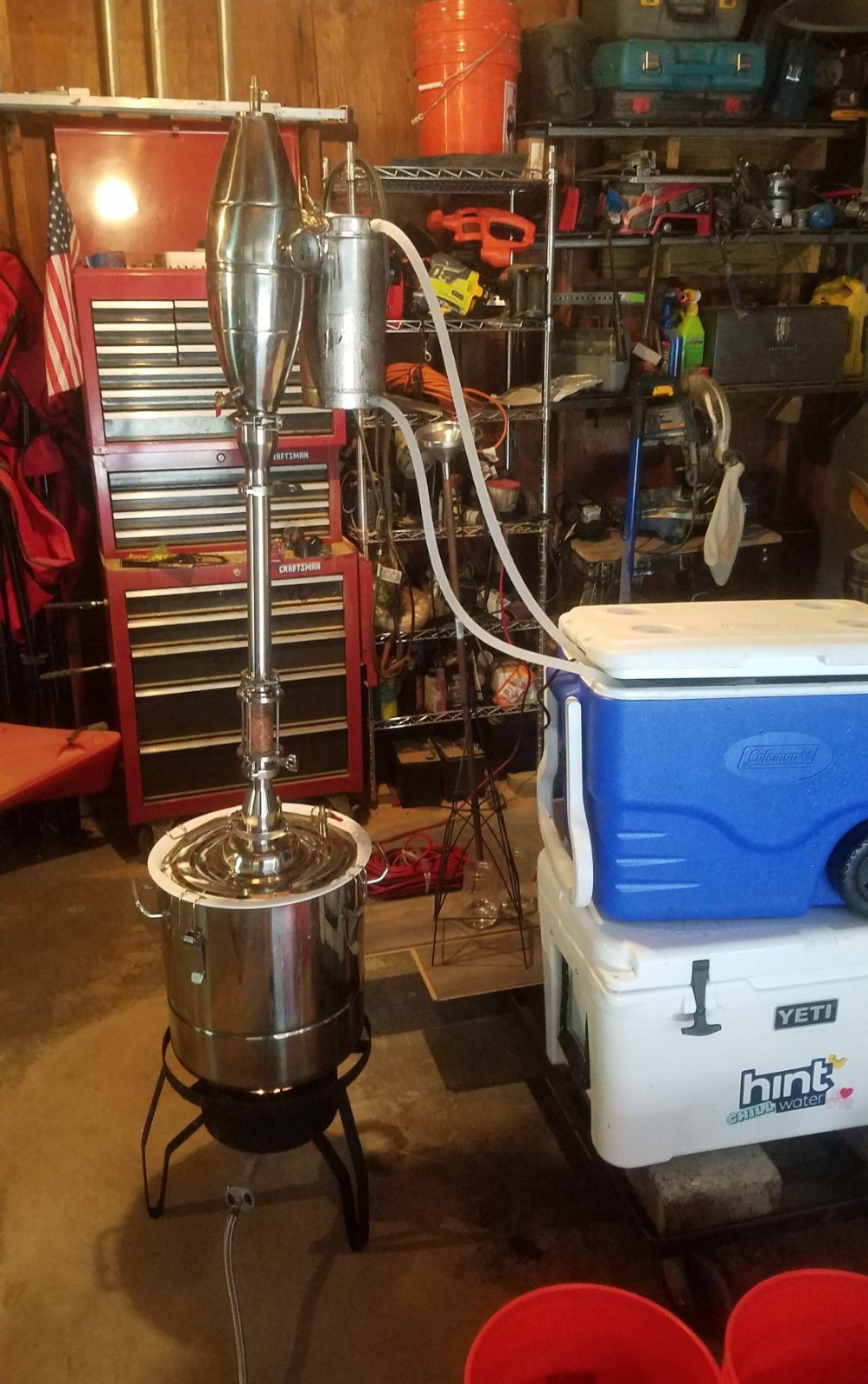

Modified my big girl to run on propane while I buy/assemble the pieces to get her running on electric. Waiting on some pieces, but she's coming along just fine :)

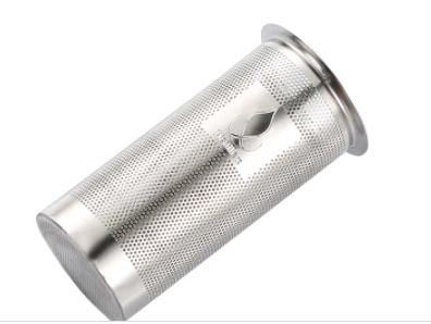

I could replace the copper mesh with a ginbasket. A stainless basket that can hold botanicals (if i am making spiced rum, or infused gin, or infused vodka)
this basket goes into the "pukebox", I got a gin basket that fits its dimensions.
The ethanol vapor passes through the botanicals in the gin basket picking up flavor becuase the basket places the botanicals in the path of the vapor.
I have ordered a sight glass to add to the column so I can add copper mesh/nuts to remove sulfates when I use a gin basket.
so I either add copper mesh, or a ginbasket in that chamber every time i run my still. Hope that helps.
