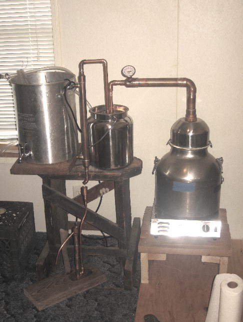

Final still modification, 6g boiler, 3g thumper. Gonna do the cleaning runs tomorrow and Friday....Happy, Happy, Happy !

Think you are happy now ?......... Wait until that rascal starts makin it's music and you are trying to do the 'happy dance' to itsltm1 wrote:Final still modification, 6g boiler, 3g thumper. Gonna do the cleaning runs tomorrow and Friday....Happy, Happy, Happy !

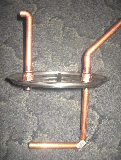

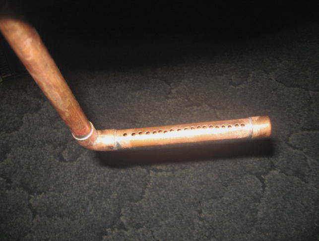

I don't recall who I "stole" this thumper bubbler arm design from, but thanks. It works perfectly!!

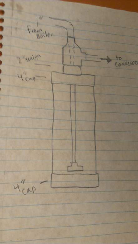

Anyone use a piece of pipe for a long narrow thumper?
I was thinking a length of 4" copper capped at both ends. Maybe 18 to 24 inches long?
At the top, connected by a 2" union, I'd have a coaxial design with a "T" like for a liebig condenser.
The union would allow for filling and cleaning.
Btw, i'm running a 5 gallon pot.

With that length of 4" copper I think I would use it to add a few plates
Lead, follow, or get the **** out of the way!
- Posts: 16571
Re: Thumper?
I think that 4" would cost more then its worth. And could be better utilized as a plated column.
- Posts: 13031
Re: Thumper?
There are a few "stretched" bubble ball builds out there how ever. Reports were positive.
