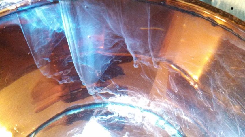

The wife is off, at a wedding planning party, for the fiance of a family member. This gave me a chance to get the thumper body polished, since we got the flange soldered on. We had a little mishap, while doing that. During the soldering, the flange joint got too hot, and popped apart. It was a little sickening, and disheartening. It was one of those uh-oh moments, that make you think your hard work may have been all for naught. We were able to get it back into place, and all is good. Little tip... Clamp that joint down, during soldering, to keep this from happening. The joint I'm referring to, can actually be seen in the last pic, of my last post. She looks nice and shiny, but I still want to take my Dremel, and some polishing rouge to it. There are some scratches that need to be buffed out. The micro-swirls, I can live with, but these I can't. The Dremel also works well to clean up the area around the rivets, as I found out, on the cap.
I also filled it up with water, because I was curious about the overall capacity. 53 cups(3.3125 U.S. gallons). I also did this to check for any leaks. So far, so good. Now, I have never doubted the reasons, or needs, for cleaning runs. The following picture will show why. Even after polishing, and a mild dish-soap washing, this funky stuff made its appearance known. It looks a lot worse in the pic, because its lit by a flashlight, than it actually does. Still, I would in no way, want to drink any of this. Hope you guys are enjoying our hard work, and check another part off the list.
