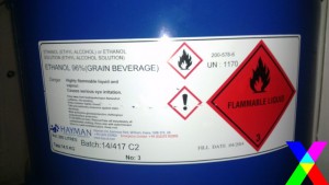

Just looking at the pic, it looks like any of 100 million other carbon steel drums used in industry. If it was stainless, it wouldn't be painted. That'd be an unnecessary added expense, and industry is cheap.
So not a good boiler unless I'm wrong here, but I like the idea of using it as a water reservoir for recirculation.

Yea it looks like carbon steel. And the coating on the inside is more than Likely polyethylene. We have quite a few of those drums at work that we get chemicals in.

BigSwede & Tokoroa_Shiner I fear your probably right. still haven't been home to test it but every thing you guys have said fits its hazy description. I large fermenter it will be. (I know everyone on here hates plastics but it must safe as it previously contained high% ethanol.

got home from work to good news and bad news. bad news is it is in deed magnetic
although naked flame seems to have no effect on the lining but further testing will have to be done.
here is some photos of the lining and the label its self [

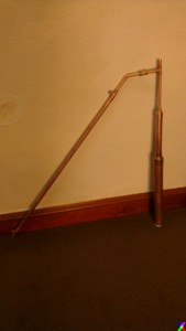

today i finished off the copper potion of the build. happy and excited for the keg to be completed. will post some pics latter.

pictures of my copper

That'll work. Nice!

Looking fabulous!

Nice clean work lets see her sittin on her throne.

Congratulations! Your copper porn is top shelf. Enjoy the hell out of it.
On grounding, make sure that everything made of metal has a connection to earth.

After extensive cleaning runs and a 4 hour vinegar soak there is still a funky(bad) smell on the inside of my copper. Dose anyone have an incite as to why? Can anyone give me advice on further cleaning or point me in the right direction. Its almost painful to be at the final hurdle and failing.
