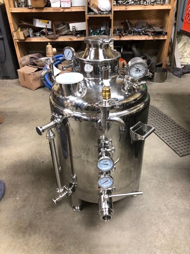

Although I have no experience with steam I have now completed 2 runs on my new 100l jacketed boiler. I’m running a mix of 6gal mineral and 2gal vegetable oil. When purchasing I decided to stay state-side for the boiler so I knew it was safe. Paul at ADE was a huge help and built the boiler according to my needs, the build and delivery were completed in 4 weeks and the quality is outstanding.
Although it’s true that the power adjustments are delayed and not directly proportional, I was able to successfully get through my first two tries.

When I did the vinegar run I timed it at 90 minutes to boil with 5kw put into the oil.
And I believe that ADE does build their own boilers as I had them make mine with an additional offset 4” opening for the column when I mount the agitator in the center.

Yes I can see the weld on the cap is quite different than the other polished welds.
He modified the cap for you.
