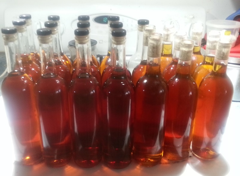

I bottled my last UJSSM (at least since everything is all grain now)
For those wanting a lighter oaking more like a Canadian whiskey, use once used oak.
That is what I did with this batch. This was the result of bottling 3 g that have been sitting on oak.
2 were done making pure whiskey and just over 1 year on oak. The other gallon was one that the heads cut was off by about 1/2 a jar and close to 2 years old (no heads now detected and very drinkable but did loose some alcohol went from 65% to 60% sitting in gallon jug with loose fit cork.)
Was 20 full bottles and one about 1/2 full all at about 45%

bitter wrote: Was 20 full bottles and one about 1/2 full all at about 45%
B
A beautiful site! Wish I was on your Christmas list. ;-)

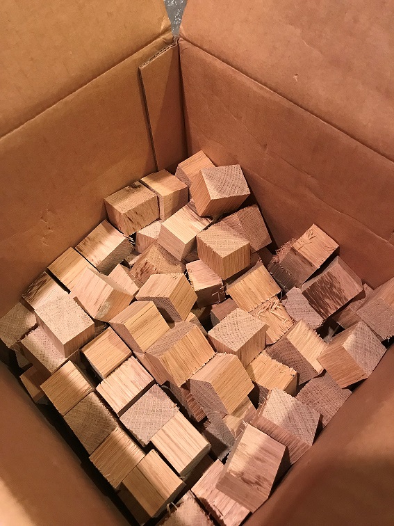

Got home to a treat today.......a cabinet maker friend of mine sent me a 10 lb box of 1" x 1" x 1.5" white oak cubes that he cut up from left over scrap he had from a recent project. Now I just need the wife to take the kids to a movie so I can toast them!!

Johnlj101 wrote:Got home to a treat today.......a cabinet maker friend of mine sent me a 10 lb box of 1" x 1" x 1.5" white oak cubes that he cut up from left over scrap he had from a recent project. Now I just need the wife to take the kids to a movie so I can toast them!!
In the context of wine and spirits and barrels, there is a difference between what a cabinet-maker calls “seasoned” and what a cooper calls “seasoned”. There’s a reason coopers never use fresh wood. Un-weathered oak will give your spirits a harsh, tannic, green flavor.
You can probably reduce this effect by repeatedly soaking and draining these cubes, many many times, over a long period of time. It would certainly work to place these cubes out in the weather for six months or more.

Post by Johnlj101 »
Thanks for the advice...they are sitting out in the drizzling rain now!

Cabinet makers do not use fresh wood either, well none the ones I know. Their wood is dried outside for a few years before using it and they say it's better like this.
It's not int the rain because it's covered, but it's exposed to wind and temperature changes.
Do you think it's enough weathering for us ?
