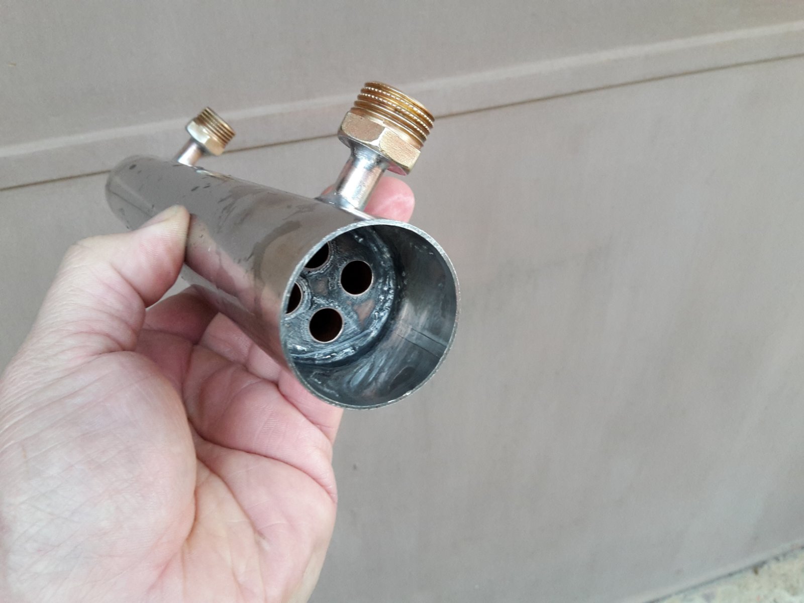

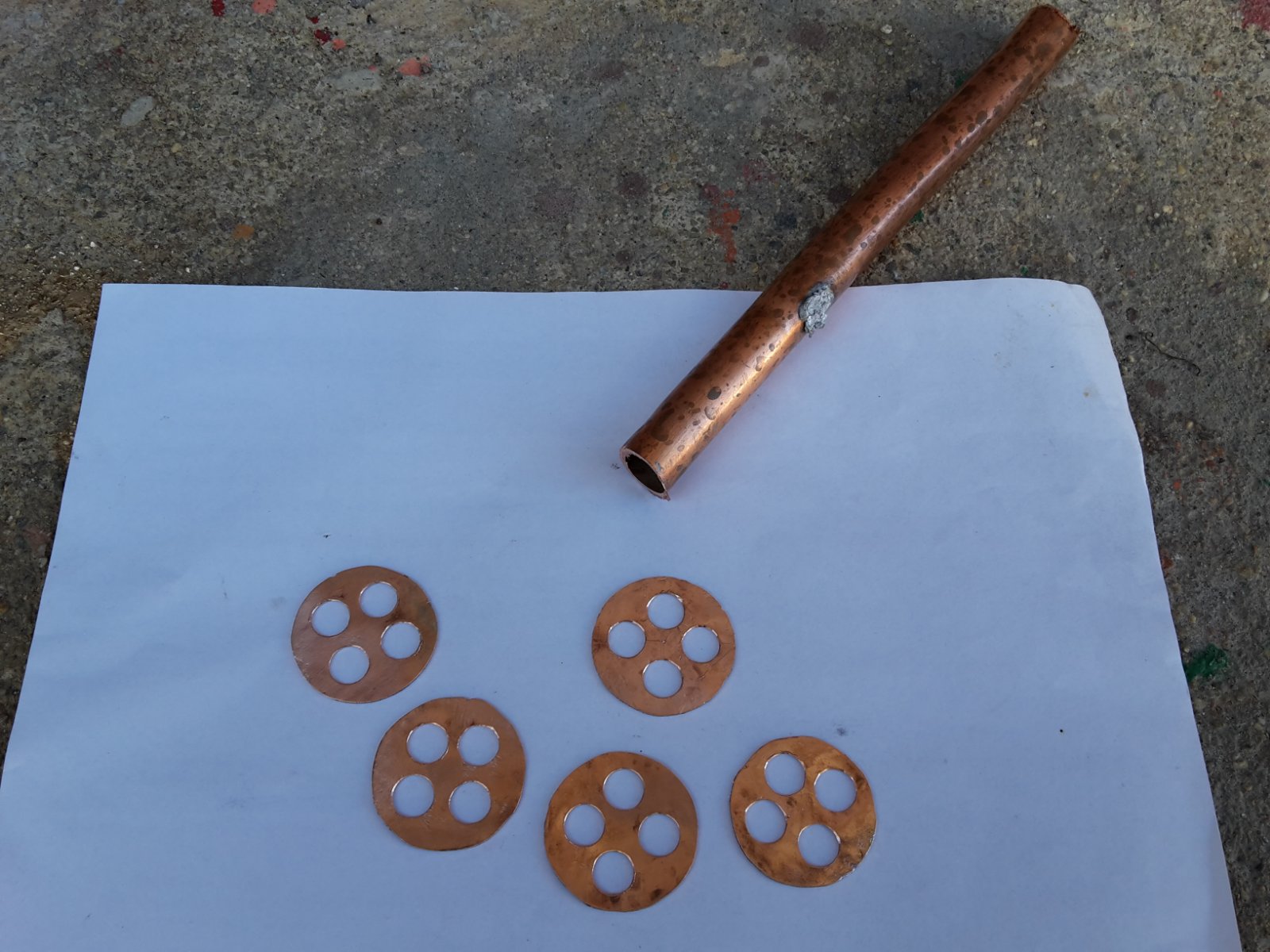

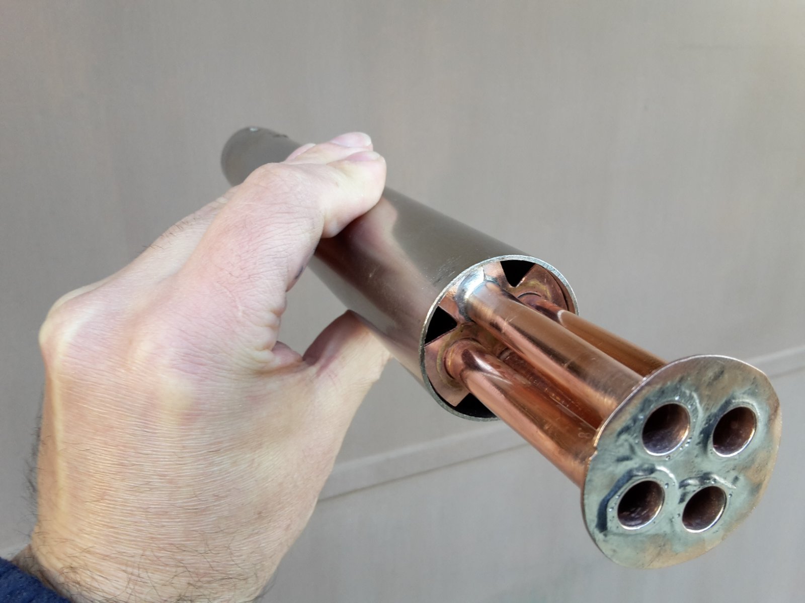

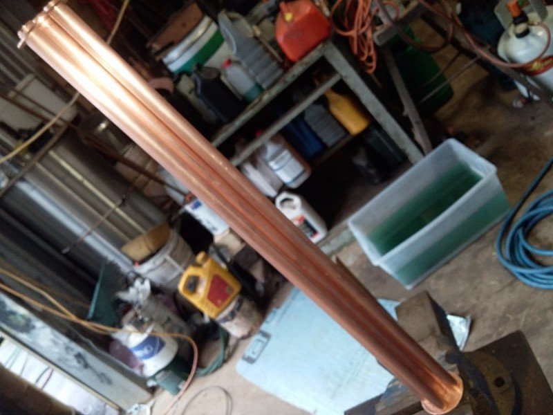

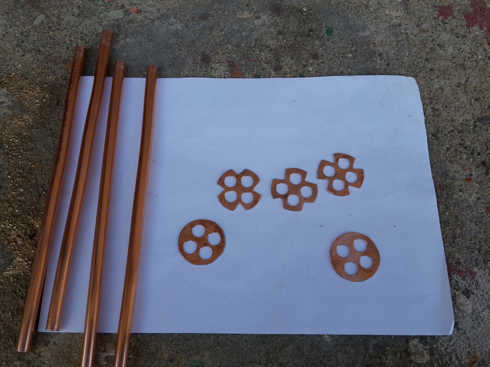

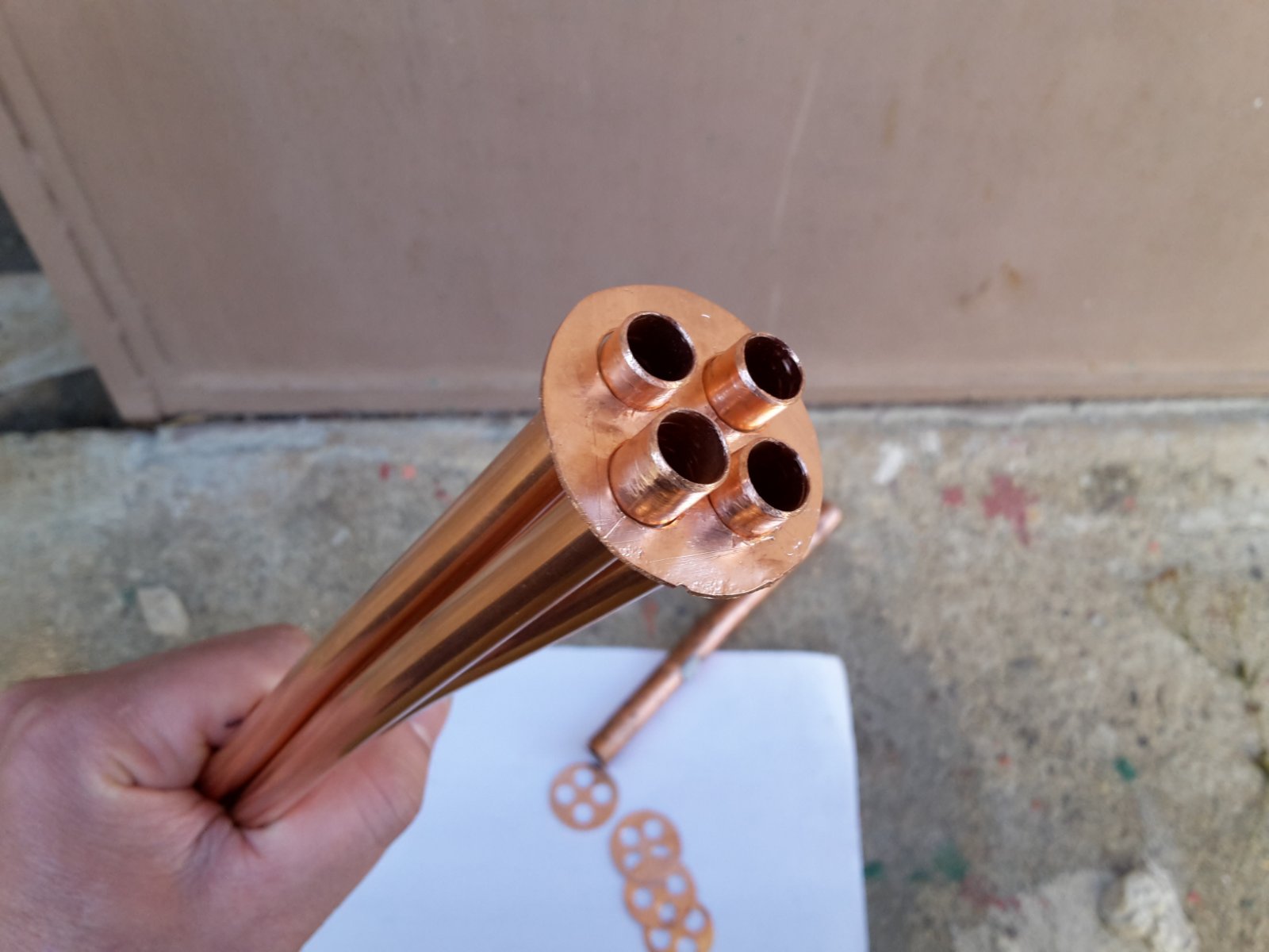

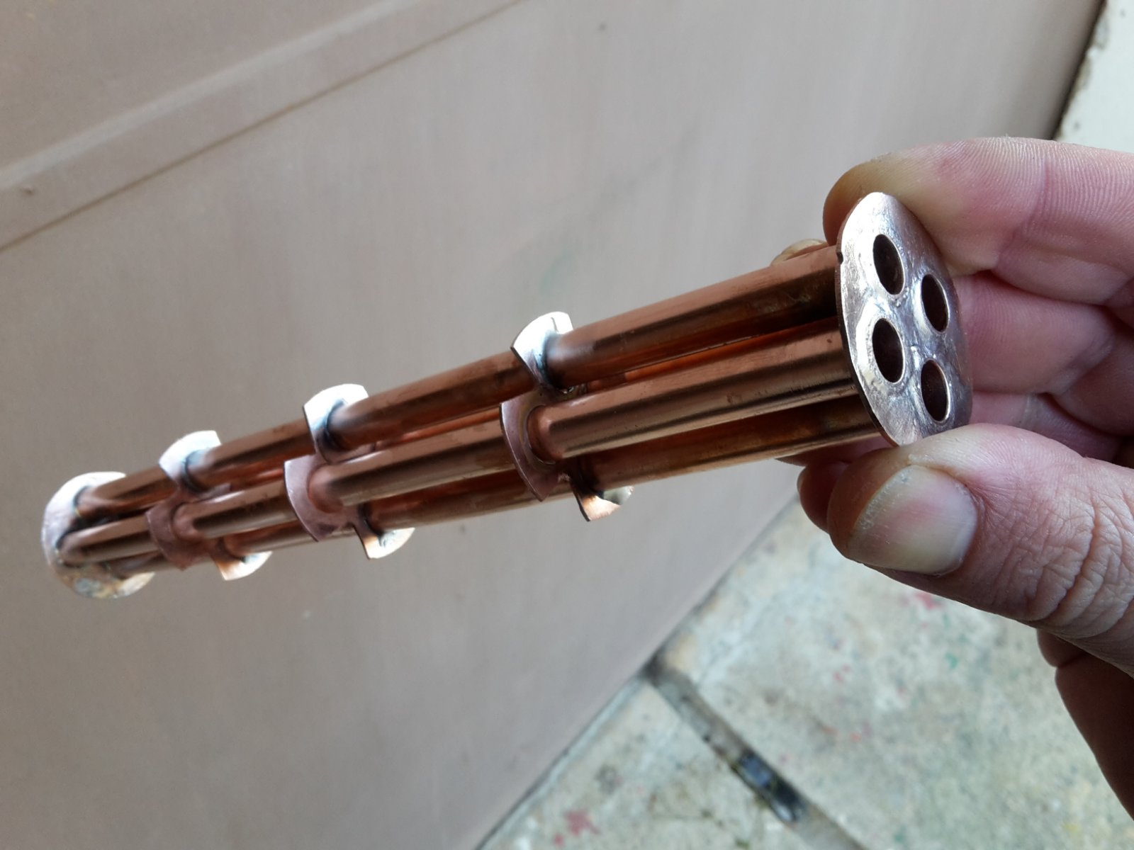

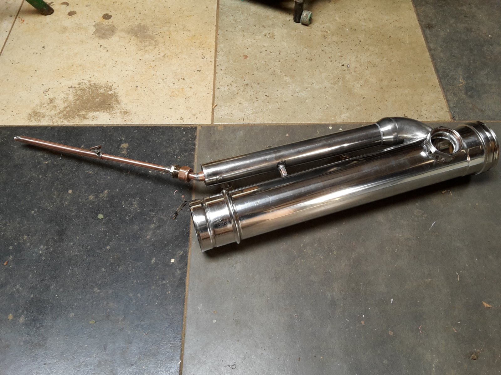

I started the construction, I recovered a piece of 38mm stainless steel pipe (former column) because 30mm was too narrow even for 3/8 pipes. I chose 4 3/8 tubes which fit well. I tried to do my best, I only made a few constructions with copper (I practically took a torch in my hand due to the distillation). The pieces are all recycled from other constructions so don't expect big things. The perforated plates are made from pieces of pipe, the 3/8 pipes have been straightened from the skein.
I had to choose a design for the deflectors applicable to the dimensions, I thought of a simple thing. There are other things that I will do as soon as I have some time.- Deplorable

- Posts: 3387
- Location: Ontario
Re: Shotgun Proportions
Looks good for first attempt.. 1.5" with 4 - 3/8" tube should work good, at least much better than liebig..
I would have done the baffle plates cutout somewhat different.. water always go where there is the least resistant.. the V notch are on the big size and are in the wrong place.. so that means the water will be cooling the outside more that the tubes, and that where the heat is occurring.. for future builder, there should have been a small hole instead of the V notch and 3 - 4 small V notch around the tube hole opening.. by doing so, the water is forced to go along the tubes which would allow the tubes to be cooled better..
The other thing I want to point is that stainless stain with copper baffles have a tendency to leak after a while.. it's mention here by few members who had one of those state that they leak as they crack.. so keep an eye out for that..
Another point that the distillate end tube should been cut at an angle with the pointed end aline in the center.. this cause the distillate to fall toward the center..
Mars

- Demy
- Posts: 3184
Thanks for your suggestions. I made the notches there because there was some space, I think there will be some degree of mixing anyway, there are 3 deflectors in 30cm in length as suggested. In the end where the product comes out I left the longer (protruding) tubes so that they would help the dripping, did you mean this?Mars
- Posts: 3387
- Location: Ontario
Yeah.. it always a good thing to cut the end at an angle and a little longer like a half inch.. you will also need to drill one or two small holes near those ends.. look at the pictures of my built and you will see what I mean.. the holes allow the distillate to flow freely otherwise its possible to form a vacuum..

- Demy
- Posts: 3184
I understand, I looked .... I didn't notice those holes. The tubes are long but I have not drilled the holes. I closed the end with a funnel shaped piece of brass. The product outlet will be open to the air, should I still make those holes?StillerBoy wrote: ↑Sun Feb 28, 2021 5:03 amYeah.. it always a good thing to cut the end at an angle and a little longer like a half inch.. you will also need to drill one or two small holes near those ends.. look at the pictures of my built and you will see what I mean.. the holes allow the distillate to flow freely otherwise its possible to form a vacuum..
Mars
Edit: thinking about it I understand what you mean, the vacuum that the distillate could create in the lower "chamber".
- Demy
- Posts: 3184
Yesterday I completed my small and inexpensive creation. I did a cleaning run and it works great. I think even the small size of a condenser shotgun works beautifully.
