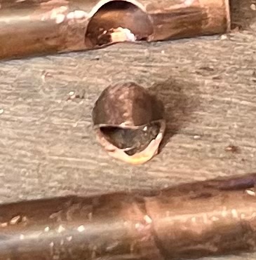

Well, that worked a treat!Yummyrum wrote: ↑Fri Jan 17, 2025 4:43 pm Sometimes you just have to get in the shed and try something .
Sorry no milling machines or lathes , so the fit is not perfect and I made the coupling too short .best I could do with a drill and a file
The point of the exercise was to see how hard it was to hold it all together while brazing .
Turns out the wire twitch method works perfectly and I even accidentally dropped it on the floor and it stayed together .
Alas because the gap between the pipes was too close , the brazing rod started to flow between the pipes .
You ain't gonna get much better than that as solutions go, so let's hope BC gives it a crack and posts photos of the successful job!

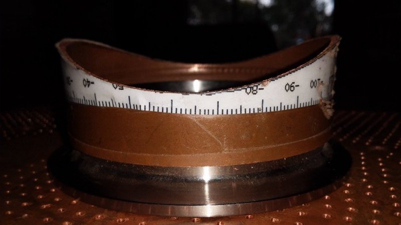

Yummy I'd do them the same way you shape 2 or 3 inch sight glass mounts for a plated column, rough out the curve needed then finish it off to a perfect fit using wet and dry / emery paper wrapped around a piece of copper pipe of the correct size.
With pipe that small you might even be able to drill a tiny pilot hole through the pipe then increase the hole size to slightly smaller than finished size, then cut at half way mark, finish on emery paper as above. This might give you two ends for two pieces, done the right way.
I think you will get what I mean, just a tiny version of the same thing.
I'll try and find a better photo if I can. Edit , found photo, Rub part needing to fit this way once roughed out.
Note abrasive paper around copper pipe........should take no time at all on pissy little pipe like OP is using. Photo is 3
inch on 6
inch on 6

I'd clamp the pipe between sacrificial bits of wood, mark out the width needed and in a pillar drill, using a drill bit the same diameter as the pipe, drill either side of the markouts.
Tiny bit of cleaning up after the drill, done.

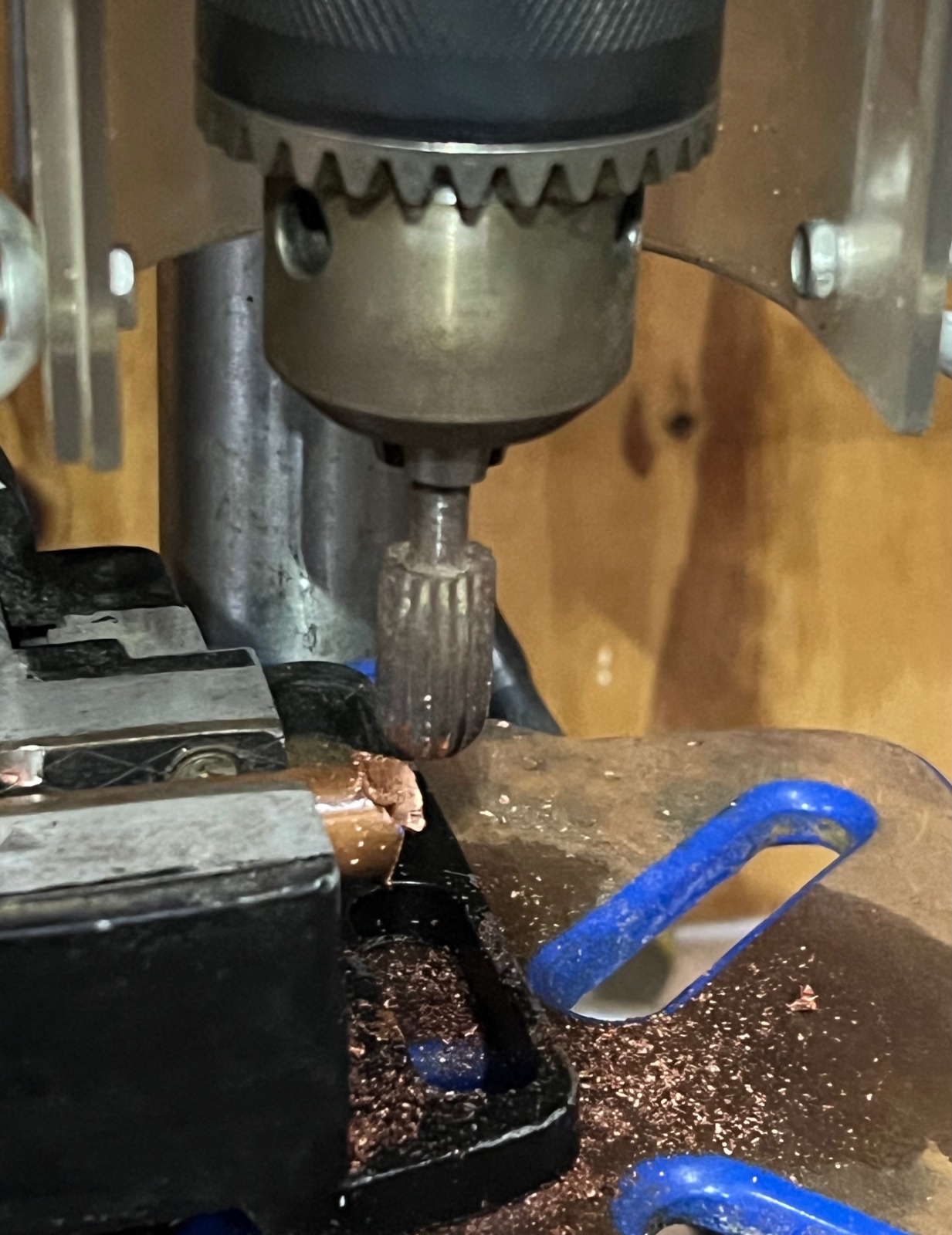

- Posts: 8915
Re: Soldering multiple copper bits needs multiple arms
For full disclosure , I did try increasing size drill bits but as I got close ti the full diameter , it would grab and tear .
In the end I used a pilot hole and a rounded burr bit ( I think that’s its name) to drill through the tube . Then the second hole .
Interestingly the copper wanted to expand outwards ( bulge ) as the drill got close to the middle
I think that is where Mooses idea of a wooden clamp to hold it would be beneficial .
Salty ,I know that sandpaper technique very well from my sight-glass making days .
Thought about it but didn’t try it . As the coupler is the same diameter as the main pipes , the sand paper thickness becomes an issue . Probably should have tried it on the shaft of a smaller size drill bit . ….. that would have worked
One major issue however was heat . Drilling , sanding , fileing copper heats it up big time . I could not hold that little piece fir long before my fingers burned . Ended up holding it with some pliers while filing to save my pinkys .

Maybe use a mixture of regular female short radius elbows and "Copper FTG X C Short Radius Street 90-Degree Elbows"
Notice the fitting is male on 1 end and female on the other.
A little bit of mods such as shortening the mating area on the combination would make a fast 180'

The elbows I got (as a job lot for 50 cents each!) are female on both ends, so using a short piece of pipe as a connector gives a 180° turn with a gap between the parallel pipes of 20mm. Not ideal, but I can work around that....shadylane wrote: ↑Fri Jan 31, 2025 9:45 am Maybe use a mixture of regular female short radius elbows and "Copper FTG X C Short Radius Street 90-Degree Elbows"
For now, I'm going ahead with what I have and finishing the design of other bits that are part of the parent project. No doubt there will be other things to stymie me as almost all of the project is very radical and "breaking new ground".
I can't share details of the overall project, at least at this stage. It's ownership is shared........ but with luck, it will make a great "reveal" essay at some stage!!!!

I decided to test my own advice using 1/2" ID fittings
The top pic is the fittings asis and then I shorted them and finally stuck the two together.
With the amount ground off the fittings, the spacing between tubes installed in them was 9.2 MM.

Re: Soldering multiple copper bits needs multiple arms???
Neat.
Such a pity that mine are female + female, because I can see that if one end was male, with a bit of grinding I could get down to 10mm or a shade less too!
We're clearly tuned into the same "ways and means" wavelength so thanks for sharing your craftiness!!!
By grinding the female orifices down from 10mm long to 5mm long, I can get mine down to a pipe gap of 15mm by following your "shorten it" lead, and I can make that work.
Have a great weekend!

Update on the project:
I have today received 20x "Copper Phosphorus copper brazing rods" as advertised on AliExpress.
Although ANGRY(!!!) that the supplier only mailed 18 instead of the 20 paid for, the rods themselves appear to be (for copper only) an extremely useful step forward over the now-expensive silver-based hard solder rod. The rod melts at about the same temperature as hard silver solder too and fluidity of the melt is very good.... and NO FLUX is required for properly-cleaned parts either!
Why not just use ordinary solder (lead free of course!)?
Sometimes extra strength is needed on a project.
Sometimes close to the joint in question, there may be a requirement to add OTHER components, using ordinary solder. Re-heating the part up to do that might easily damage the integrity of the main joint, if that's done in ordinary solder too?
I have sawn through a test piece joint and am very impressed with the completeness of the capillary effect in taking the solder down through the joint.
The solder seems to be just as hard and tough as the copper pipe itself!
I'm interested to hear if any other Members have had similar success with this stuff.
