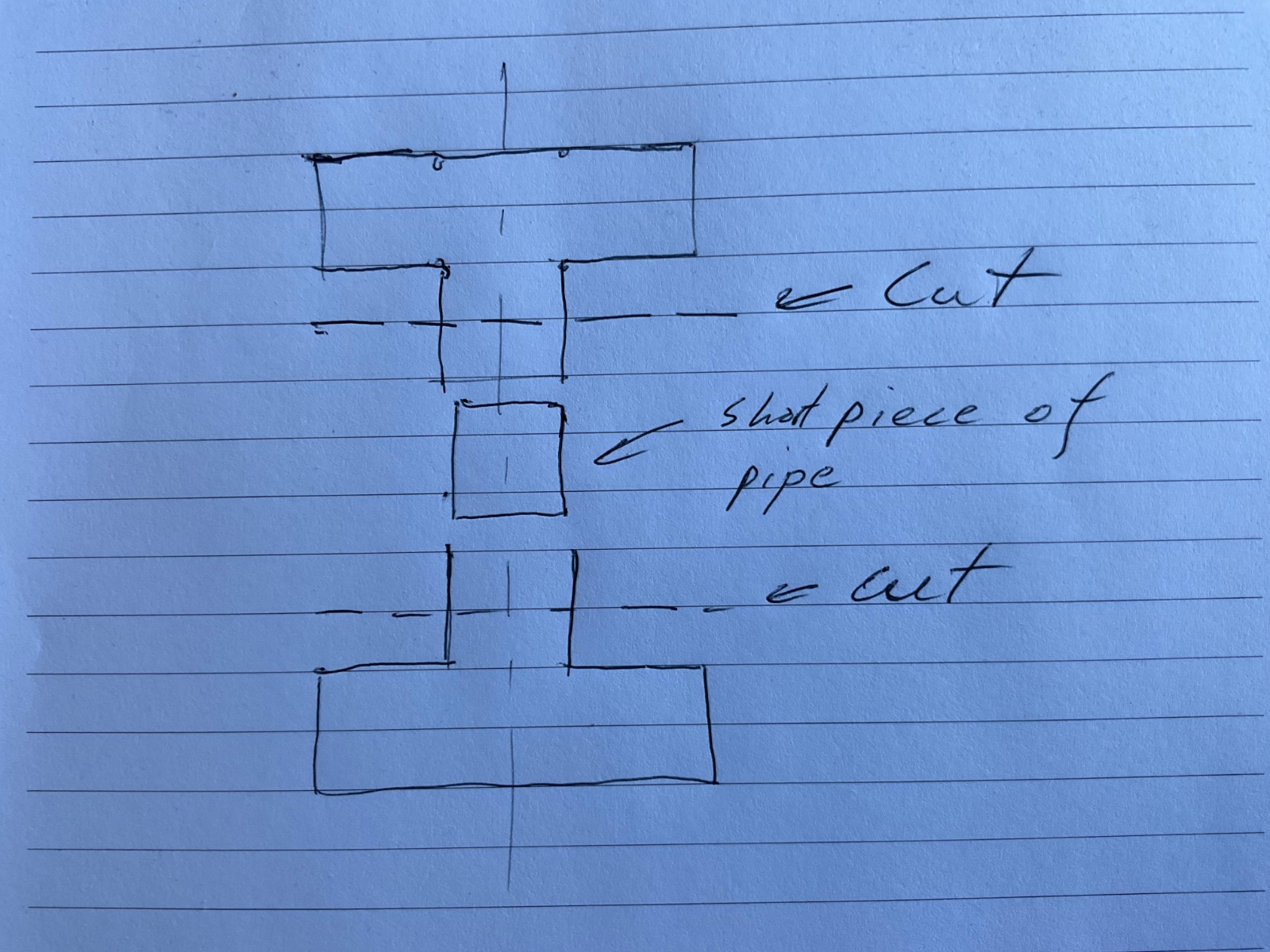

Some aspects of soldering together multiple bits of copper when still-building can become a serious headache because all of the bits have to end up in the correct place, in three dimensions. Even though we might get away with it and have no leaks, the result can look and feel pretty amateur!!!
Building a jig which holds each and every jig part correctly even when heated (with the copper bits themselves in place) in fraught with issues. Particularly time and cost.
So I'm gearing-up for experimenting with "micro spot welding" the bits in place with small, heat-proof retaining welds, prior to hard soldering (and potentially even soft soldering).
Anyone tried this idea and got some feedback to share?

Your drawing looks simple on paper but would be a nightmare to solder. There may already be easier to build designs that do what you want, but you don't hint at what it is for.

... also, is there a reason for the design you have posted? Have you considered alternatives like a coil or worm condenser?

BritishChemist, this is the image you originally posted in the Welcome Center.
To me the drawing resembles a product condenser similar to a Worm, but rectangular, not round. This can be very very easily soldered by laying it flat on a concrete surface (or a steel bench) while using copper 90 elbows instead of the more complicated cuts & open ends needing capped like it is drawn. IF this is a condenser, you would not want the copper pipe to be completely horizontal. You would want at least a slight downward slope on each leg. When soldering copper elbows, there is enough slop/play within the elbows to create this slope very easily.
I really don't see the need for anything out of the ordinary like spot welding or even spot soldering. Just cut the pieces, prep the ends (abrade them), flux them and assemble it. Solder it one joint at a time from top top the bottom and this can be completed very quickly.

I'm not guessing because it doesn't make sense for a condenser or a riser.

I’m also not sure if you are asking a generic question and that diagram is merely an example you have created or whether the whole purpose of this question is to be able to make the article in that diagram .
I have no idea what you might want yo use that for how ever , if it was me I would wrap wire around the parallel pipes and twitch them up tight with a block (spacer) at the other end to keep them spaced (parallel ) . Then you should be able to stand it up to access 360° brazing on each joint . (By brazing , I mean using brazing rods that have about 5-15% silver in them and using an Oxy torch )
Your spot welder might work but I have my doubts . Copper pipe sucks heat as those that TIG weld it can attest to . You might need a very powerful unit .
I’d also wonder about twisting as it cools , throwing the tacked piece out of alignment :
Thanks for your response.
It's not a condenser - it's a part of a new and as yet undisclosed prototype component I'm working on.
The key element of my question is that when many copper components are involved, small and close together, it can be the Devil's Own job to keep them in place to precisely solder them together - hard or soft solder.
With small components heat applied travels all over most of each component and can be difficult to control, so the joints are at risk of being poor quality. My "welding idea" - which I am in the process of pursuing when the kit arrives - is to make tiny, same-metal bridges between items using a highly-focussed heat source so that I can hold either side of each required joint without frying my fingers.

G’day British,
Good luck with the build. I hope it goes well for you, but to be honest, those joins look like a tough ask.
As for the spot welder, well I haven’t used one, so can’t be sure, but struggle to visualise how the tack would work without obscuring the join and making the final job harder.
A couple of thoughts that may or may not be of any value depending on your end goal.
  • You could modify a couple of copper capillary tee pieces and solder them together to create the vertical transition a bit like this:
    That would create a transition with good structural integrity, and would hold pressure pretty well.
    Another option would be to break out the mill (I seem to recall you mentioning you had access to a machine shop) and machine a transition piece out of some hollow bar, which would have a lot more material to work with and get a solid join
Whatever you decide to do - have fun & stay safe.

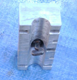

Here is a link to homemade tool to pull a branch connection
tee hook going in to the pipe_small.jpeg (14.21 KiB) Viewed 8089 times
https://www.builditsolar.com/Projects/S ... Puller.htm

Along the path to where I am right now, I'd played around with similar tools. Big issue is that with just a single tang they are unbalanced and apply force that is unbalanced too.
I saw with interest the (very expensive) tool video shown by "quadra" which addresses a lot of the problem, at a price, using retractable, twin tangs. Lots of scope for a bit of hobby-engineer creativity to duplicate the function with a simple work-around to making the tangs engage WITHOUT removing the tool from the hole it's in...... Quite a brain teaser, especially for work on a 15mm tube. But it's set the grey matter pondering!
