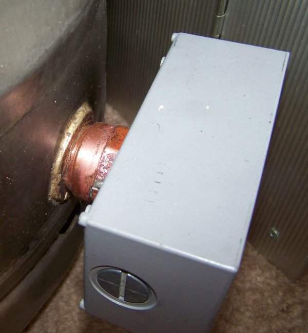

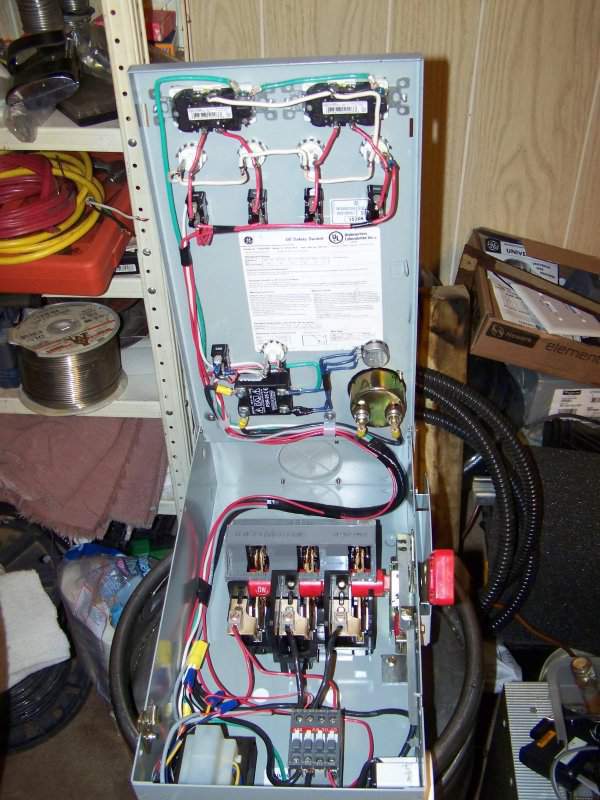

I have a few more pics for ya all. First off I have been working on my boiler. I drilled a 3/8 hole in the keg at the bottom seam for the element to fit in to. Then I enlarged it with a electrical (greenlee) knock out punch 1 1/8 inch. I picked up a 1 inch FIP x sweat adapter. I cut the adapter sweat end in half to shorten the fitting and have maximum penetration (giggle) of the element. Then I flanged the fitting and silver soldered (45 % silver coil solder) it to the keg. I made a few angle brackets and soldered them to the outside of this fitting to hold the electrical box on with, and presto, the keg has a new element.
I have to do the same thing for a drain line.

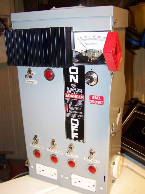

After all the work an being sick with a cold my production on this was slow. I then had a few beers to forget the cold and looked at my still and ........
man that control panel looks like shit.

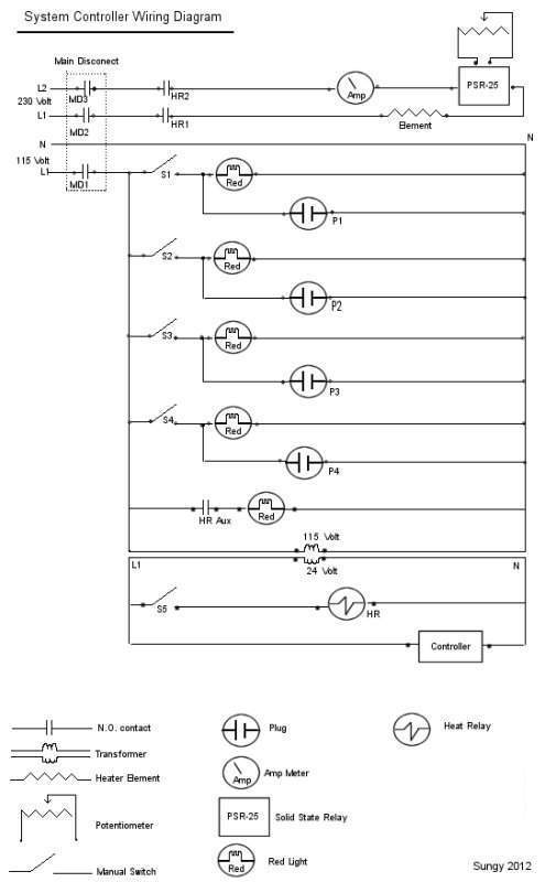

So I redesigned it to incorporate Mulekickers MK5500 phase angle controller and I had a spare 60 amp disconnect laying around to stuff everything into. I built all the original parts into it and upgraded all the switches.
well there she is....picked up the cable to run between the keg and the element ( 30 amp drier receptacle cut down and the plug to wire to the element). I have a roll of 6 gauge wire to feed this power pig with so almost there...hope to do some testing soon.
Edit: so I could add the wiring diagram

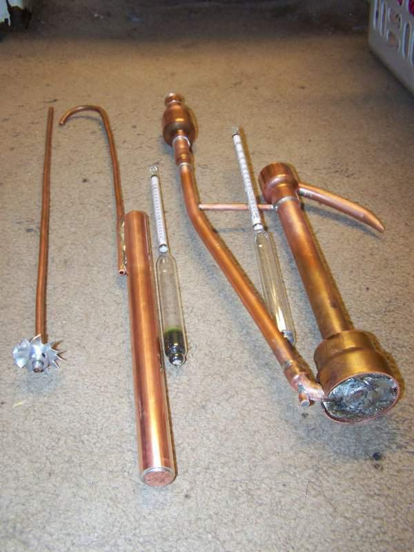

Barney Fife wrote:
The parrot would also benefit greatly from a straight shot of the feed line instead of the coil; the more volume, the slower the response, and you've added volume for no reason other than to have fun with the copper. Simple is better. Less is more.
You are so right. I tried to run with my parrot and found it was not capable of the flow my still can produce. The coiled product line has to much restriction. The height difference between inlet to the parrot and the overflow was also to small causing it to spill out the surge vent holes at the collection cup on the inlet to the parrot. So we ripped it apart and crated a new one. The inlet line is now 1/2 in OD pipe. This new one rips it up. I also filled the bottom for stability.

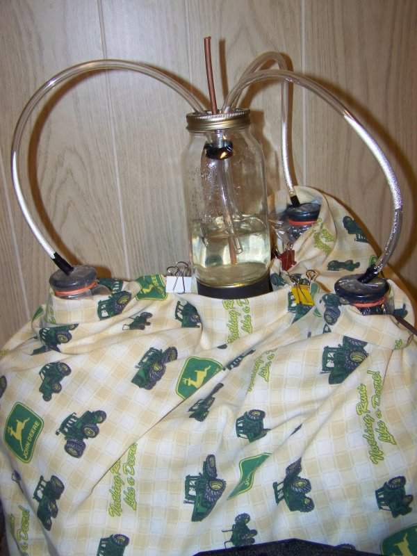

Necessity is the mother of invention ....Grandma used to say. Well I have 40 Gallons of Birdwatchers fermenting in 5 gallon plastic jugs. I read directions again.....Hmmm how to measure SG? Hmmm.
Next beer and it hits me .....lets make a dipper out of 3/4 pipe and solder a handle on. Works like a charm. Pull a sample test my temperature and float the SG float(day 2 at 1.07). The rod with a blade is for stirring daily. Its a cooling fan blade from a ventor motor from a high efficiency furnace (dead motor from a job at work). I had to trim the blades a bit but works.
The airlock setup im using ( note the John Deere blanket.......has to help the fermentin ......LOL)

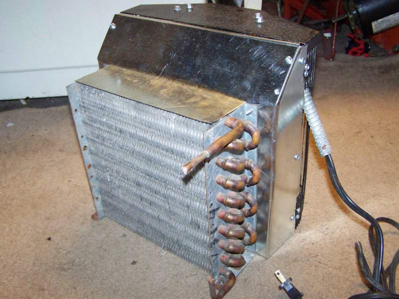

Spent some time with an old buddy of mine last weekend. So after hearing about this project he went threw his junk drawer and handed me a fan, a coil and a fan shroud. Some tin work later and parts from three different units become one.
All that is left to do is split the condenser coil into two coils by unsoldering a return bend and stubbing it out. The 3/8 piping for in and out pipes will be upsized to 1/2. Should be able to handle a lot of the heat from the dephleg. Picked up some rad hose to replace the clear (foggy now) hose from the dephleg as it was to soft when very hot water flows threw it and something about it turning white freaks me out(cant be good).

And if you have trouble with your ferments, it will be the John Deere blanket doing it. You need a caterpiller blanket for proper fermenting :lolno:

watched the video great job! im realy interested in the control gear i might give somthing similar a go :D

Sungy wrote:Now that the perma smile is gone
What, already??
Looks a treat mate :thumbup: you have raised the bar.
Sungy wrote:Now to figure out what to make next.
More mash!
I reckon you need to do a run with a full boiler charge before making any significant changes. I find mine behaves a lot better with more alcohol in the mix. I don't know if yours will, but I'm sure it will act different.
I tip my hat to your efforts.
