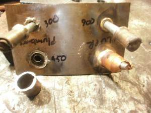

I have done some tests with different types of joints . I attached a copper cap to a piece of 18 gauge stainless sheet. I used Stay silv 45% silver braze and standard leadfree plumbers solder. I didn't have any of the 5%or 8% silver bearing solder to try. The joint with basic solder was quite strong but it did separate. it took a prying twisting motion to get it to fail, a straight pull wouldn't separate the joint, the solder pulled away from the stainless. The silver solder on the other hand held tight and the copper material tore before the joint failed. I will try another tomorrow with Stainless to stainless and see what happens . I will take pictures.

OK , here is the little test I did on soldered connections. Pretty basic actually but here goes. All I have is stay silv 45% silver solder and paste , and regular old H Depot lead free plumbers solder. I took a couple of scrap pieces of 16 gauge stainless steel and silver soldered a copper cap to it and a stainless tube to it on one side. On the other I did the same thing with plumbers solder. I then did a stainless to stainless connection as describe before by drilling a hole and putting a taper on the hole. I used 1 inch tubing to match a collar. then silver soldered one and regular solder on the other one Then went to the press and tore them apart. I wrote the poundage that they broke at on the plate. the only one that didn't break was the silver soldered copper to stainlees connection . The 3/8 shaft I was pushing with poked a hole through it before it pulled apart
. Although it is not scientific it shows me that even regular plumbers solder will hold stainless pretty well. I would guess that a higher quality silver bearing solder , maybe a 5% or 8% would hold even better.
I guess I should mention that the poundage was applied very gradually. there was no impact involved.

Thanks for doing this. How was the force applied, like a lever pressing down on the fittings? I can't think of the right term, not torsion, shear, or tension but sideways force on the ends of the soldered piece?

humbledore wrote:Thanks for doing this. How was the force applied, like a lever pressing down on the fittings? I can't think of the right term, not torsion, shear, or tension but sideways force on the ends of the soldered piece?
Hydraulic press with a load cell. I drilled holes in the back of the small plate and pushed each connection with a 3/8 inch shaft . On the 1 inch collars I pressed directly on the collar. Just watched the dial and when I heard the POP! I wrote down the pressure.

So the force on the rod is from behind the plate pushing the fitting away from the plate?

humbledore wrote:So the force on the rod is from behind the plate pushing the fitting away from the plate?
Yes. The regular solder is pretty strong but the silver is substantially stronger. Got a definite POP when it let loose.
Corene, is the 45% silver solder you used in the form of a brazing rod and what did you use to apply it - oxy/acetylene, or some other? Could you explain the process for a novice?

We get our silver solder from the welding supply here. It is Harris brand safety silv 45 and use Harris safety silv flux paste. It comes in a 3 ounce roll of 1/16th inch wire and cost about $30 dollars an ounce pretty expensive stuff but it is very strong I used less than 1 1/2 inch of 1/16 wire to do all the connections in the pictures, but a nice tight fit is required. I used Oxy-Acetylene torch as the melting point is 1125 degrees. Both surfaces must be very clean, I use emery cloth to clean with. I flux well and apply the heat slowly and gently moving constantly to avoid getting a hot spot and burning the flux or overheating the stainless , either of these won't let the solder wick into the joint properly. Don't directly heat the solder, keep it in contact with the base metal and let the heat from the base metal melt it. You will know when it is close as the flux turns from a thick paste to almost a clear watery texture. I have seen others talk about a silver bearing solder also , It does not have near as much silver , I think I remember 3% and 5% I am betting it would be a better choice economically and hold just as well. I will look for some here locally and give it a try. In truth I am not that experienced in solder, I do it maybe once or twice a week so this is good practice for me too. Most of our stainless is done by heli- arc or mig wire.

Bellybuster (and others on other forums) have suggested Harris StayBrite 8 solder and Harris Stay Clean flux. The solder is 8% silver, melts between 430-530F This wide melting point allows it to fill better (they say on the data sheet). I used Oatley Silver Solder on a locknut I soldered on an old beater keg. It is some smaller percentage silver, like 2%? And I used some generic flux for stainless, and MAPP gas. It was a pain to get on there, and ugly looking, but I took a hammer to it and beat the crap out of it and it would not come off. I was thinking to get a 1" pipe (it's a 1" locknut) to put in there and try to wrench it off somehow. I posted that on a thread and I had the usual haters saying it was a bad job, would pop off with a screwdriver, don't trust it, etc. But for me, I am satisfied.

humbledore wrote:Bellybuster (and others on other forums) have suggested Harris StayBrite 8 solder and Harris Stay Clean flux. The solder is 8% silver, melts between 430-530F This wide melting point allows it to fill better (they say on the data sheet). I used Oatley Silver Solder on a locknut I soldered on an old beater keg. It is some smaller percentage silver, like 2%? And I used some generic flux for stainless, and MAPP gas. It was a pain to get on there, and ugly looking, but I took a hammer to it and beat the crap out of it and it would not come off. I was thinking to get a 1" pipe (it's a 1" locknut) to put in there and try to wrench it off somehow. I posted that on a thread and I had the usual haters saying it was a bad job, would pop off with a screwdriver, don't trust it, etc. But for me, I am satisfied.
Might just have gotten too much solder on it, the 8% harris sounds good to me. Screw the pipe nipple in and tap on it see what happens.
