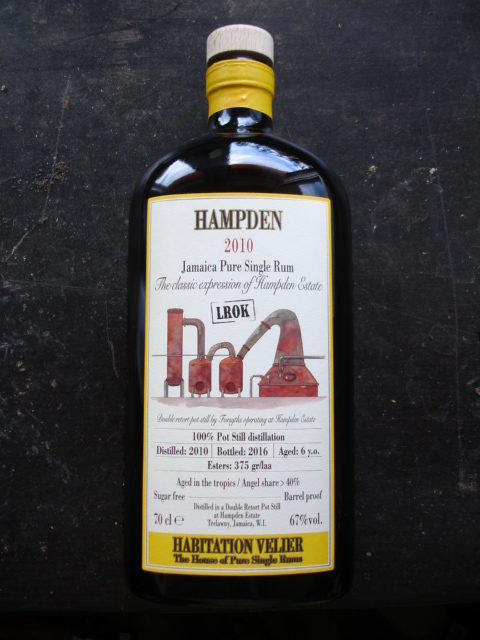

I did a lucky shoot at ebay:
6 years old, pure molasses, 100% potstill distillation (with thumpers), 67%abv, 375gr/laa esters (probably this means gramm per hectoliter pure alcohol), aged in the tropics with more than 40% angels' share, no sugar or coloring of course. And nada nothing empty words like "navy" btw...
I am curious, this is for me an inredible interesting tasting.
After the tasting I think first it's a great Rum, secondly I have learned something, thirdly it seems reachable, fourthly I won't pay so much money again when the bottle is empty.
The flavor: The infection flavor is a mix from butyric esters and acetic esters. Perhaps propionic esters too (but they are similar to butyric esters). No lactic esters. This is interesting, because it concurs with the Arroyo papers (he doesn't write anything about lactic esters) and it's different from the other (less or not infected) Rums I know, which have a lactic ester aroma IMO. Perhaps this means that an old dunder will be mainly a butyric acid dunder. The acetic acid is probably simply added to the wash (Arroyo describes sugar cane vinegar addition to washes), it's not the result of a dunder infection. I think it's important for a high ester Rum producer to find the balance between butyric and acetic acid esters. The butyric esters alone smell like bubblegum, the acetic esters alone like glue. But mixed (I don't write connected. I tastes simply mixed, not magically chemical bonded), if it is well balanced like the acid and the sweetness in a lemonade or like the sweet and the sour in Asian cuisine, you can taste there everything you want, banana, mango, pineapple... But it's an illusion. A pleasant illusion. Actually now I like the idea of the Pure acids and ester production thread a bit more. It seems very logical: The main acids in the high ester Rum production are butyric acid and acetic acid, and the main alcohol is ethanol. So the main esters are ethyl butyrate and ethyl acetate. This is what it smells like. And the mix is very complex and interpretable. The other esters, perhaps built from other acids or other alcohols or perhaps reactions of two esters or of an ester with the wood are not identifiable for me. They may play a small part. But actually it looks for me, that this is the secret of a complex high ester Rum. Simpler than I thought. But I know there are many reports about very complicated esters, which are allegedly indispensable for a good Rum. I don't trust them anymore. Or at least their value for practice is much lower for me now.
So I cannot decide if I am either satisfied, because it looks like I am not only on the right track, but I am almost there, or if I am dissapointed, because there is not really a new world opening for me with such a Rum for so much money.
The taste: The taste was not a real surprise for me. High quality of course. 40% angels' share have an effect too: It's smooth at a higher proof than I drink normally. And the molasses taste is intense without downsides like tails. For me the sweetness is enough. Definetely better quality than a Rum for half the money.
Normally a bottle costs 100€ here. I got it for 2/3 of the price. Still much money. But first it's hopefully a good Rum and secondly I want to know how a such high ester and high quality Rum tastes like. Ok, this is not the highest ester Rum from Hampden, it has something like 2/3 of the maximum one.6 years old, pure molasses, 100% potstill distillation (with thumpers), 67%abv, 375gr/laa esters (probably this means gramm per hectoliter pure alcohol), aged in the tropics with more than 40% angels' share, no sugar or coloring of course. And nada nothing empty words like "navy" btw...

I recall that people buying the feed molasses were disappointed to discover that it has propionic acid in it — but it sounds like that might be a good thing?

I don't think the amount is such high, that it is smellable. Because propionic acid is similar to butyric acid and has a similar ugly smell. The esters you get after adding alcohol are only smellable if the acid was smellable before too. Does someone have feed molasses at home smelling like vomit or sweat? I don't think. And I don't think animals would eat it, if it smells ugly. So the amount of propionic acid has to be low or noone will buy the molasses.

der wo, that bottle looks like a nice find. I wish I was your neighbor.
