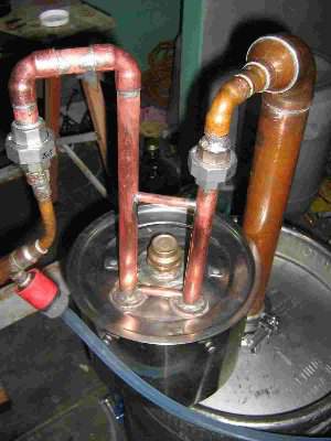

Go gentle, it is still a work in progress. :wink:
Pot still version
With the thumper attached!
Just the thumper unit
I have a reflux version that uses the same kit, but Im still working on it.. :roll:
And yes, I will pickle the brass tomorrow. and its only temporary, I have a SS version but I need to get a better solder flux.
Otherwise, the same liebig is used in all of the versions, it has a coil of copper wire inside the entire length to convert it into a Allihn / Graham condenser. Really makes a difference. :ebiggrin:
I use a 50L Keg and a dual 8000 btu propane burner..
Run the thumper today for the first time.. really happy! :ebiggrin:
