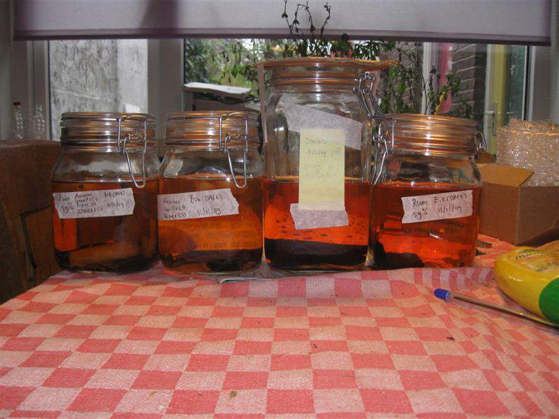

I just started experimenting with oaking, but will share some very early results.
The big one is from the 3th of november, the smaller ones from the 11th of november. All are on 2 pieces of oak I cut from a piece of unfinished oak strip. Pieces I put into the likker are 1 cm x 2.5 cm x 3 cm (0.4x 1x1.2 in inch)
EDIT: I toasted them in the oven, making sure the temperature stayed above 360 F for about an hour or so till they turned dark and smokey and I liked the smell coming off very much. The ABV's are 59% for the small ones and 65% for the larger one

Those look good Daantje, especially that taller one. How much likker is that? My looks like pee but it's only been three days but I can't see it getting rich and deep. I guess I should char up a couple of pieces; I went for a deep toasting, not quite knowing what I was doing. Thanks gents, bd.

The bigger one started out as 1.5L, but it being one of my first batches I could not wait and drink some, so now its about 3/4 L. Mine take colour pretty quick, it got this color in about 3 - 4 days I think. It may have gotten a little darker, but not much. Will leave it for a while to see what happens.
I think it is strange that there's a difference in colour between the right one and the two left ones. They are of the same batch of rum, the right is only on oak, the two on the left on the same amount of oak, but with pineapple, vanille, pepper and cinnamon and they seem quite a bit less dark.

Yeah that's why I posted; I figured it should be quick to colour. My is holding pretty well the same. Looks pretty in the jug but when I pour some into a shot glass, it's basically clear. So I threw my other sticks into the oven and went a little higher in temp like you did. Seems to be a balance between colour and maybe over oaking to get the desired colour. Live and learn. Cheers, bd.Mine take colour pretty quick, it got this color in about 3 - 4 days I think.
