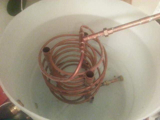

A shoutout to a previous post that helped me with my still.
Thank you myles for your great post. It helped me when I realised my 3/8" diameter copper was going to be too restrictive.
I remembered seeing your pictures and I ended up building a worm with two coils.
I am just getting started and work like yours is such a help.
Here is a pic of mine. I love that plastic bucket.
