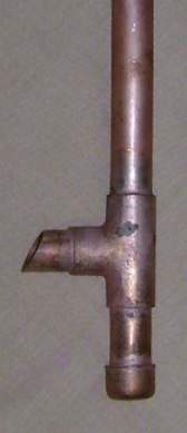

My racking cane. Seems to work okay.
Only use this when I run ferments in a keg. My main fermenter is a plastic HDPE barrel with a drain tap on the side, near the bottom.
If I was doing it again I would do the intake port differently. Extend it 50-60 mm and seal the end. Then drill a bunch of large holes in the top side of it.

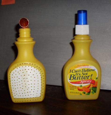

I did this:
Completed, thus:
I used 1/2" SS tubing that was discarded from a job I worked on. (a gas fired power plant, the tubing was for the plants 'smog device', using ammonia gas. the caps came off the end fittings, and because NO contamination was allowed, the tubing was tossed. I got about 30 ft of it.) I welded the 'cane with tig amd have a frame that supports it over the fermenter. It works fine, -hey-

I do not understand these "big footprint" shower heads and butter bottle cane ends. All that seems good for is stirring up the trub at the bottom of the fermenter.
