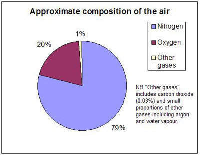

If air works by being pumped through spirits then it's more about oxygen and nitrogen. It may be a chemical reaction or simply the shuffling of molecules due to agitation.
- airhill
- Posts: 307
- Joined: Fri Jun 05, 2009 7:42 pm
- Location: Fourecks
Re: Stripping off flavours with CO2
If I had to put money on it it would be oxygen
(if it wasn't for the nitrogen we'd be a ball of fire)
