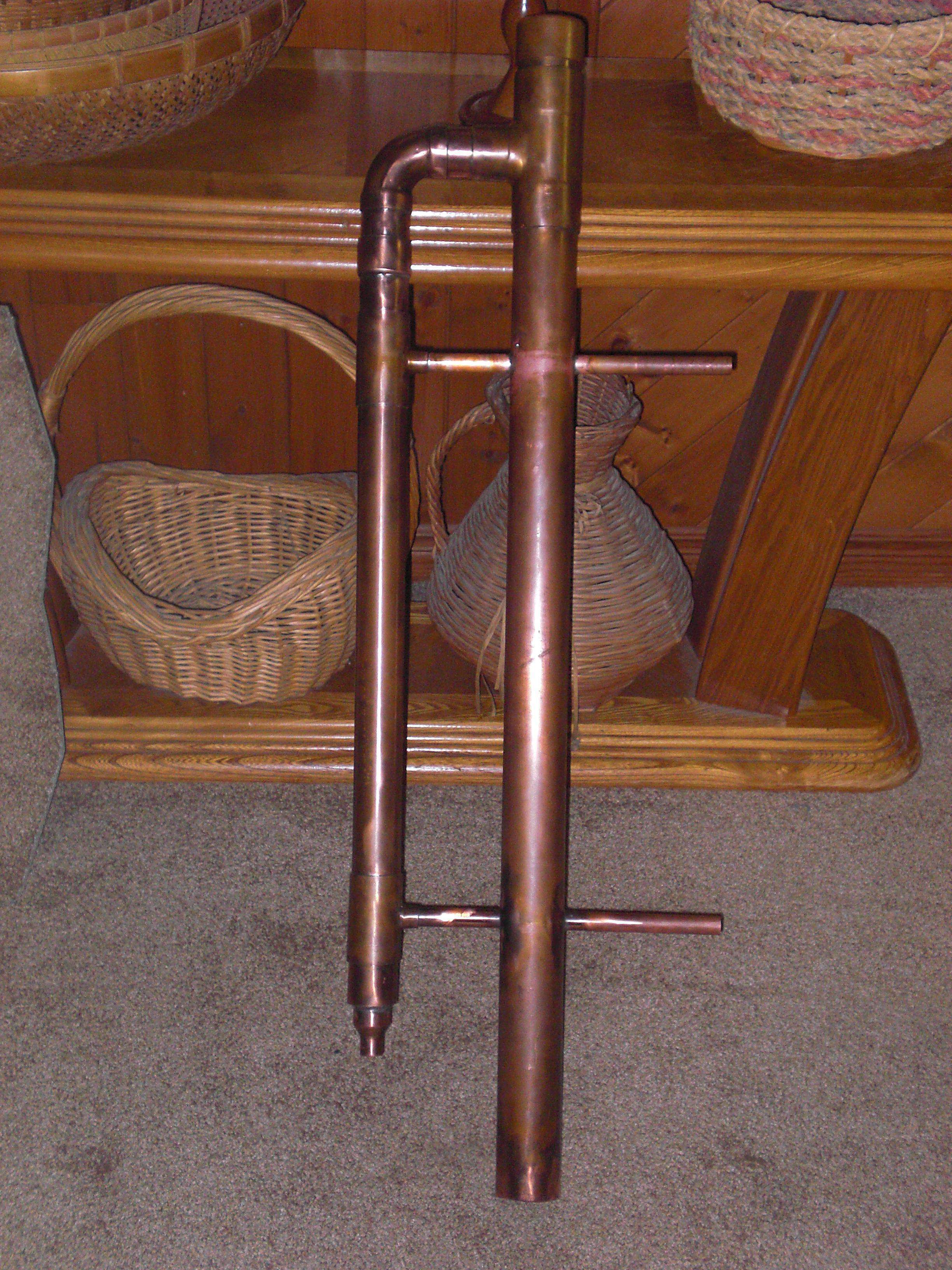

i have been pot distilling for about seven years now and have just built my first reflux and coincidently came across this site.by the looks of it i have jumped the gun and built myself a less then worthy still head from a design i found online. i haven't run it yet and i'm not sure i'm even going to run it as a reflux still until i do some mods to it????
i have been snooping around here a bit and come to the conclusion that removing the bottom cooling tube and moving it up just under the top one would be the best thing to do other then completely redesigning the whole apparatus?

Nice copper!
I was never a big fan of that type of design as it destroys the thermal gradient in the column that produces the high abv you are probably looking for. I'm not saying it won't work, but it may not be as efficient as you would like.
IMHO, the pipes going through the column don't allow you to add any packing material which is crucial to getting the higher percentages.
I haven't tried it yet, but Big Al's (the fish store) sells the ceramic packing which they use for salt water filtration which looks real similar to the packing others have used.
As a guy who reconfigures his still every couple of batches, (I'm sketched a few ideas for the Mark 9, soon to be posted), I would try it out first, it will produce something!
If you are not too impressed with the results, then ditch the lower cooling line (just disconnect it) which in this design requires some cutting.
PS. If you can blow through your column, it won't blow up. However depending on how much heat you use during distilling you might get a column surge which blows your wash through the column and makes a real mess. That said, you will hear a lot of liquid gurgling in your column before that happens, and you can reduce the heat appropriately.

i was going to fill it with marbles before i put the top cooling tube on but i decided against it.i think i could easily stuff some pot scrubbers down there or better yet i can get copper turnings from somebody i know .mrhooch wrote:John:

i think for now i will use it unpacked untill i put the bottom tube up top.if the design is no good i figure there is no point dinkin around with it untill it works properly.

Well you can still stuff in some copper scrubbies into the lower part, I can't tell if it is 2" or not, but No Frills has the best price on the good scrubbies. Instead of taking them apart, I roll them in between my hands to squish them up a bit so they will slide snuggly into the column.
As for worrying about the design too much, just run it!!!!

i just got done doing a 5 gallon run(in three separate runs my pot isn't the biggest) and it actually worked pritty well.when i was doing a cleaning run with just water i thought there was no hope it was either steam or a drop every minute but once i got something with alcohol into it it worked great.
here is what i figured and what works well:first off hook all your water lines up and run some water through it to get all the air out then cut off the water,then put the heat to your pot and wait.once it starts to heat up feel the the tube it will get hot at the bottom and the heat will slowly work its way up,once you feel the heat at the 90 bend at the top a few seconds later it will start to drip out the condenser,now turn your water on but don't turn it on much it will only take a drizzle(this surprised me) if you want it to pump the booze out pretty fast keep the water very low and keep a feel on the condenser it should feel a bit warm but not at all hot,i kept it so the bottom was about room temp and the top half was warm.
it is very very touchy with the water and takes very little if you want a fast run but i would imagine the slower it goes the more pure your alcohol would be.
all in all i think i might try and go with this one it's easy to control(once it's set its good for the whole run) and be able to do very fast and seemingly clean runs and slow and very pure runs.

Congratulations on your first run!!!! First of many I figure.
Remember to let the product air out for a day or two, you are dealing with total recovery of all stuff in the mash, and the smells do get concentrated in the final product, but the nice thing is they leave easily from the finished product.
Yes it is a fine line running the cooling controls. I'm still trying to find valves that allow me to control my flow rate to within .5 ml per minute.
