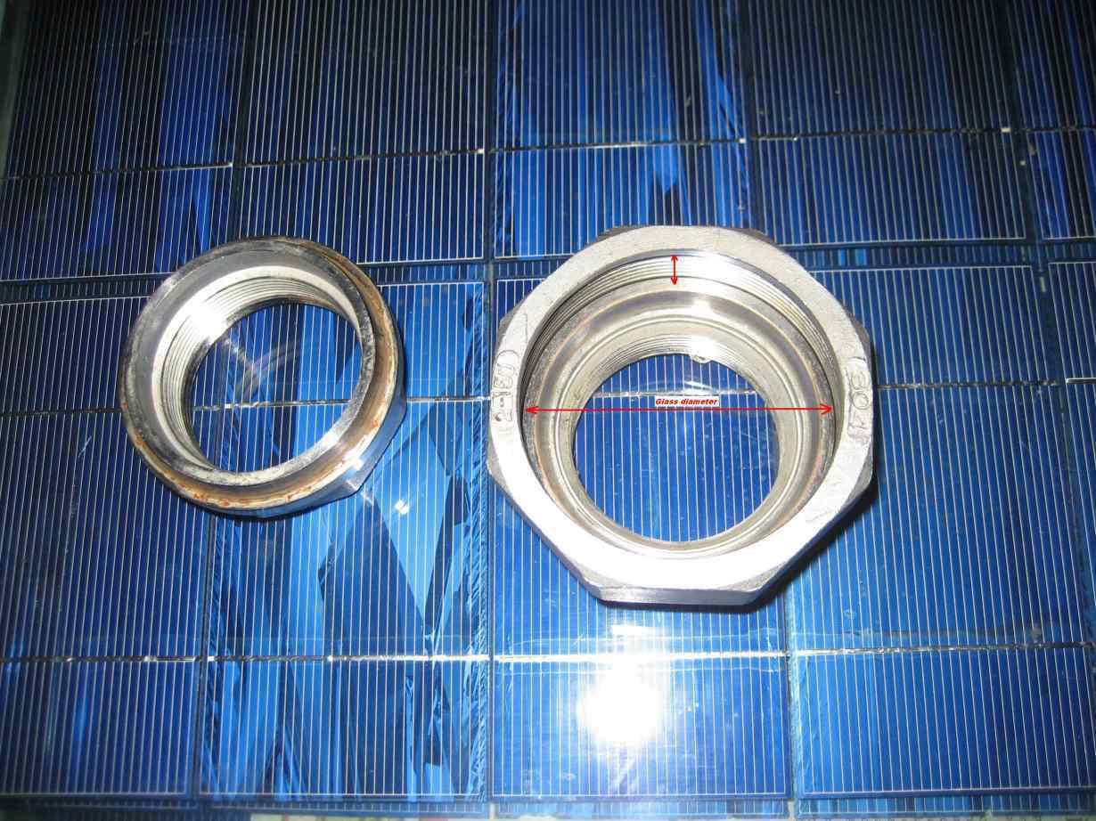

This is a draft of a commercial sight glass:
This is an universal 2" SS joint (the part that will be replaced by 6mm glass is on the left side), do you see what I mean?:
You can make some rounds on the glass edge with cheap teflon tape or use this excellent material:
http://www.chesterton.com/ENU/Products/ ... odelID=185" onclick="window.open(this.href);return false;" rel="nofollow
BTW: That are homemade Solar panels where the fitting is sitting on.

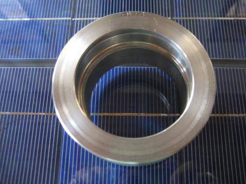

- Posts: 1105
Re: sourcing a sight glass
This is how it's loking after machining it.
Took me two hours including to have a beer with my friend who owns the metal mechanic.
A good mechanik can do it in less than an hour (and better) I guess.
