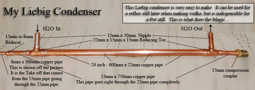

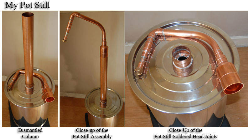

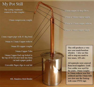

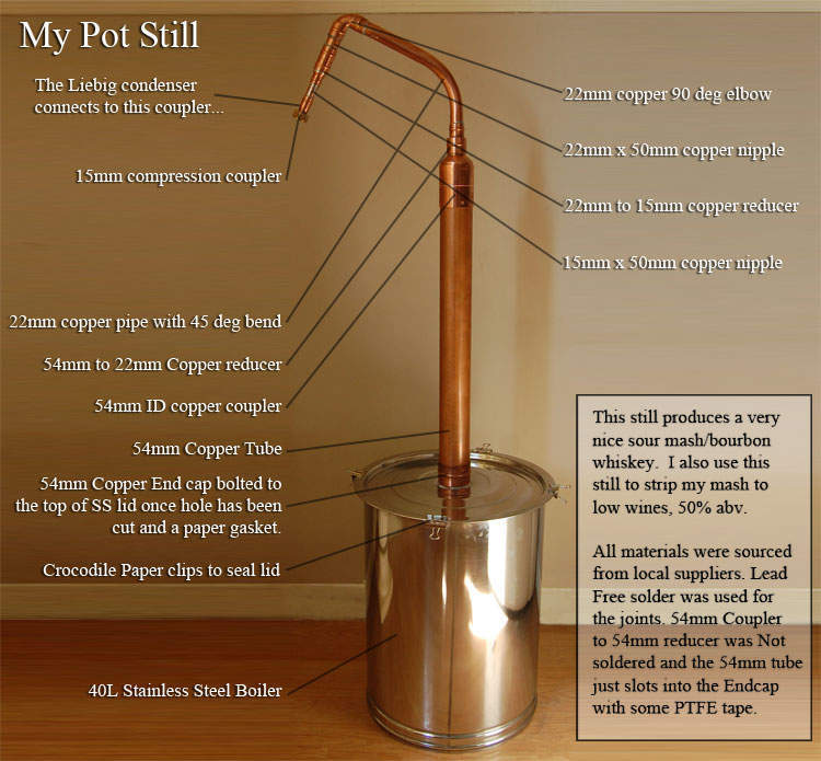

Recently I upgraded my pot still, You need three things: a boiler, a vapour tube and a condenser...
Heres some piccies... Very simple to make and easier than a 5L pot still to operate...
Gives my some nice whiskey/bourbon. It will strip a 30L wash in 2 hours flat with the right heat and coolant applied.
I even made a nice neutral before I built my Boka/VM still. Took the cuts very slowly, but gave me a very good vodka.

♦♦ Samohon ♦♦
- Posts: 3017
Re: Air Still or 5L Pot Still
Damn Samohon, You blow me away with your fancy puter work... very good explanation. You should do the same thing for your bok... That could be very useful to new members... Man that is great.
You are the shit when it comes to photos and labeling...

That pot still looks great. Simple and nice looking and makes good bourbon. What more could a person want? Looks like something that would be perfect for me.

So the lid on the pot is held on by the clips only, and no flour paste or anything? Also, I understand that at the end of the run when you cut the heat, you have to let air in to keep the still from imploding. Which of the joints on this still do you open up for that?
- Posts: 1656
- Joined: Tue Sep 16, 2008 1:25 am
- Location: Planet Erf...near the bottom.
It must be sealed good an proper. The only way for gasses to get out is through the condenser and the condenser must condense all in it's path. Thus the only escape is in liquid form...but if things ain't right then gasses will go through the condenser and find an easy outlet without building any pressure. Imploding is a disaster far less that exploding.
