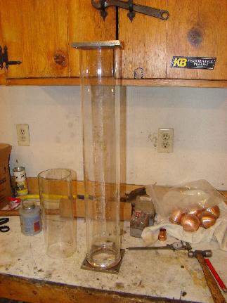

Going way out of the box on this one....Keep ya posted....
- Attachments
- 4" lab pyrex and 3.5" copper spheres....
- glass ponu.JPG (12.59 KiB) Viewed 9344 times

yes, it is flanged lab glass....design is still on the white board....

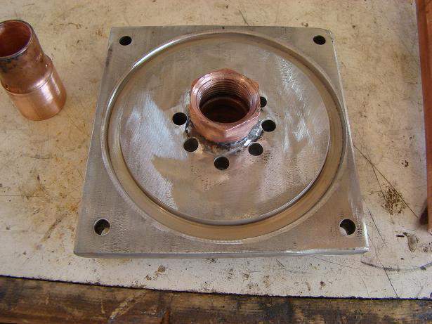

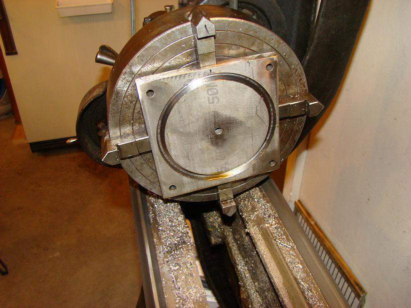

well, tube is cut and the lower tube flanges plates completed...
- Attachments
- lower-upper fp.JPG (14.26 KiB) Viewed 6837 times
- lower fp.JPG (22.45 KiB) Viewed 6837 times

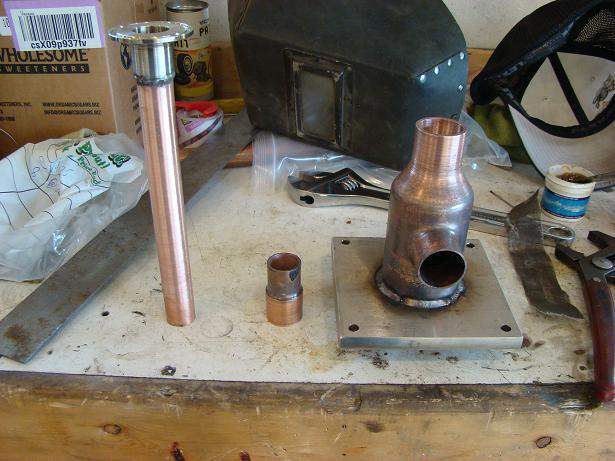

- Location: Big Sky Country
Re: 4" glass column "coil-less" ponu
Well, some more progress, got the heart of the ponu done. The diversion chamber where two things happen, vapor from the steam chamber goes up and the condensed vapor from the condenser falls down into the lower secondary coil....
