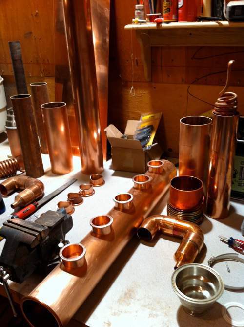

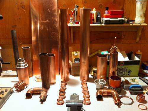

Well I have been lurking around this forum for the last six months and i have just decided to post some pictures of my first build. Thank you everyone for your ideas and inspiration on this creation. I am building two identical 42" five plate columns with a removable 12" dephlagmater that will have a 8" shotgun in it. This column will have a removable "flat top" 2" vapor take-off going to a 3" x 16" Graham condenser. Most of my copper has come from the scrap pile @ $4.00 / lb. USD except for the .125" plate for the caps, tops, and perforated plates. I am going with a removable tree that will slide down into the column to give me as many options as possible in the future. I am trying to stay away from as many fittings as possible to keep the cost reasonable. For the sight glasses I am using 2" pipe with an easy flange and I have ordered 5mm x 63mm heat absorbing glass windows that i will use with 2" tri-clamps. Let me know what you think so far.......
Mock up of the sight glass layout @ 5_1/2" spacing
Getting the parts ready

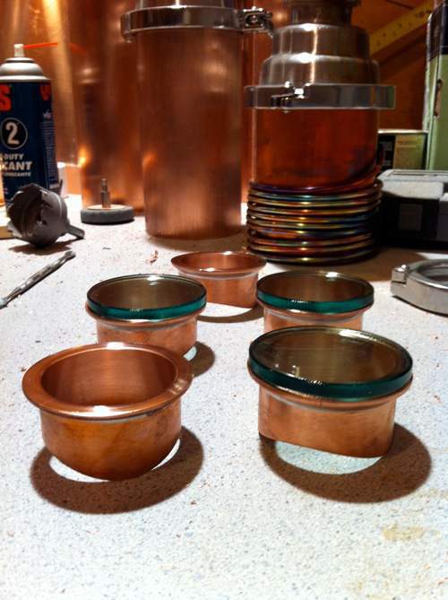

Cutting the bevel in the sight glasses
Making the sight glasses

even the walls are shining :shock: . i like the jig for the sight glasses!!!
spooky
Posts: 13025
Re: Dan's Flute x2, 4" x 5 plate 42" column
Ship shape Dan.
That jig is the WTG.

Progress report.....everyone likes pictures. This is either the "Evil Twin" build or the "Good Brother" build... Haven't decided yet! All ten sight glasses are done and next up is drilling the 2_1/8" holes in the column.
-Dan

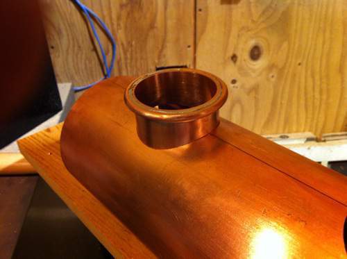

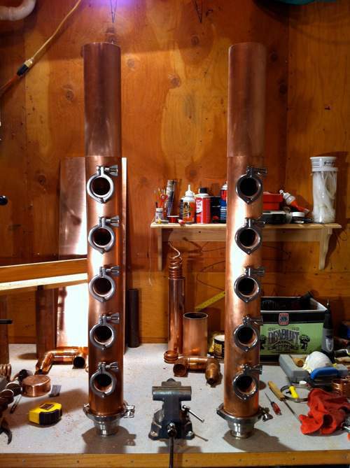

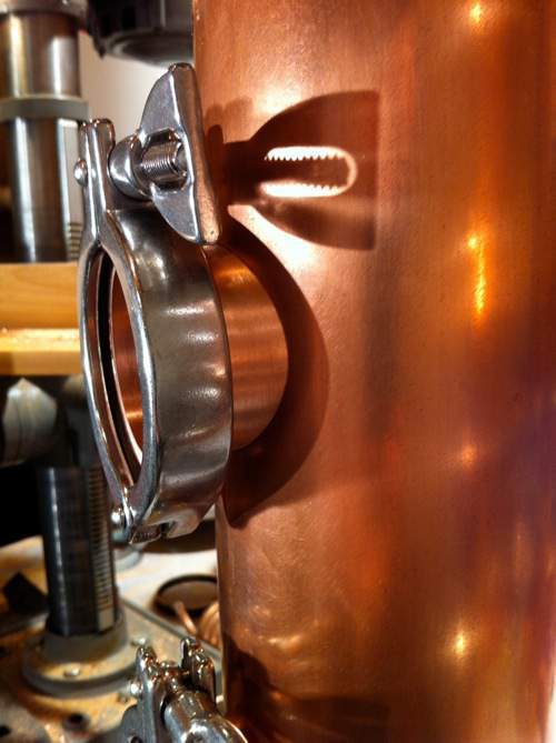

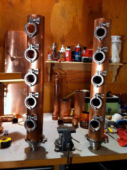

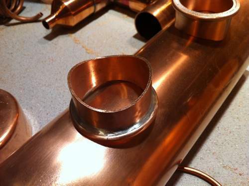

Well another round of fighting with the drill press...... :evil: Here are some pictures of the progress so far. The sight glass windows will be here tomorrow so that I can take the final dimensions on the easy flange + teflon gasket + glass = to determine if I need to adjust the thickness of the easy flange before I solder them on the body of the column. it will be much easier to make this adjustment with another jig one at a time so that they are all identical. then I will solder them all on the column and be done with it. I just want to make sure the tri-clamps have a nice uniform snug fit. Details, details, details......
dan
Posts: 203
Joined: Thu Jan 27, 2011 11:26 am
Location: PNW
Post by dan »

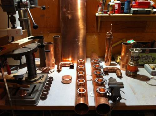

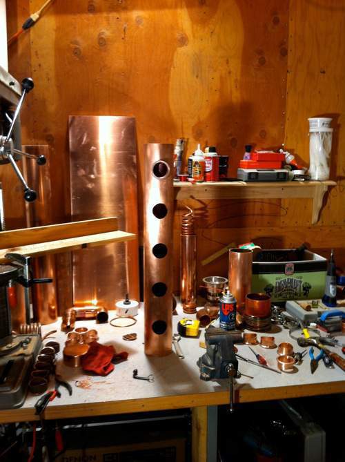

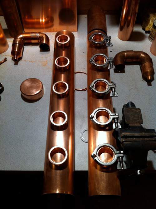

And a few more pictures......

Post by dan »

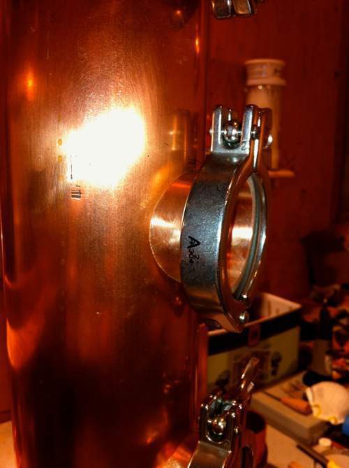

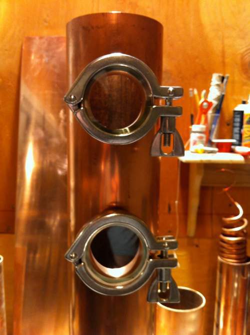

Well I guess the term "easy flange" is just a matter opinion..... You know what they say about opinions ----everyone has one!! My sight glass came in today and instead of being 5mm they were a lot closer to 5.9mm. I had to mill off about 2.5mm of my easy flange to get the tri-clamps to close over the glass and flange. I must say they do look pretty nice now that they are done but what a pain in the butt. tomorrow will be the real test when I solder all of the sight glasses to the column body. Here are a few pictures of today's progress.
-Dan

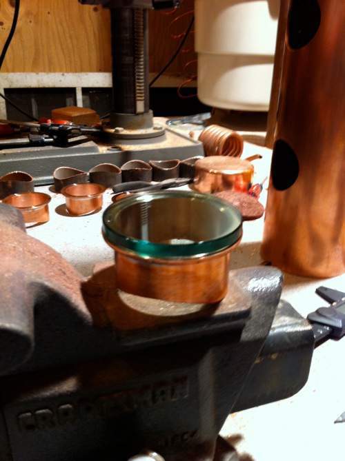

How'd you get em cut?
dan
Posts: 203
Location: PNW
Post by dan »
Manback wrote:How'd you get em cut?
I ordered the glass from Surplus Shed @ http://www.surplusshed.com" onclick="window.open(this.href);return false;" rel="nofollow. They were $2.00 each for "63mm heat absorbing glass window" The easy flange had to be cut down from 5mm thick to 2.5mm and I used the drill press with my 2.125" carbide hole-saw. The sight glass was placed in a jig and placed in a two axis tool rest vice. I ran the bit down to the face of the easy flange and moved the easy flange back and forth until it milled off the amount I wanted to remove. Then I put a twist lock Scotch-Brite pad in the drill press and honed the face of the flange to get it very smooth and flat. I hope that answers your question
-Dan
dan
Posts: 203
Location: PNW
Post by dan »
I ordered the glass from Surplus Shed @ http://www.surplusshed.com" onclick="window.open(this.href);return false;" rel="nofollow. They were $2.00 each for "63mm heat absorbing glass window" The easy flange had to be cut down from 5mm thick to 2.5mm and I used the drill press with my 2.125" carbide hole-saw. The sight glass was placed in a jig and placed in a two axis tool rest vise. I ran the bit down to the face of the easy flange and moved the easy flange back and forth until it milled off the amount I wanted to remove. Then I put a twist lock Scotch-Brite pad in the drill press and honed the face of the flange to get it very smooth and flat. I hope that answers your question
-Dan
The drill press vise is actually called a cross sliding vise not a tool rest and you can get them from Grizzly.com for $45.00.
-Dan

Do your sight glass tubes sit on the column pipe or insert some? I am planning on drilling my column for sight glasses after I hard solder the tubes on because I dont think I will have as nice of fit as you do.
I have a drill press but dont have vise for it or a four inch hole saw so I will have to hand fit each one. Thanks for the info. I may just order one from grizzly.com
I wish I had a four inch cylinder hone used on engine blocks. It would be nice to sweeten up the inside of my pipe after all the heat that is applied.
How much did you have to pay for the tri clamps?
dan
Posts: 203
Location: PNW
Post by dan »
mash rookie wrote:Dan,
Mash Rookie,
My sight glass tubes sit inside the holes I drilled. I bought a 2_1/8" carbide hole saw bit on e-bay for $25.00USD that gave me a very clean hole. The brand is Keego and compared to retail they are very cheap but you get what you pay for. You will make up in time what you lack in tooling or tools. :tired: You can get a cylinder hone from www.harborfreight.com for $24.99 and I am considering the same thing for my column. I bought my tri-clamps from St. Patrick's of Texas - http://stpats.com/index.htm" onclick="window.open(this.href);return false;" rel="nofollow and they were $7.00 each + shipping of around $1.22 each. I hope that helps.....
-Dan

dan wrote: For the sight glasses I am using 2" pipe with an easy flange and I have ordered 5mm x 63mm heat absorbing glass windows that i will use with 2" tri-clamps.
Looks real nice dan -- I like your choice with the sight glass "ferrules". Your build shows a lot of patience and attention. Keep it up.
