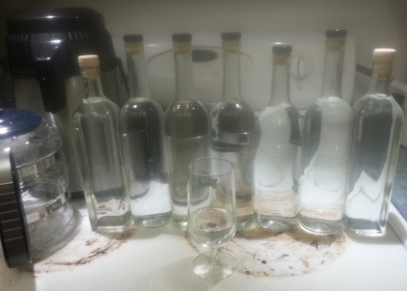

Here is a pic of the gin I made last night (Odin's Easy Gin).
If your gin is cloudy add neutral till it just clears up.
