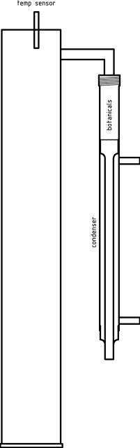

What I am investigating is how different setups affect gin output with the view of constructing a gin still. In the past I had dabbled in using a tea strainer in the column to extract flavour by vapour but I was not entirely successful in producing the nice light juniper flavour (like a Bombay Sapphire or Tanqueray). With time and recipe changes I'm sure i would have got closer but time has moved on and circumstances changed and i like constructing.
So my current plan I am working on is to construct/convert a 50mm stainless steel 600mm column into a gin vapour still. Draw out the vapour from the top of the column and then before the vapour condenses it passes through the botanicals in a downward direction then through the condenser - thus avoiding some of the heavier juniper oils from not coming out. As per following pic...
Gin Still Design
Gin Still Design
I'd also construct the botantical basket and condenser as single unit (made of copper) that would screw onto the vapour faucet. A circular piece of copper mesh would stop the botanicals from falling through.

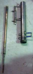

Thank you Odin and Prairiepiss - following are pics:
New condenser with old redundant column
So this is the redundant column - the condenser was far too small and the reflux pipes at the bottom should have been at the top. Happy to see the stainless being used. The copper condenser has the gin receptacle at the top. When complete the whole condenser is unscrewed from the column and botanicals can then be added at the top.

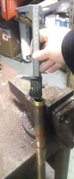

Botanical receptacle
The size of the botanical receptacle is 200mm deep by 27mm inner diameter. I am hoping that the stripping performance is good even though the vapour path is narrower.

alyeomans; your drawing shows the botanicals basket filling the vapor path. there is a potential your botanicals could plug the vapor path and create a pressure hazard if there is not a clear and unobstructed vapor path.

Cob has a good point. My basket has about a 1/4" spacing between it and its housing. I will have some larger holes around the top of the basket. That will low vapors to go around the botanicals. In case they get to saturated and compacted. It may reduce the amount of vapor that is made to go through them. But I was thinking more about safety then anything else.
So a vapor bypass of some sort would be a must. Just in case.

Excellent point, safety first! I am thinking a bypass tube through the mesh to above the botanical fill level work? The tube would also act as a self centreing mechanism for the mesh.
I think I'll also add a pressure value that was it will also act as an indicator of a blockage.

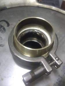

I am not particularly happy with this as the basket surface area is now quite small but it will not blow due to the bypass tube.
So providing this now fits enough botanicals it should work 'just' like a new one.

Won't the vapor take the path of least resistance and just flow through the bypass tube and not through your botanicals? Or am I missing something?

Quite so Braz, but the risk of blockage is high and I do not want it to blow up or have to fix a blockage when it is running. What is needed is a method of getting in the vapour path but not blocking it. Any ideas?

I run this simple gin basket. It fits into my pot still head and the rising steam goes through it and the botanicals with no problem. I do insulate the column because unintended reflux can cause flooding in the basket (acting like a sieve plate) and I don't want that.
My method is to run the cleanest neutral I can get in my reflux still, make the cuts, and then dilute to 30%. Rerun this in the pot with the gin head and keep pretty much everything. I keep the botanicals loose in the basket, not packed in obviously. I collect in pint (400ml) jars and blend later. It seems some of the flavors come over earlier in the run and some later in the run so with the small jars I can somewhat blend to taste.

Looks nice Braz. Also thank you for the running tips. In my plan as I am trying to get the goodness from the botanicals in a downward direction, the botanicals act as a one way valve - it is like a piece of plastic blocking a drain.
So to safely use the vapours they must pass up through the botanicals and so it seems that sticking with the basket in column is a pretty good idea rather than messing around with bypasses and pressure release valves.
Ow well, the column can still fit the basket so not all is lost.
