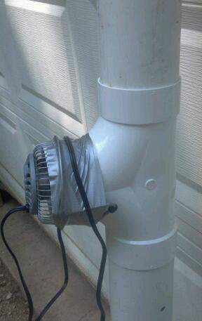

OK made my first run using my new "swamp cooler". It works,... not a complete solution but it does help tremendously. After 2.5 hrs of running and the ambient temp here today is about 95 degrees f. I think I can safely say that it does work. I'm in-between jars so I'll post about it.
I baught a cheep little 4"fan from Walmart.
Baught a 10' stick of 4"PVC, and a cleanout T.
And I had some aluminum window screen.
I put the 10'pipe down into my 45 gal water reservoir, marked the pipe at the top of container, cut it off there. Slid the T onto the bottom section. Drilled several holes in the bottom section for water dispersion.
Took the face shroud off the front of the fan, inserted into the T, and duck taped the hell outta it. Inserted the top section into the top of the T, measured and cutoff just a little lower than the height of my column. Drilled two holes into the top of the top section to insert the return lines. Packed the top section of the cooler with the aluminum window screen.
After 2.5 hours of running, in 95 degree ambient temp, the product is cool to the touch!!!

Max temp of the reservoir after 3 hours of running is 100 degrees f. And its 95 degrees ambient temp....

So your pumping resivior water though a condeser then sending hot water to the top? letting it flow down , is fan pushing in or pulling out ?

vinper wrote:So your pumping resivior water though a condeser then sending hot water to the top? letting it flow down , is fan pushing in or pulling out ?
No,... the hot water coming back from my tower and my product condenser goes to the top of the water cooler, falls down through the window screen packing. The fan blows up through the dropping water. When I place my hand on top of the cooler it is blowing warm air...

Frosteecat wrote:Man...the more I look at that the more I like it...working on something similar, smaller scale though...how can it be scaled down>
Frost, not sure I would want to scale it down. I run a PSII high cap and a 15.5 keg. It definitely works for my setup but at these ambient temps I think I'm at the upper limit of what it can do. If you have a smaller setup than mine, something about this scale would work great...

mash rookie wrote:That is what we do here. Share, Improve, Inspire and be inspired. It is the wonderful advantage of a forum format. Some of the best improvements are from someone looking at problem just a little differently than others. Your cooler is better than you think. I think it will become the norm for guys using recycled cooling water. Once again, congratulations.
Ps. When pressed for a drawing, explain that the tee has to face down to keep water out and the pipe sets in water to keep air going up.
Your exactly right MR, a regular T has a single sweep to one side, if a regular T was to be used the sweep would need to sweep down so that the water wouldn't pool. I used what was labeled as a clean out T, it has a sweep going in both directions. I thought that the sweep going up might help to send the airflow in the right direction, while the other sweep going down would prevent any pooling.
And yes, the bottom definatly has to be in the water so that the airflow is directed up through the falling heated water from the still.
I had a 6.5 hour run with it. The water temp increased by almost 20 degrees, but.... the ambient air temp(reached 96 yesterday!!) increased by more than that. My product temp remained cool to the touch when in the past, I've had problems with it... I'm happy. With ita and I hope it can help someone else....

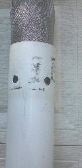

Hello Wacabi, I had a quick question, when you put the window screen inside the tube, did you just leave it on the roll rolled up? Or you reckon packing it in there would be better? Just wondering. I'm a big fan of that little invention. Next time when my wife gives me a PO to go to the home depot. I'm sure I can sneak this one in :thumbup: I'm sure the married guys know how that one works :sarcasm:

whiskeytripping wrote:That is BEAUTIFUL wacabi, good job, I'm gonna have to make me one of those. Thanks for that little idea. Do you run a BOK? That's where I run into some serious cooling issues, the pot still don't have issues, but damn sure could use some help. Those little fountain pumps aren't really rated for that hot of water anyways. Thank's buddy for the idea :thumbup:
Thanks, though I wouldn't exactly call it "beautiful" but it works!!! And I'm a practical kind a feller...
I run a PSII high cap 3" withpot a 15.5 keg. Sometimes a spirit run can take me 6hrs!!! That's a lotta heated water. I initially had a 40?gal trash can, then I switched to a 50gal drum. The swamp cooler works great, its cheap, and easy to build. I scrunched up the aluminum window screen in the center of the role then left the outer edge of the role flat/normal?... I was thinking that the twists and turns in the center would break up the droplets better, while maybe leaving the outside of the role smooth might fit better against the walls of the pipe and might help peal some of the water off the wall instead of running straight down... hope this helps ya...

Hello Wacabi, just gonna let you you know I finally got mine built, I kinda screwed up though cause I bought a regular "T" for it and glued it in with the sweep facing up, it had been awhile since I read this thread I guess I should have re-read it before I went to Home Depot. SO, now I have the water pooling up problem, I'm going to try to fix something in there though to help it not pool up. I'm going to try building it up a little with silicone, on the top where it cascades down, and on bottom :shifty:
I might just need to go and buy a clean out "T" and call it a loss. :mrgreen:

Hey man, glad to hear yer on yer way with the cooler. Sometimes we overlook the obvious, but in an effort to help... can't ya turn the whole thing upside down??? Think about this, the bottom, the part that goes down into your tank, is really only for stability. It would still cool without the bottom section, the trick would be getting it stabilized.
Another option might be to take a sawzall (with a long blade), and cutting a drainage grove where yer water is pooling.

I already made some holes on the barrel side, but you might be in to something cutting it with the sawzall :thumbup: either ways I know this is gonna be a winner, thanks bud :sarcasm:

I drilled lots of holes in the barrel side so that water would freely move through the newly heated water that fell down through the pipe. If the inlet holes coming from your tower are the only thing keeping you from turning it upside down, hell, yer gonna need lots of holes in the pipe down in the tank anywayz.... I'm sure I must not be understanding whats wrong with turning it upside down so that the swoop drains down. Typing isn't as good as a pic.
