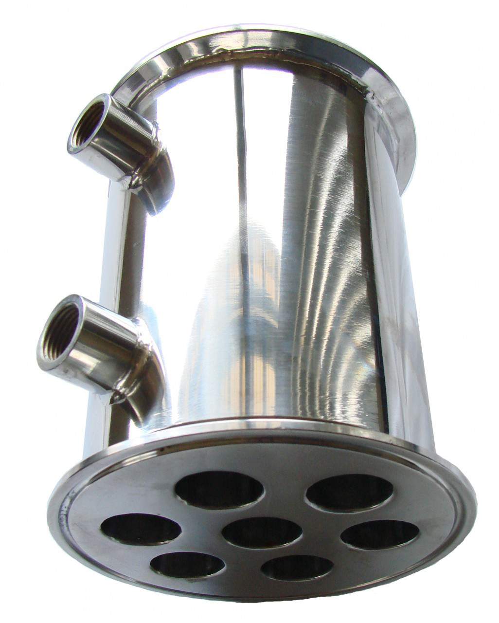

Here is probably the more typical design that people build or buy: The difference between a dephlegmater and a shotgun condenser is location and length. A dephlegmater is located on a CM still at the top of the column, is usually shorter than the shotgun condenser and is used to reflux vapor.
Let’s look at the most common one pictured above, its advantages and disadvantages.
Advantages:
It’s modular and can be removed easily from the still with the tri-clamp connectors.
Easy to clean
Allows more flexibility in the alteration of the still
Disadvantages:
Cost as you have two ferrules and two tri-clamps to keep it together.

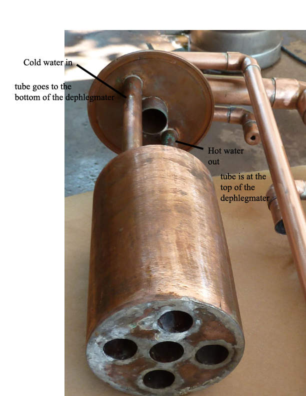

Now let’s look at my dephlegmater: I did not design mine (it was Mash Rookies design) but we built it together. My design rather than fit on top of a column, drops into the column. We took a 4” diameter pipe 6” long and cut it length wise (taking out a small section). We then pulled it together and soldered it making it just small enough that it would fit into the 4” column. Thus my opening statement about having 5 holes but actually I have more than that for the vapor to rise as it can rise outside the dephlegmater between the dephlegmater and the column yet when in full reflux nothing escapes through the tubes or outside as there is enough coolant.
Note in the picture above the water entering the dephlegmater is forced to the bottom and then rises to the top as the pipe goes all the way down and ends about a 1/2" from the bottom, the hot water leaving is at the top of the dephlegmater.
The picture below shows the 3 parts I milled for this. The first circled part is the bottom of the dephlegmater and the middle one is the top. Note that the top has 2 more holes 1/2" instead of 3/4" for the water lines to enter and leave. The third part sits a ways above the dephlegmater and is soldered to both water pipes, which allows me to slip the dephlegmater into the column. This also was measured to match a 4" ferrule to attach to the column by tri-clamp. I also added a small grove that would allow for the gasket to fit properly on both the ferrule and my part. This would not be necessary as you could cut that raised part off like most do for fitting their 2" to a sanke keg when attaching their column. Advantages:
Cheaper as I did not need to purchase ferrules and it is attached with only one tri-clamp
slides out easily for cleaning
Advantages:
Easy to clean
Disadvantages:

By restricting the outlet, you don't need to mess with the drain, it always stays full.
That said, if you have a shotgun/tube and case style condenser, depending on your plumbing, you can run the risk of the condenser draining if it is restricted on the inlet, particularly if your inlet is at the top and the drain runs down from there.
Simply raising the height of the drain above the inlet will fix that.

Re: Let's discuss the dephlegmater
That's a good point empty, a valve on the output side will hold the coolent to be warmed. I run mine with a valve on the input side, my feed lines are above any of my input output lines, gravity plays a.big part in holding coolent water down. I have it so, it feeds onto the base of the deflag, out the top onto the PC outlet, the PC outlet combined with RV outlet plus gravity holds it at how I want it.
Well said, look at my picture, the restricter is on the outlet and the outlet is above the condenser. The reflux condenser needs to be full in order for the CM to fully work properly as stated above!emptyglass wrote:Dosnt really mater how you restrict the flow. Your not really restricting it, more controlling it.
